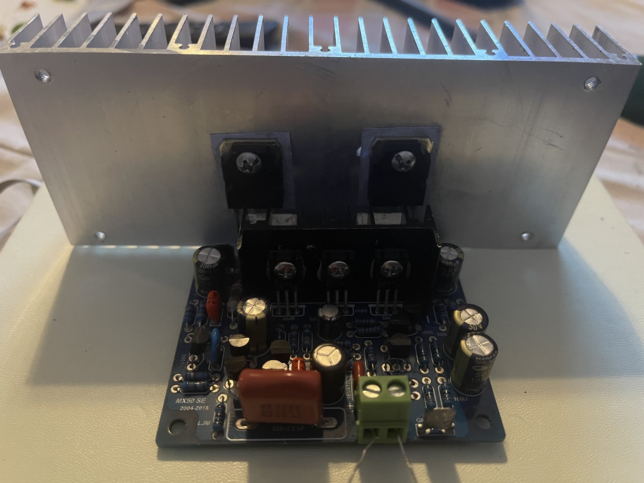

Is this a big enough heat sink for 100w? The dimensions are 6”x2.5”x1” or in mm it’s
150mm x 60mm x 25mm .
That should be OK for normal volume levels but it isn't very large in the scheme of things. If it gets to hot to comfortably hold your hand or fingers on (like a hot radiator) then you need larger. With no signal it should stay quite cool.

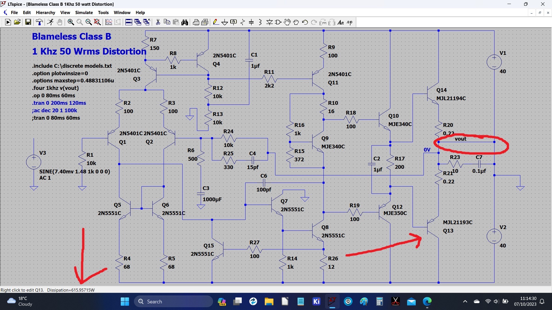

If there is no signal and if the DC offset is low then I think it all comes down to how low the output impedance of the amp is at the terminals. If there is a series output inductor and/or a series low value resistor then that should save it from disaster.
Without any significant resistance the amp sees not only a short but also a collapse of the feedback loop which would then most likely turn on the output stage harder and with it working into a short the transistor fail.
A transistor junction can fail 100's or 1000's of times faster than a normal fuse.
Not all amps, many do have electronic protection to monitor the current (in those low value white 'emitter' resistors).
Commercial amps usually have some of these safeguards, diy ones not always.
If yours is like the one in post #13 then it has no protection and also no series output inductor (which can add enough series resistance to stop this happening)
The crucial part is to have a little series resistance from the output of the amp to the speaker sockets. An inductor can do that and tbh most amps include one for stability.
The 0.1 ohm resistors in your circuit are not in series with the output... its a subtle difference.

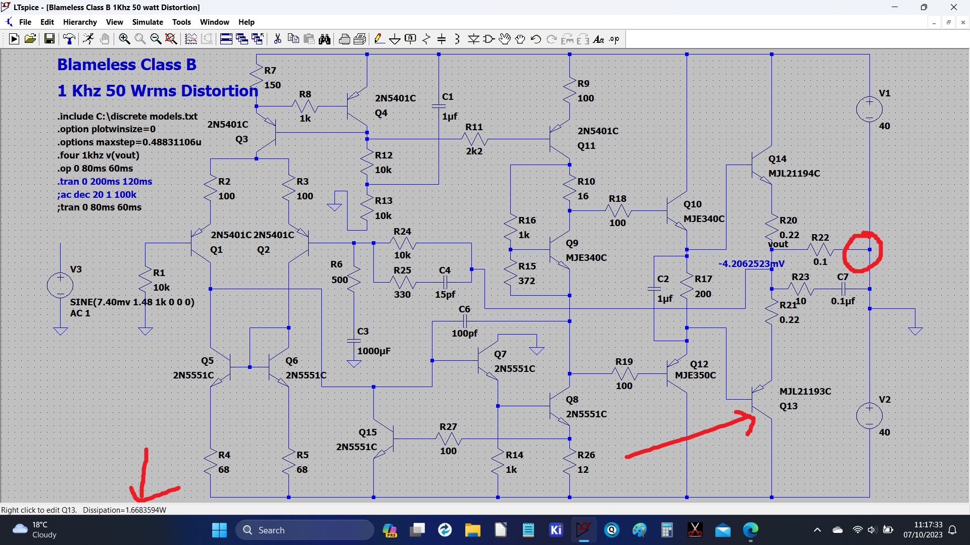

Look at this output stage. The speaker terminal is shorted and the dissipation in the output transistor is well over 600 watts.
Now we add a low value resistor at the output and then apply a short. The amp can maintain the main output at what is the normal DC offset of the amp and the 0.1 ohm does not remove the feedback. The output stage operates normally and in fact 40ma bias current is flowing normally. The same transistor is just dissipating 1.6 watts. All good in this state.
If any signal was present the amp would try and drive that signal into the 0.1 ohm and that would draw excess current. That is where electronic protection would come into play and also rail fuses if fitted.
Wouldn’t that 22ohm resistor affect the impedance of the speaker? You would be basically attenuating the output volume !
Also the 100pf caps I orderd arrived today but they all measure 116pf is that fine or will I run into trouble ?
All the R's are just component designators. There is no 22 ohm 🙂
R20 and R21 are 0.22 ohm and the normal 'emitter' resistors seen in most amps.
R22 is the load (speaker if you like) and with it set even as low s 0.1 ohm the amp will set all the DC conditions correctly.
