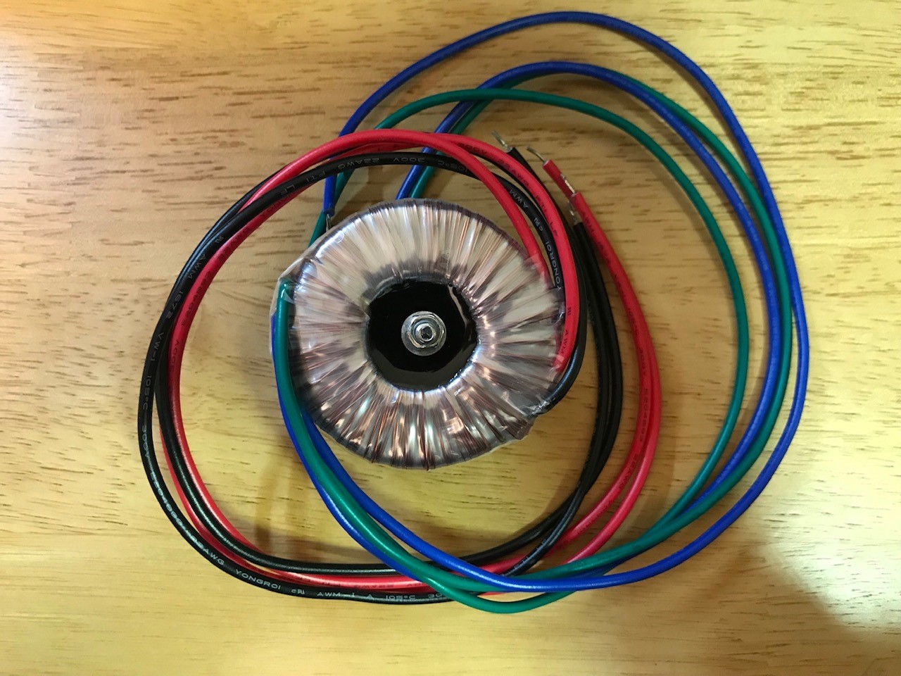

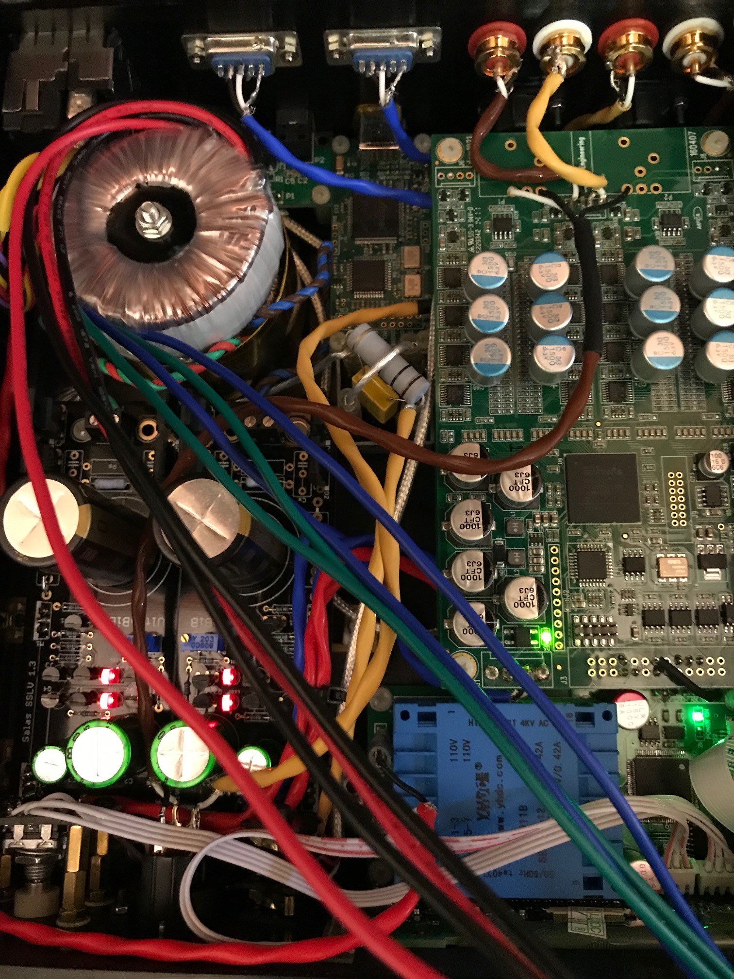

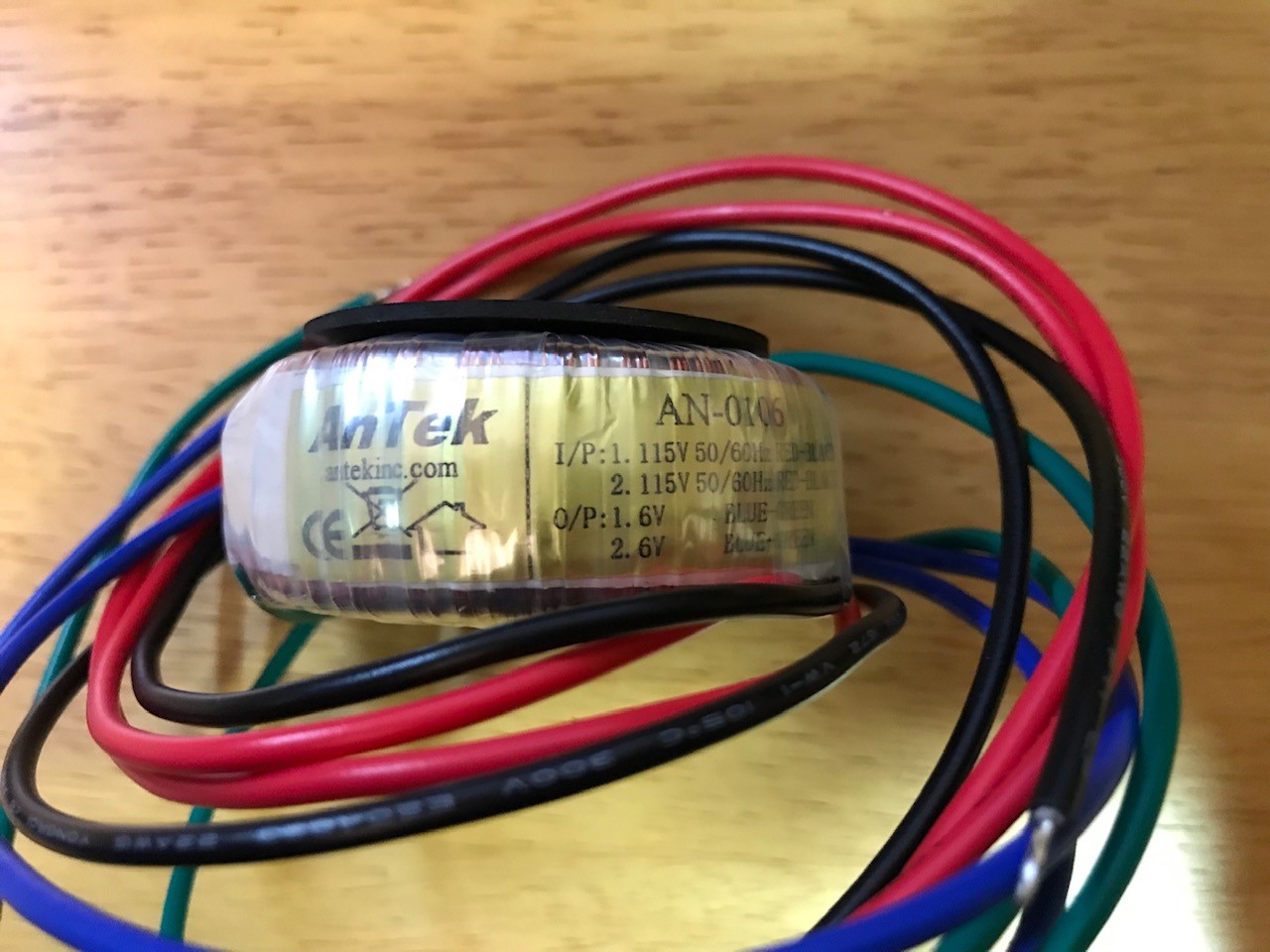

Due to weather delays and sorting issues I won't get the EMU0404 until tomorrow... But I did receive the AnTek 10VA 2*6V toroidal transformer and it looks great. Longest diameter is still a couple of millimeter shorter than spec which makes for a perfect fit. The secondary wire leads are also surprisingly long so it saves the need for extension wires! It comes with a rubber pad and fits perfectly on top of the other toroidal. Only minor issue is that they seem to have placed the label upside down. As it is I would still wholeheartedly recommend it to anyone using the SK Lite kit as a low EMI xfmr replacement. With its size almost equaling the Talema 25VA, I'm sure that temperatures will be great too, certainly better than the 6VA UI laminate type that's speced at 110V.
Will have to trim the primary leads though; it's about 20cm too long right now.
