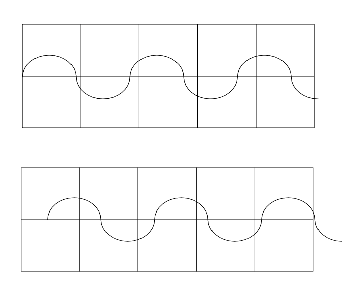

You say that the lower situation cant be resolved by 16/44 PCM. That the at around 21 khz, a sine wave would queue up for the next sample or die.
Right... (and thats only a phase alteration quarter a period...)
I'm saying that at these extremes you are relying way too much on your reconstruction filter for my liking and for any decent scientific experiment.

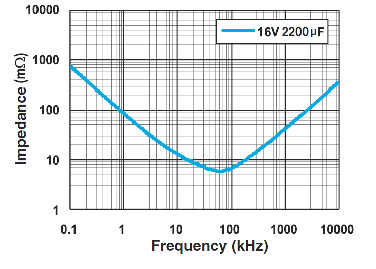

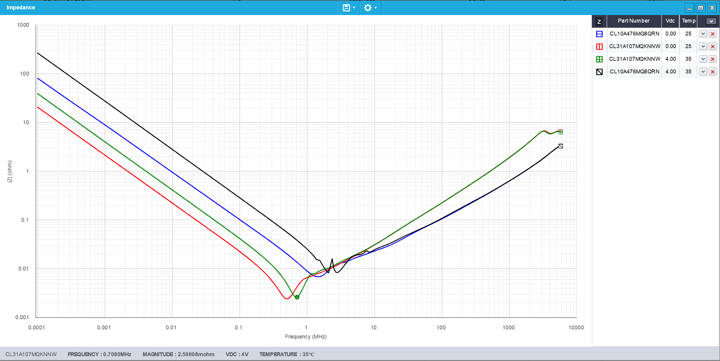

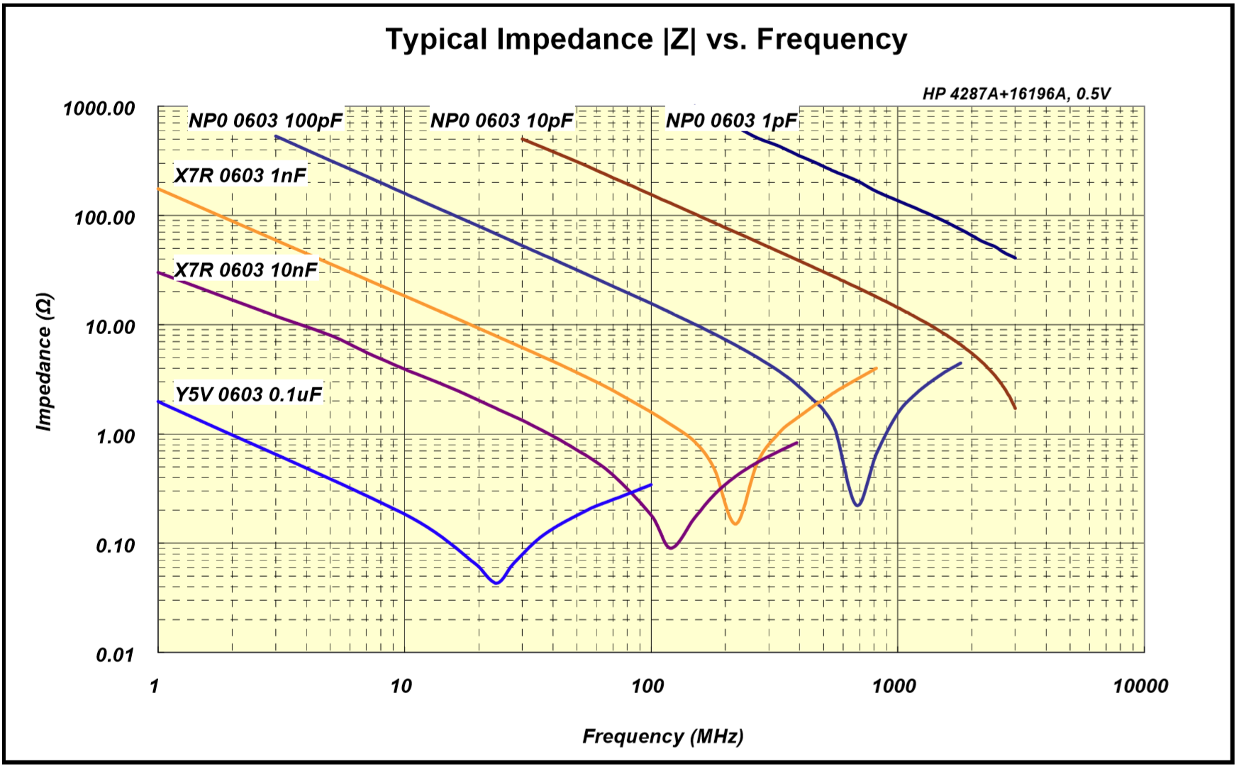

Btw, here're the impedance graphs of Samsung 100uF/47uF ceramics and Nichicon polymer caps. Seems that adding large polymer caps with their lowest impedance at lower frequencies is best if getting a flatter impedance over all frequency is the goal. Smaller polymers seem to have slightly higher self-resonance frequencies, but still around 0.1Mhz. However, this factoid is meaningless if we can't resolve the bigger questions.
