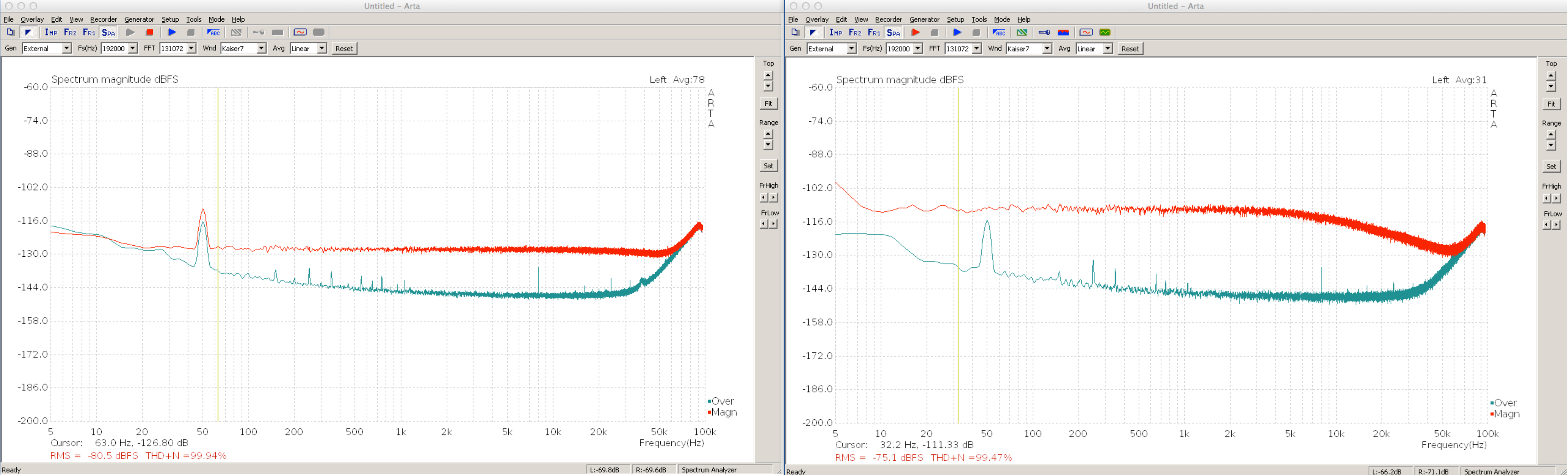

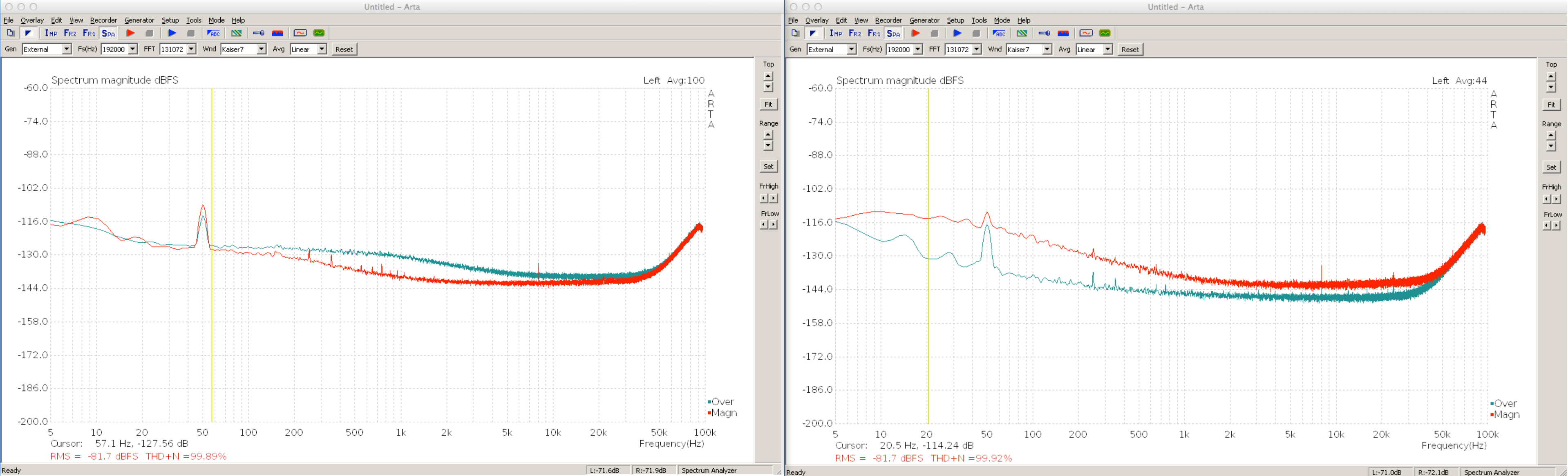

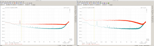

A repost from zfe: the red traces are the ripples in dbfs. The first is 0.1R vs 1R with no/minimal capacitance (factory config in rev2+) load resistor, the second is 0.1R vs 1R with 6800uF.
I don't know why Paul ended up saying that his low res mod (0.01R?) doesn't sound good, but it seems 0.1R is at least much much better than factory 1R in all aspects.
The results align perfectly with Paul's simulations. The simulations predicted that with large capacitance, e.g. 6800uF, replacing 1R with 0.01R would reduce the low end ripple by a very large amount and bring it much closer to the rest of the spectrum. He even tried 0.008R which yielded even better results. I would guess that 0.1R in this case still isn't as good as 0.01R with large capacitance, though maybe more stable with no capacitance?
But what matters is if we can actually hear the difference and if so what it translates into. It's hard to even speculate if we don't have that data. TNT, if you still think that Soren isn't staying out of this because he believes none of it matters in listening, maybe you should share your insights with us.

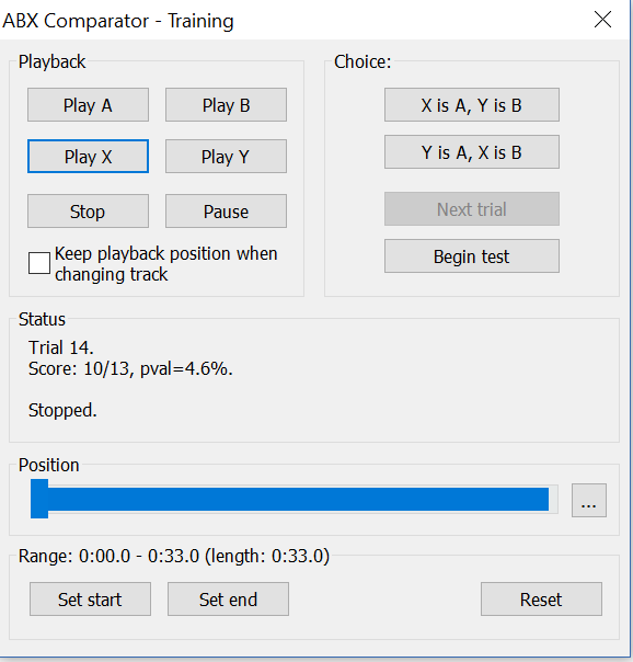

Zfe, would you be willing to procure some 0.01R 0603 resistors and repeat the measurements for it with large capacitance? If you read Paul’s blog, which I’m almost certain you have, his simulations suggest 0.01R should be best absent 0.008R which may be impossible to get...
Also, have you heard any differences? Did you have a chance to record the outputs? I think lots of us (minus our volatile TNT, I won’t ever even try speak for him again..) would be interested in contributing to ABX tests and report subjective findings, if any. The tough part is having someone who can mod relatively easily and have good recording equipment....
Again, I think this is still uncharted territory since we’ve had zero ABX result so far. The methodology isn’t perfect but I think if we are to try anything, it’s probably worth a shot. Soekris is great and pretty much perfect from the audio engineering perspective given what we currently know, except for the dual-mono issue sadly. I’m very happy with a dual-mono 0.012% dam1021 and 5000uF per vref rail. Can certainly go without any more improvements, but I find our little explorations pretty interesting.

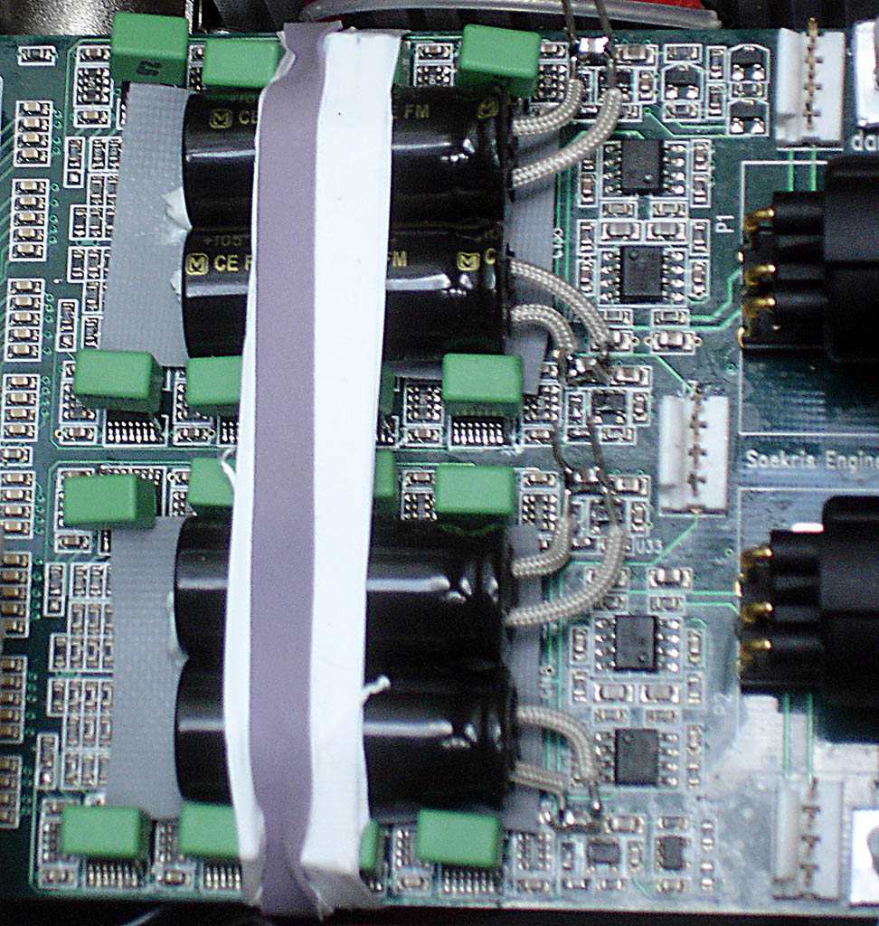

First the picture of the modded part.
As most of the vias are covered by the "green paint" at my DAM, I had not the connet-form-below-option, I soldered the capacitors (16V 2700uF Panasonic FM) directly to the main buffer cap. And as my case is not high enough, I had to lay them flat.
The green caps are 360pF WIMA FKP2 soldered directly to the GND and Vcc pins of the shift registers. This was for the 250MHz oscillations (weather they were now in the DAM or oscillations in my oscilloscope), surely they not harm (but the physical connection is a bit fragile ... possibly I will end to remove them again in the future).
So to the sound. I have to admit, that I have not listened to my other modifications a) as I had not always enough parts lying around to modify all rails. b) I was very tight in time and only did the full modification for the most promising version. So I compare only with the unmodified DAM.
I currently only can listen with my headphone (an "vintage" Stax Lambda Pro + SRM1 Mk2). First observation is, with high sample rate recordings, the unmodded DAM and this headphone I sooner or later got some kind of headache. With the modded version this seems to be gone! I suspect that either that 39kHz noise hump either caused distortions it the head phone amp or this high frequency junk in the signal wereas transmitted to well to the ear and although inaudible caused some pain. So good point 🙂
The sound has definitely changed very noticeably!!
I hear more details, the sound is even more than before only "there" (in the sense that you don't think it comes from the headphones).
An prominent example is the bass section where in some piece I suddenly hear a very deep drum in the background with clear modulations of its vibrations (before this was more some unarticulated noise). Moreover, with enough volume up, I felt the bass part in the body as never with the headphone before... more like with speakers.
Impulses of piano or guitar snares have more attack and are more well defined impulses, again not covering details.
This changed the sound of this setup that much, that I have to listen a lot more to see if I get "used" to that. I can not say that the tonal balance got wrong. Definitely there are "improvements". But I am not yet decided If I just have not heard the "truth" before or if the effects are overemphasizing at some point and there is now to much of ... many things.
I encourage the people here with more analytic or professional ears to give this mod a try. I would be glad to hear other opinions.
Especially in comparison to the other mods.

about 4uV (-128dbfs relative to -7.5dbfs 4v) ripple
The measurements (e.g. the -128dBFS) are in the frequency domain. Ripple is something in the time domain.
To get the RMS value of the ripple you need to sum the bins of the frequency domain in the range of interest. The RMS value displayed in the lower left corner is the sum over all bins (RMS of the "ripple" over full measurement bandwidth).
For the pp-ripple you need to do the inverse Fourier transform and look at Min/Max, or do the measurement again and display it in time domain (scope-mode).
Based on the RMS it seems 0.1R and 1R are more or less the same. But it does seem that lower frequencies benefit, even if they don’t contribute enough to RMS. And at least -80dbfs confirms the internal resistance of shift registers. Idk how to actually interpret your results now 🙂

I got curious again and was finally able to make out the difference between B and C files on this jitter page: jitter_1. The archived version shows that C has 300ps 300hz jitter compared to the reference B: jitter_2results. I do worry that the site might have hidden agendas and as a result may not be trustworthy. But it's a good test.
The difference is pretty minute. The jitter file at 2.0s with perhaps the F# note is noticeably muddier/smoother than the reference file. The reference file has more texture while the jitter-injected file just kind of smooths the edges of the pluck. (Guess MSB was full of s*** when they say jitter=harshness)
I guess this shows to some extent that maybe 1021 isn't as good as it can get. But I don't believe that the differences can be heard without good ABX setup. On the more interesting side, as I was going through the test over and over, my hearing was significantly habituated to the sound to the extent that I can no longer tell the difference. A short break brought back the sensitivities in my hearing. This phenomenon itself is well-documented in scientific literature, but what's interesting is that after habituation, the sounds seem to have lost their texture, leaving behind only the pitch which matched perfectly between the two files. It reminded me that I was taught in middle school that the three properties of sound are pitch, timbre and loudness. If timbre can be separated from pitch, what can THD, IMD, J-test, etc. tell us about proper timbre reproduction? We don't listen to square waves either, so I can't see that much value in square wave impulse measurements. Is this obvious to everyone else or am I just wrong?
