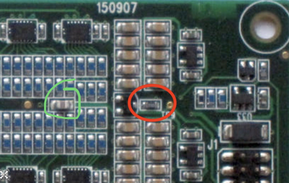

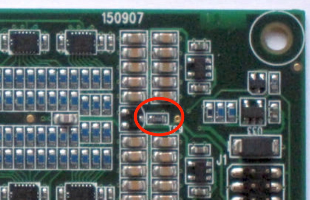

Where are these on the board? Picture. Cxx?
I have been struck by a sudden urge to modify. Da*n you ynmichael ;-)
Thanks!
The thing is, that some here call them output Cs but. They are not. They make a RC filter and an output capacitor (we’ll bite me if I’m wrong) is in the signal - you would have no sound if you’d remove it.
As I have a tube buffer connected to the dam which already has a low pass Filter cause of grid resistor and tube capacitance - I don’t need one more filter on the board.
As Jogi showed me, it’s the left ones circled on the picture. Similar position to the ones on 1021.
But. I haven’t done it, and I don’t know if someone has. It would be advisable to get a confirmation from Soeren that it is the one and it is no problem to remove.
(If he’d answer my question about how to wire the 4 dams from my earlier question Id be also very pleased

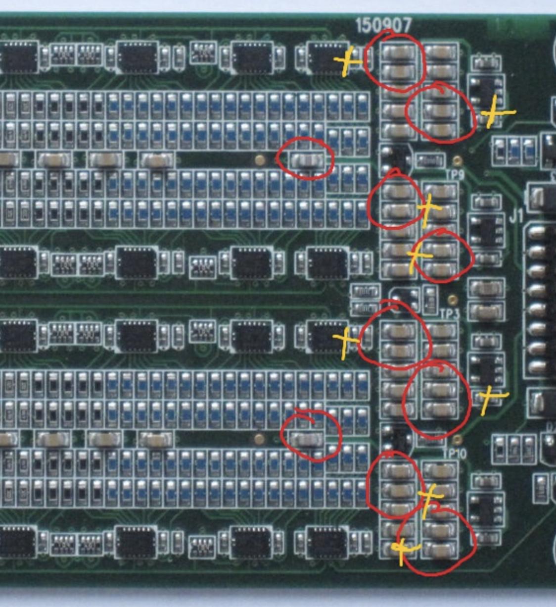

So on 1121 it would be -> ?
I would say it’s these ones on the left in green now.
But please get someone to confirm!
Good - just checking
I'm sure it will be an enjoyable concert.
Yes, it's the ones between the msb resistors marked with a green circle, the one marked with red is a resistor.... Std is 1500 pF NP0 ceramics, they should have minimum impact on the sound, but several people here can hear everything as long as it's not done in a ABX test
I should add that on latest dam1121 rev2 the capacitors have been moved to next to those resistors....
Thanks Sören!
