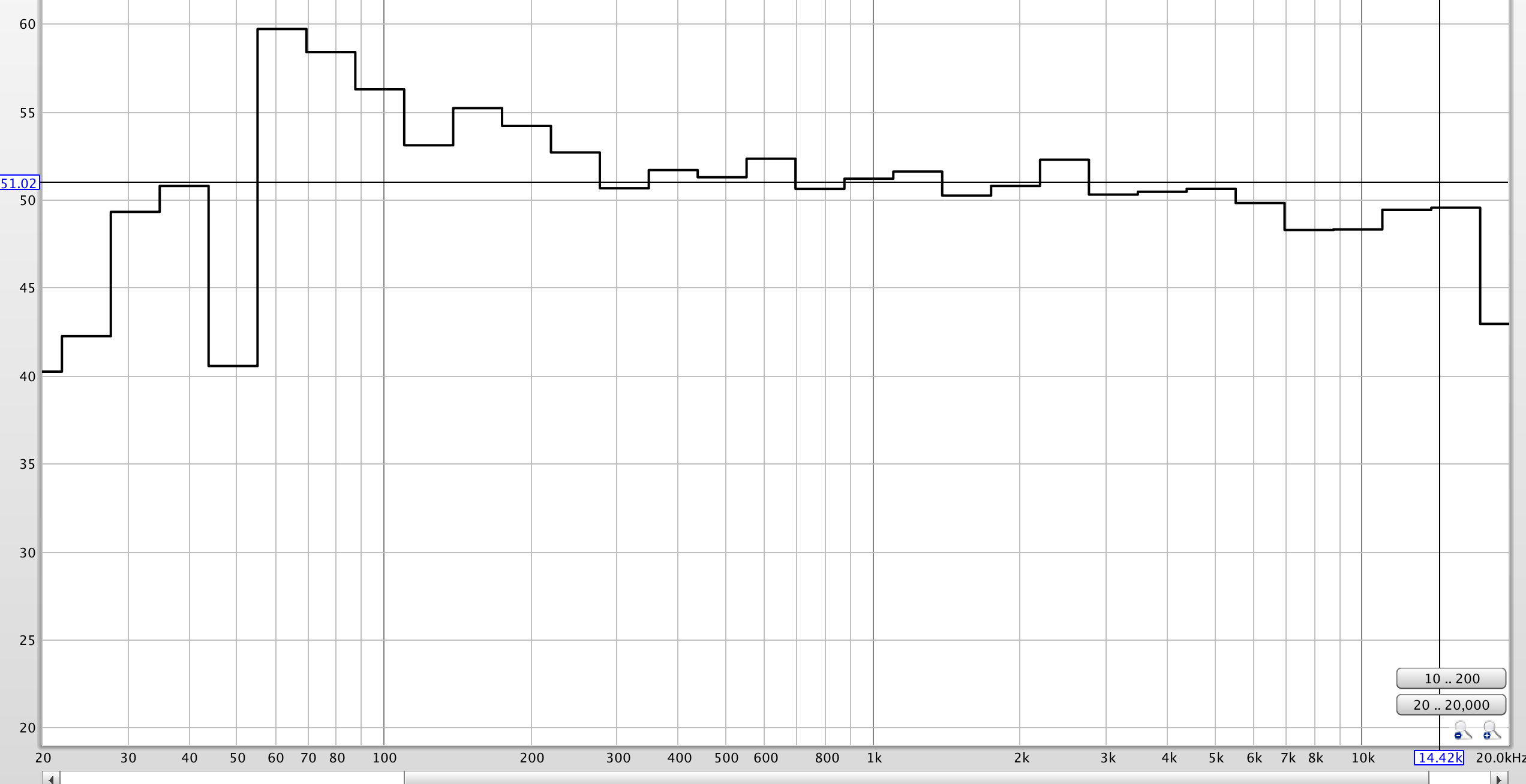

This is my system FR in my sofa using PN and a calibrated ECM6000. Still working on it.
Response looks quite good. Have you done waterfalls and step response measurements?
I'm not convinced static frequency response is all that important and consider dynamic behaviour as more consequential. Got rid of all ported speakers a long time ago for this reason.
But big mains in a living room are a lot more forgiving than studio nearfields. You hear more of the flaws than the music. ;-)
Yet it works fine for others. Have it running problem free on at least 3 machines.

Mine was made by pointing the mic to a point between the speakers, moving it quite slowly in a circle while playing pink noise using REW RTA with 4 averages.
