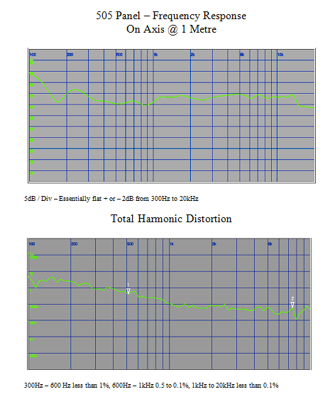

The idea behind Lynn Olsons' the Ariel speaker was to get Quad ESL like midrange with greater dynamics.Has anyone heard a dynamic midrange driver that can rival a competent ESL for midrange clarity and timbre for voice or acoustic instruments?
ESL can do 150-6000Hz with no crossover and low distortion for mid-range pleasure. Do any dynamic drivers meet those basic parameters for midrange integrity?
Modest size ESL mid-range panels for a two or three way DIY speaker are available e.g:
http://www.eraudio.com.au/505_Mini_Panels/505_mini_panels.html
505 Mini Panel specifications
Dimensions 505 x 150 x 5 (H x W x D in millimetres)
Sensitivity 86dB for 2.83v input
Frequency Response 200Hz to 20kHz + or - 2dB
