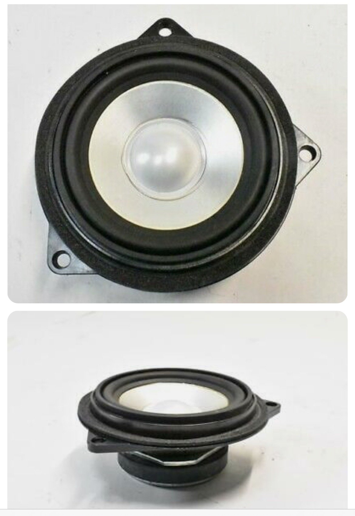

I’m using a pair of these (BMW p/n65136922215) for a little while as full range, aluminum cones work great for the pennies they cost.
Don’t have that seductive sound of a paper cone however. I wouldn’t mind trying some of the regular, standard option parts.
Is hard to beat a 4” for vocals/midrange.
