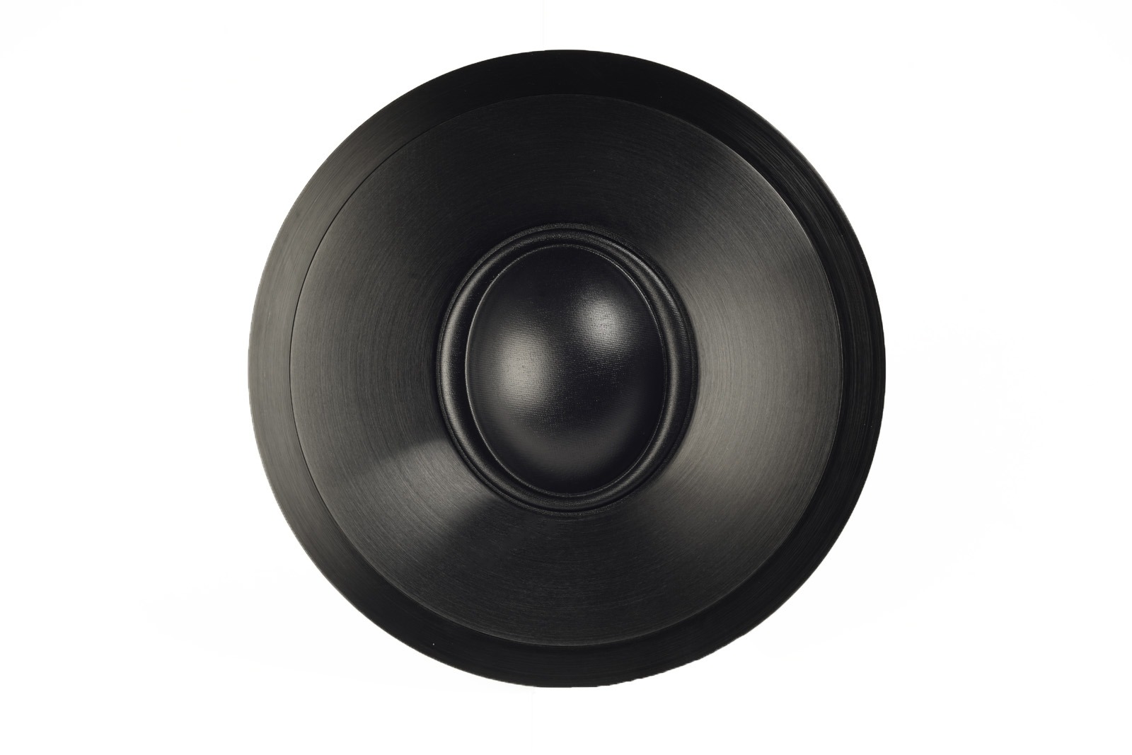

i was first introduced to SS in 2002. Yes the classic 18W8545/8535 and D2905 soft domes.
how times have changed…
Looks nice over the 400Hz to 3.5 ish Khz band.
Like any other small driver (Sd is only 57.8cm) its going to have soak up a lot of power and use a lot of its max travel to produce decent SPL/dynamics.

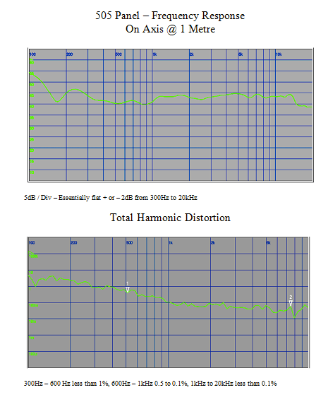

Has anyone heard a dynamic midrange driver that can rival a competent ESL for midrange clarity and timbre for voice or acoustic instruments?
ESL can do 150-6000Hz with no crossover and low distortion for mid-range pleasure. Do any dynamic drivers meet those basic parameters for midrange integrity?
Modest size ESL mid-range panels for a two or three way DIY speaker are available e.g:
http://www.eraudio.com.au/505_Mini_Panels/505_mini_panels.html
505 Mini Panel specifications
Dimensions 505 x 150 x 5 (H x W x D in millimetres)
Sensitivity 86dB for 2.83v input
Frequency Response 200Hz to 20kHz + or - 2dB
SPL limited and the time of flight differences between the centre and ends of panels make them sound phasey to me. LAs too. Still not as good as my Unitys, none of them.Has anyone heard a dynamic midrange driver that can rival a competent ESL for midrange clarity and timbre for voice or acoustic instruments?
Yes, there are dynamic drivers which can do that. I used aurum cantus ac130f1 to cover 150 to 5000.Has anyone heard a dynamic midrange driver that can rival a competent ESL for midrange clarity and timbre for voice or acoustic instruments?
