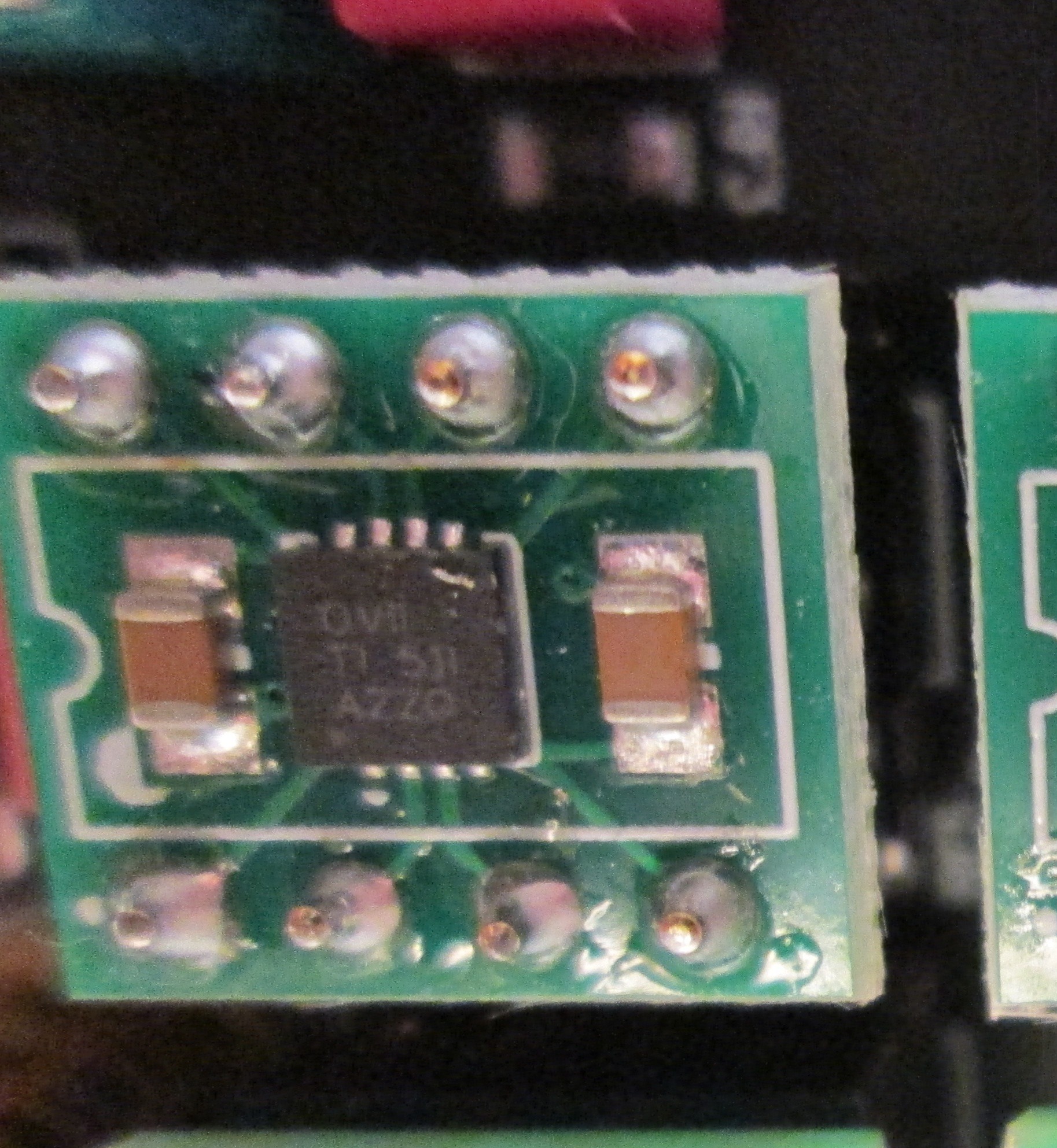

I believe these two (highlighted in bold) are just codenames for the same OPA1612 from TI: Search by "OPA1612" (lcsc.com) but packaged in different ways.
Except that Texas Instruments does not make anything with those names/numbers. I asked them.
OPA1612AIDR and OPA1612AUDRGR are explicitly listed in the OPA1611/12 datasheet, and OVII is the marking for the latter (which is too small for a long code). Look for the package option addendum at the end. I think A is just the major version, I is industrial temperature range, D is SOIC package, DRG is SON package, R at the end for reel.
Interesting. So much for asking customer service. Must have been some confusion. Either that or what they meant was that the ones I have are not genuine. Not sure at this point I guess. Sorry for the confusion.
https://www.ti.com/lit/ds/symlink/opa1611.pdf
It's alright. TI is known for using bots instead of real people for (some of) their customer support services.

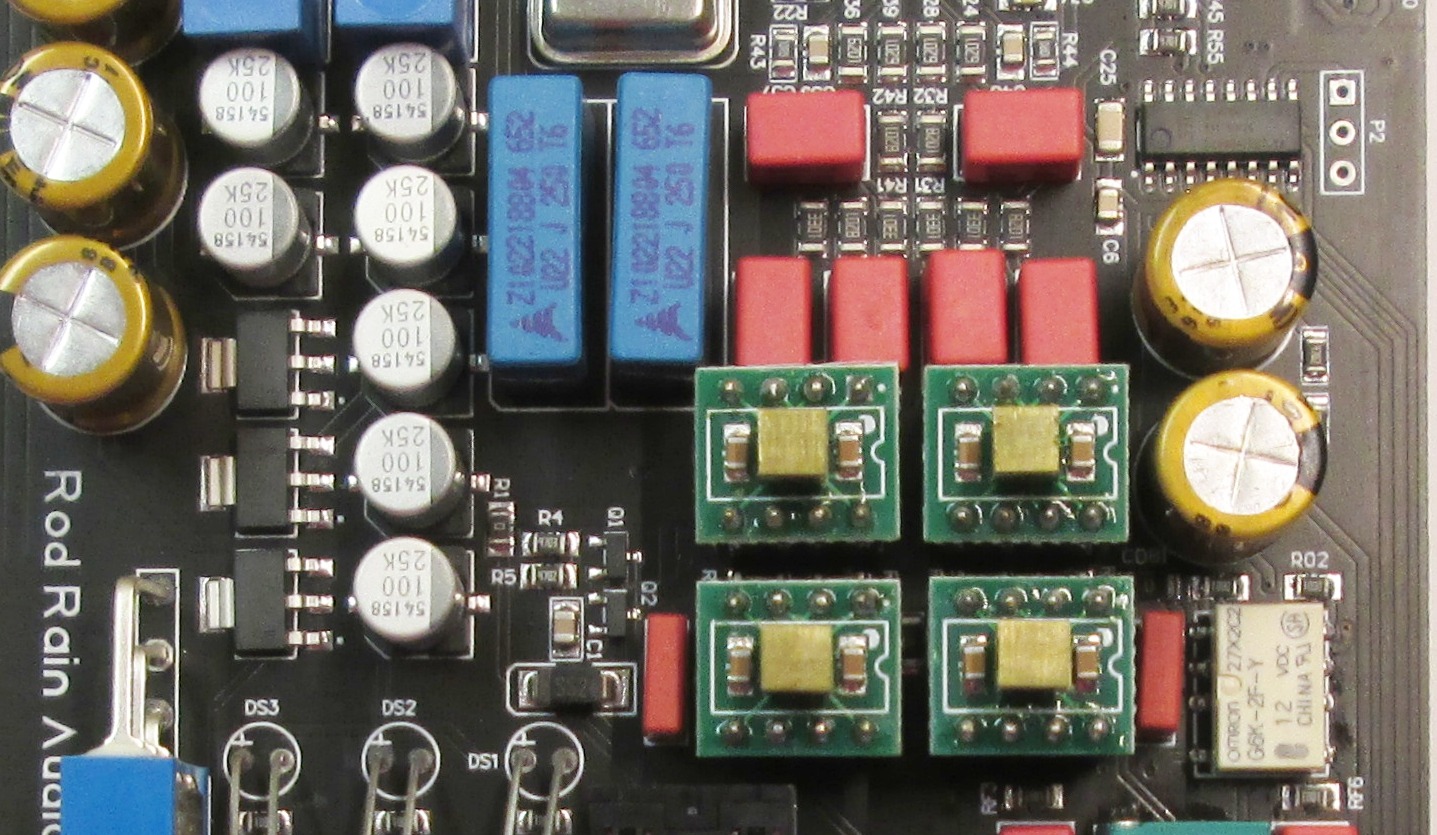

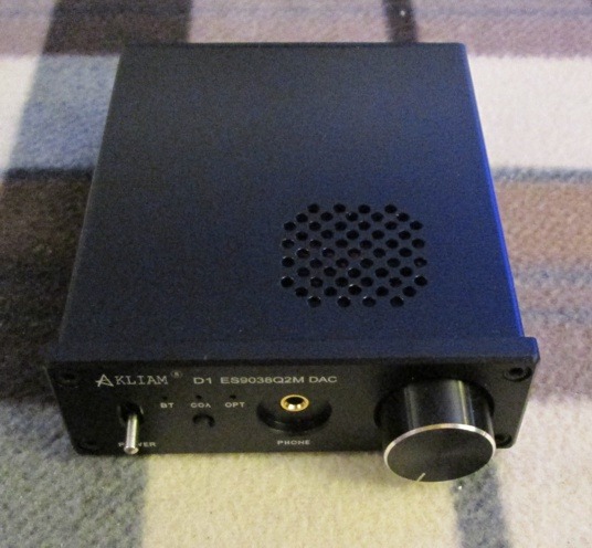

They were not overheating. They were very warm with a finger touch, but they didn't burn my finger. However, they just didn't sound as good warm as they did stone cold, so I fabricated tiny little heatsinks from the material I had on hand, which happened to be brass. Admittedly not an ideal material, but it's what I had. I'm not using them right now, having switched to Burr-Brown, but I may come back to these some day. I have no idea if they are genuine, I doubt it. The printing on them is awful.
I also perforated the top of the DAC where the four op-amps are located and installed custom made lead bars in the chassis to weight it down because I was tired of it sliding around on the shelf. A guy on ebay made the weights for me. I found tiny heatsinks on ebay to put on the Burr-Brown chips, and they now run cool to the touch.

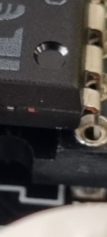

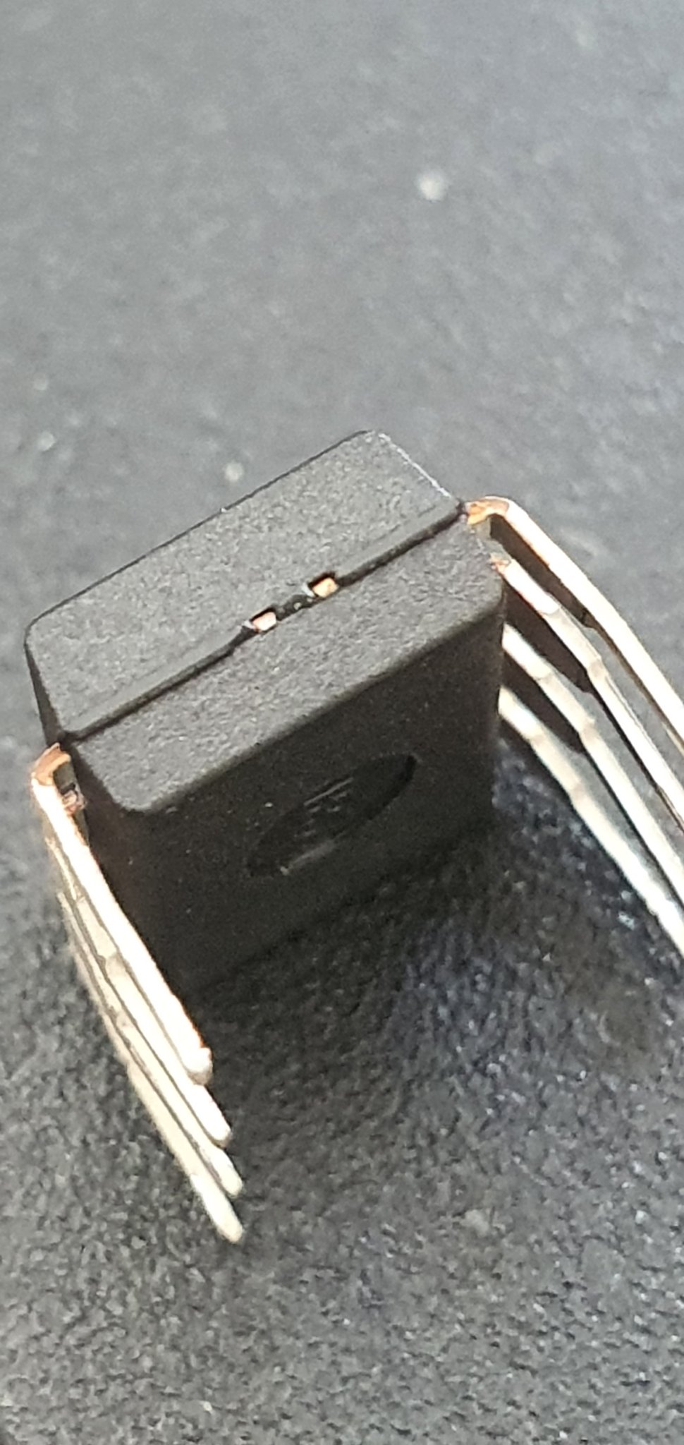

Morning. I didn't. Just did a visual inspection . Carefully inserted them into the turned key sockets in the pre amp without murdering them and left them be. I can do tests if required. Multimeters and scopes are at work though.
They might just be better quality fakes than the last ones though 🙂
Does it have any copper protruding a bit from the sides? How are the legs? Use some stronger neodimium magnet.
Top seems well made, small deviations which can be production, small deviations comparing to mouser ones. I don't see tiny areas of copper protruding though. Legs must be literally pliable, very much so. No magnetism whatsoever as well.
Most markings are there, but top is still a bit off comparing to mouser one.

There's 100's of scientists and engineers on site at work. I'm sure they'd be up for the challenge 🙂. The fact they have non magnetic copper/zinc legs makes them interesting .
