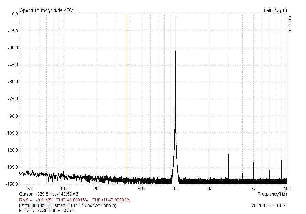

Spiri, best for me is, if it does not sound (without any "footprint"), so it is also my personal border between hifi and midfi. I am looking for best possible results without "unobtainium" components.
Similar like MUSES means the same concept, on chip resistors, with integrated switches (WM8816, PGA..). Limitation are inherent for MUSES, too. It is clearly visible from measuremets. Relays are "quasiperfect" .. It is clearly visible from measurements.
I agree with you, but when can we speak of no sound.

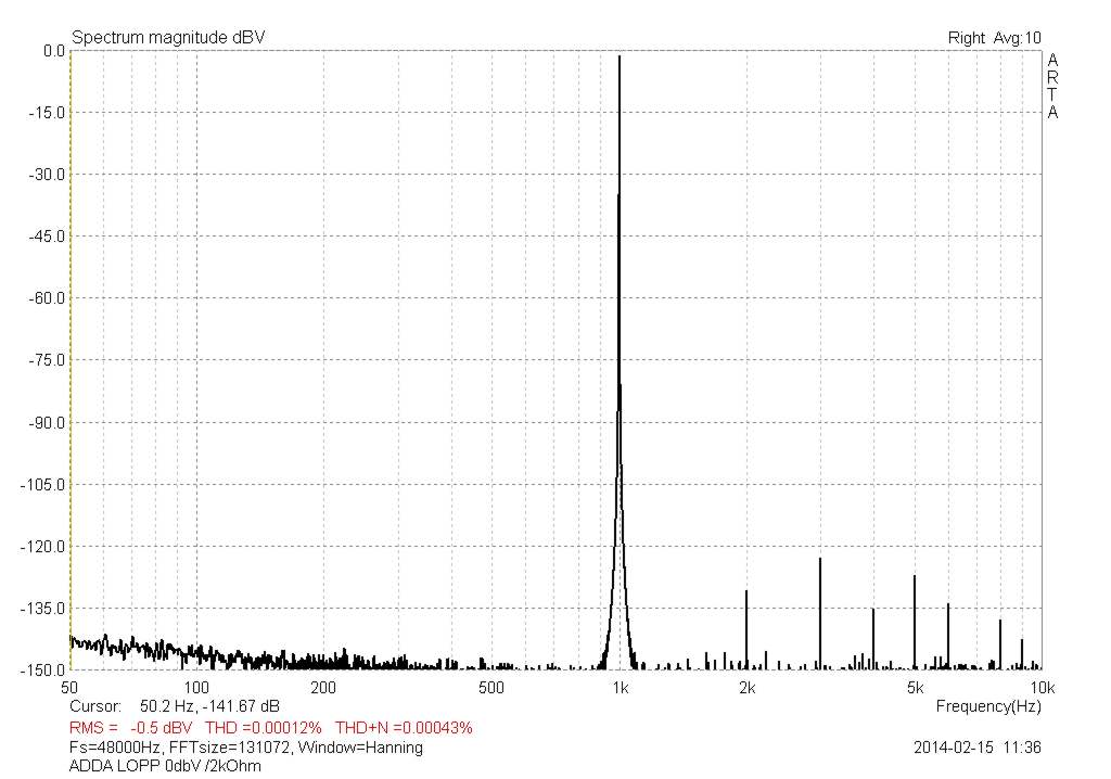

I'm at limits of my measurement equipment, but if I compare the two measurements, once my ADDA loop against my Muses-Pre inserted, I can say that the Muses is not audible or "almost not " visible. But also only quasiperfect.
The noise is not a problem and the distortion factor looks for me well tempered.
Maybe the numbers are still a little better when I use lower sampling rate (22050 not implemented yet in my ADC) and use a very low noise sin-generator, because I measured with my DAC with full bandwidth.

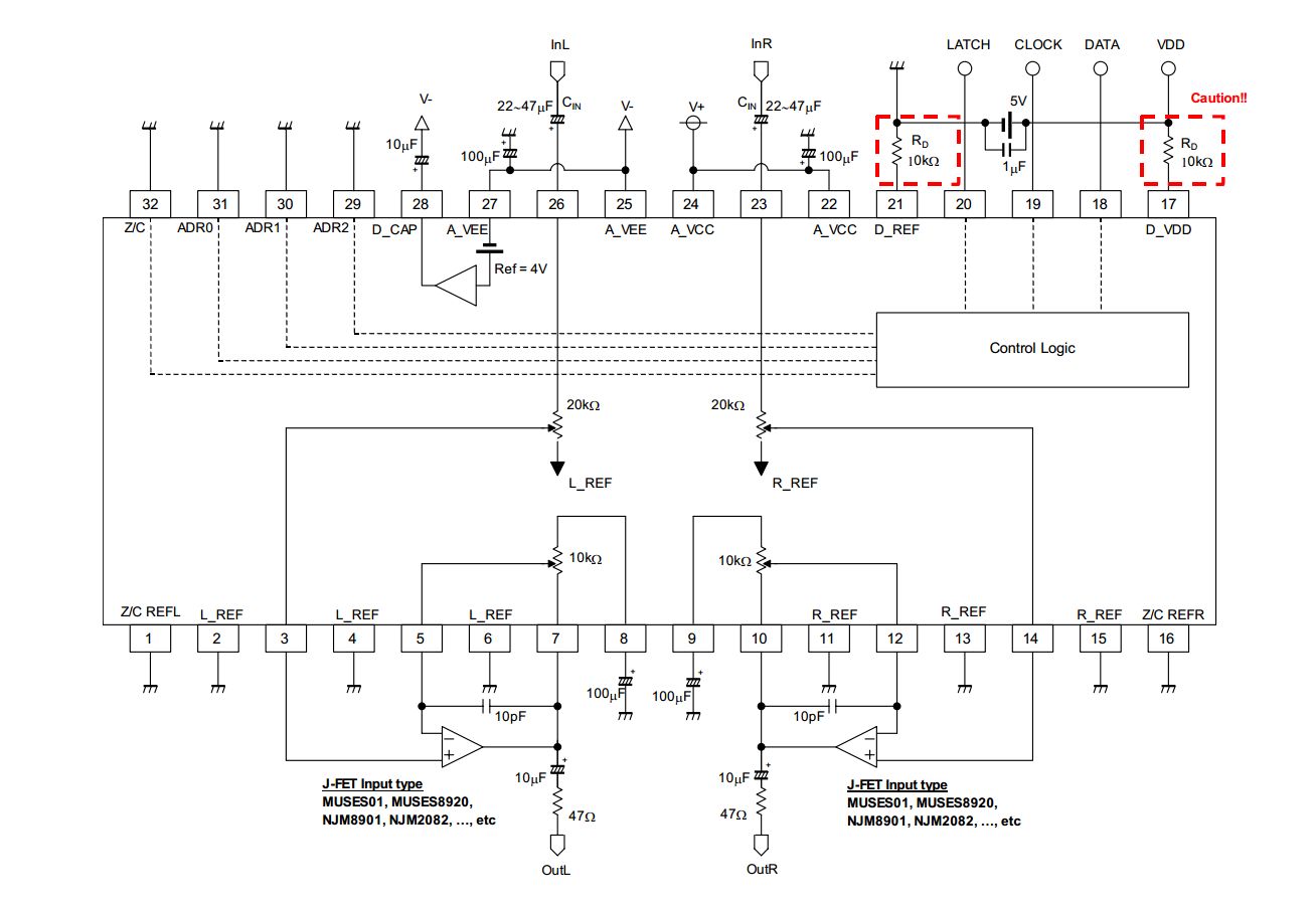

You can copy the schematic from our data sheets . (see links)
If you don't like to generate the digital voltage for the muses from the positiv analog voltage, make sure that there is a 10 kOhm in the DVDD line - pin 17.
Spiri, I like your 5V supply better...thank you for the schematic.
I still don't understand when, or when you don't use the 10K resistor on pin 17.
The datasheet mentions something about using it to keep too much current from flowing through the 7320 and burning it up.

When using the 7320 with op-amps on the outputs, the datasheet shows connecting the noninverting inputs to a pair of 10K ohm pots within the IC. That seems to me like it would vary the gain of the op-amps.
Why would you want to do that? What is the purpose of the 10K ohm pots?
If I wanted to use op-amps as unity gain buffers, wouldn't you want to connect their outputs back to the noninverting inputs and forget about the 10K pots in the chips?
I also see where the manufacturer recommends using a couple of nasty 10uF caps on the outputs, which I assume are for DC offset.
Read in the datasheet: Current flows when the power [V +] is less than the power [D_VDD].
This could happen if the 5V ramp up faster as the well stabilized V + .
The 10kohm limit the current.
If you don't want/need to adjust the closed loop gain of an opamp then you should connect these pins to GND.
So pins 5,7,10 and 12 should all be grounded and leave out the 10pF caps as well?
