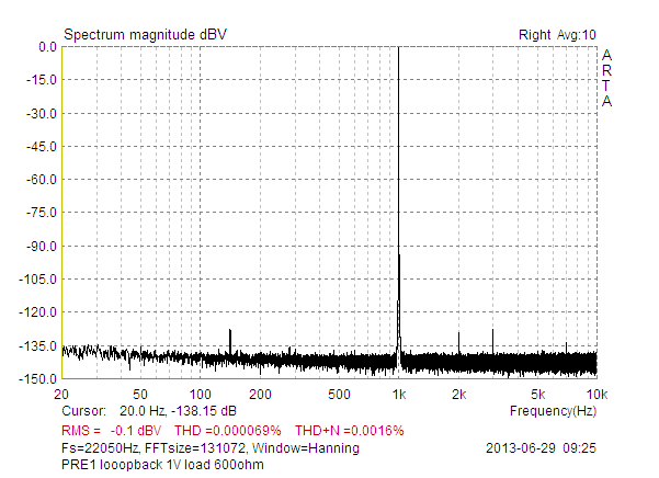

The chip measures almost perfectly and sounds excellent.
I was curious and I also used a RMAA pro.
I measure the muses board in a balanced configuration with my Fet Buffer and OPA1632 gain stage. So this is one channel of my preamp.
It bothers me only the 50 Hz peak, which comes from the built-in transformer in the ADC enclosure.
Have fun!

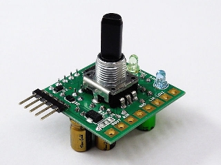

Stand alone pot with Muses
I really think that something similar to the following photos would be extremely useful and desirable for many diy-ers as a stand alone volume pot, and I really do not think it is something very hard to realize as collaborative effort.
Anyone interested in this beside me?

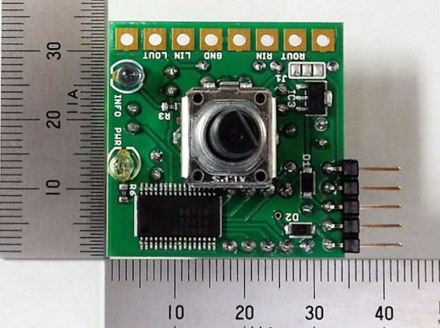

A replacement for a potentiometer is quite reasonable , but in this case no remote control and no indication of attenuation is available .
In addition, a controller is located on the board and this I would like to separate from the audio circuit . Long wires from the back to the front plate and back to the audio circuit and an additional long connection of regulated supply voltages is also not desirable. I like to have the regulator on the spot.
That's why I also have a pre-amplifier on the bench, which is connected directly to the Muses Board and thus achieved very short signal paths.
I have two possible ideas to get the Muses in the signal-chain.
An even more complex module where the XLR inputs with input selection and XLR outputs with mute relays and an output drivers are on one board.
Thus, a preamplifier can be realized without a lot of effort. Also for Pro Audio Mux.
Or a Muses board with all supply voltages regulators without input selection, but still with an external controller. This Muses Board could fit on a printed surface of a motorized RK27 potentiometer.
Hard to decide what comes up next.
