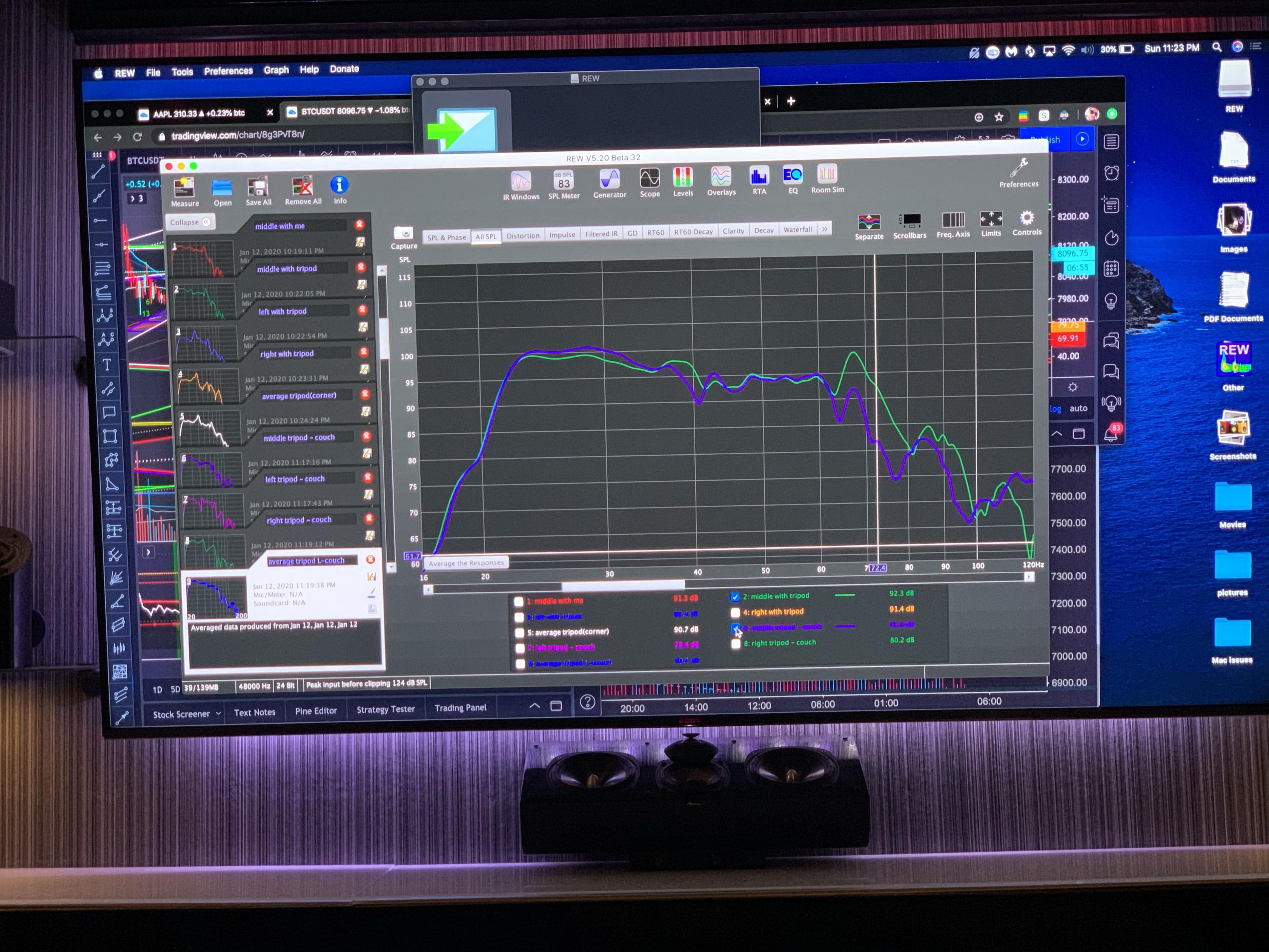

Hello dr. Geddes,
I would like to ask you for your help.
I finally got 4 subs for my studio (control room) to solve room frequency response (room modes) with multisub approach.
I´m using 4 pieces of Presonus T10 Temblor ported subs (price/performance) - with frequency response 20Hz to 200Hz (+-3dB) with my mains.
I managed to get pretty flat frequency response of the room (+-3dB response curve) but I think that decay time is not good. The placement of the subs is asymmetrical, as Mr. Duke described for his system The Swarm. I´m also planning to elevate one of the subs above the center line. I have some absorption on the wall and in the corners (but still need to solve some flutter echoing).
First I placed my mains the best I could then I added 1st sub in the front right corner and set the gain, phase and add some EQ on that sub to bring a lot of low end from 20Hz to 40Hz to get best response possible. It´s strange that the sub didn´t deliver 20Hz to 40Hz spectrum naturally; despite manufacturer claims that T10 Temblor delivers 20Hz to 200Hz (+-3dB response curve and 20Hz -3dB), maybe there is some modal issue or something, I don´t know.
Then I added 2nd sub on the opposite wall, have set the gain, phase and corrected only one frequency with EQ on that sub.
Then I added 3rd sub along the long right wall pretty close to sitting position, have set the gain and phase and the 4th sub on the opposite left long wall, near front left corner and have set the gain and phase.
I have also corrected some critical mid and high frequencies of the main speakers with graphical EQ on my DSP.
During the placement and measuring process I also tried to set the delay times of the subs with the DSP but it didn´t make any significant change. I also set the HPF on the mains at 45Hz because I I´ve noticed some distortion lower than that freq. All subs have LPF at 130Hz to blend with main speakers as much as possible.
Please see my print screen of the final measurements, especially the waterfall (critical decay times) and some photos of the sub placement, absorption on the walls and corners, etc.
Measurments are having 1/6 smoothing. I can also send you REW measurement file if needed.
Should I repeat the whole procedure and set the subs with no prior dsp EQ and set the EQ on the end?
Should I bring up missing low end frequencis at 20Hz to 40Hz with the dsp EQ or leave just natural sub response?
Your help would be much appreciated. Thank you in advance!

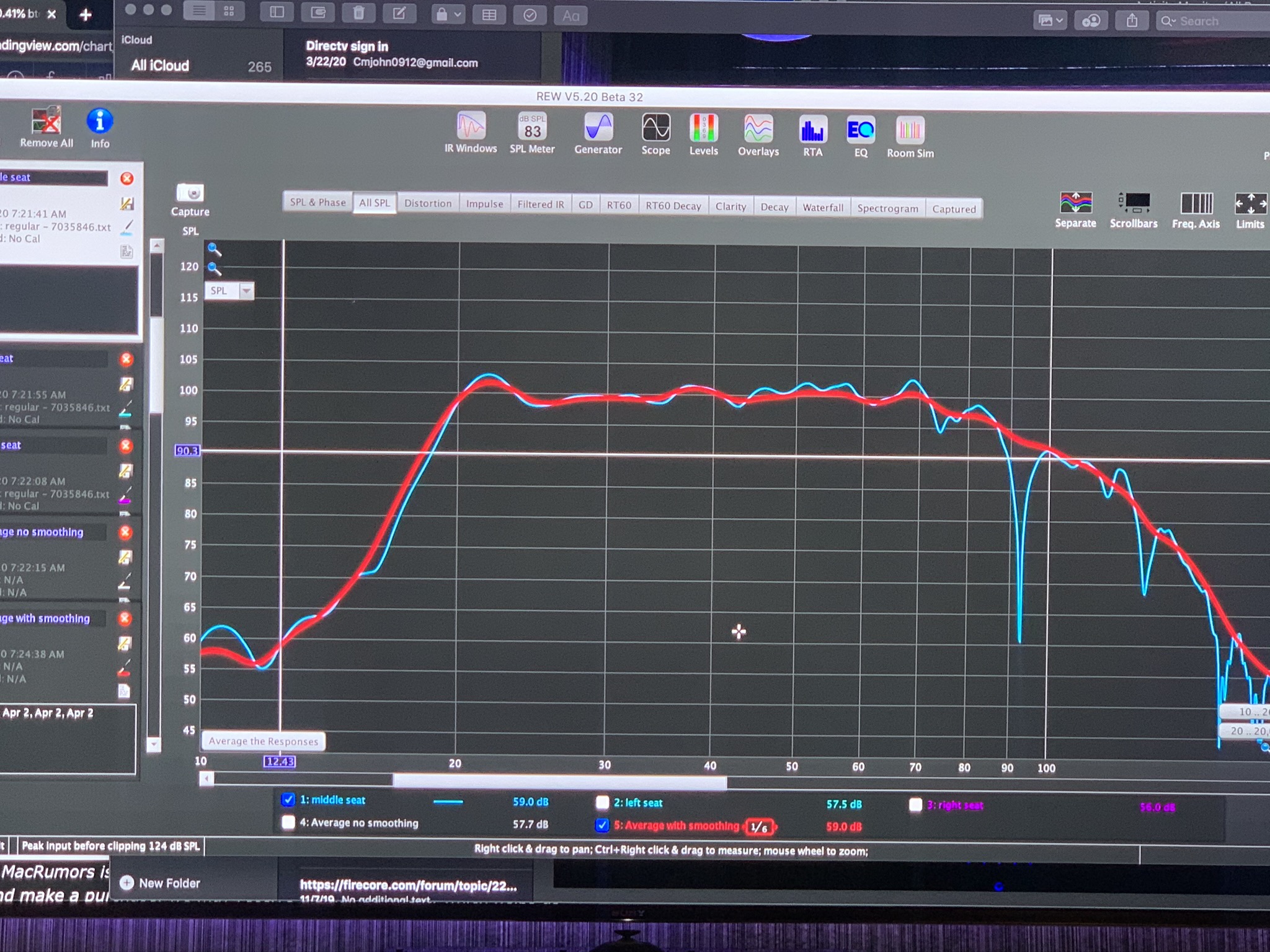

This is with 4 small subs. 3 klipsch sw350’s. Two of those in cabinets mounted to a wall with ventilation under. One more on the right of my couch and an energy 10” to the left of couch. 3(8’s) and one 10. Not too bad for room gain looks like. This is no eq beside me playing with things in roomeq/distance and the 10” sub has a full phase dial I can adjust to get it to play well with the others.
Just added a dsp in but haven’t redone things yet to see if I can get it any better.
Awesome, the freq response o the sub looks great! Thanks for sharing. Do you also have multisub setup?
Hello dr. Geddes,
Your situation looks to me like you have the best that you can do with your constraints. Clearly the rooms two lowest modes have little damping and hence the long decay. This cannot be corrected with the subs because it is a room problem. Your bass traps are clearly not working at these very low frequencies. The only solution down that low is to have the walls themselves act as absorbers - just like I do in my room. This is the only technique that can provide substantial damping at these VLF.
I would say to just live with what you have unless it is unacceptable. Then you need to make the back wall floating with a lot of damping.
Thank you for your review dr. Geddes, I really appreciate it.
My bass traps are made of ticker MDF and filled with mineral wool insulation Knauf DP80, so yeah, like you said, they are not suitable for very low region. It seems I will have to live with that until I will construct diaphragmatic absorbers (Acoustic Fields blueprint) like I planned before multisub setup.
Do you think that diaphragmatic absorbers would be enough in the rear corners or should cover the whole rear wall with them? How did you construct your walls? Do you have floating drywall of somekind?
Do you think that my Sub 1 in the corner should face away from the bass trap?
