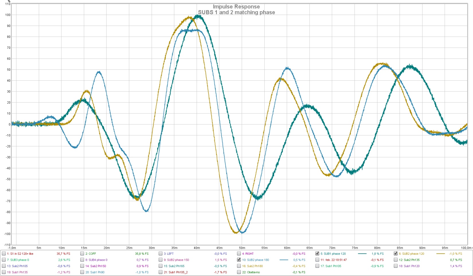

But changing phase is time alignment, no?Believe what you want, but time alignment at LFs with multiple subs is a waste of time. The timing difference at LFs will be only a fraction of the period so in essence only a small phase change will result. This will be audible only to the extent that it changes the frequency response. But if the FR is set with and without the delay then the end result will be the same either way. The ear does cannot resolve time differences at the low frequencies.
When I change phase and check impulse response plot the front two subs are better matched. See the attachment. SPL has also improved.
My understading is they are better time-aligned as phase is an aproximation of delay.

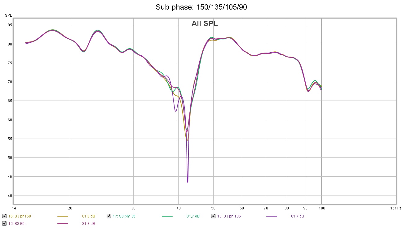

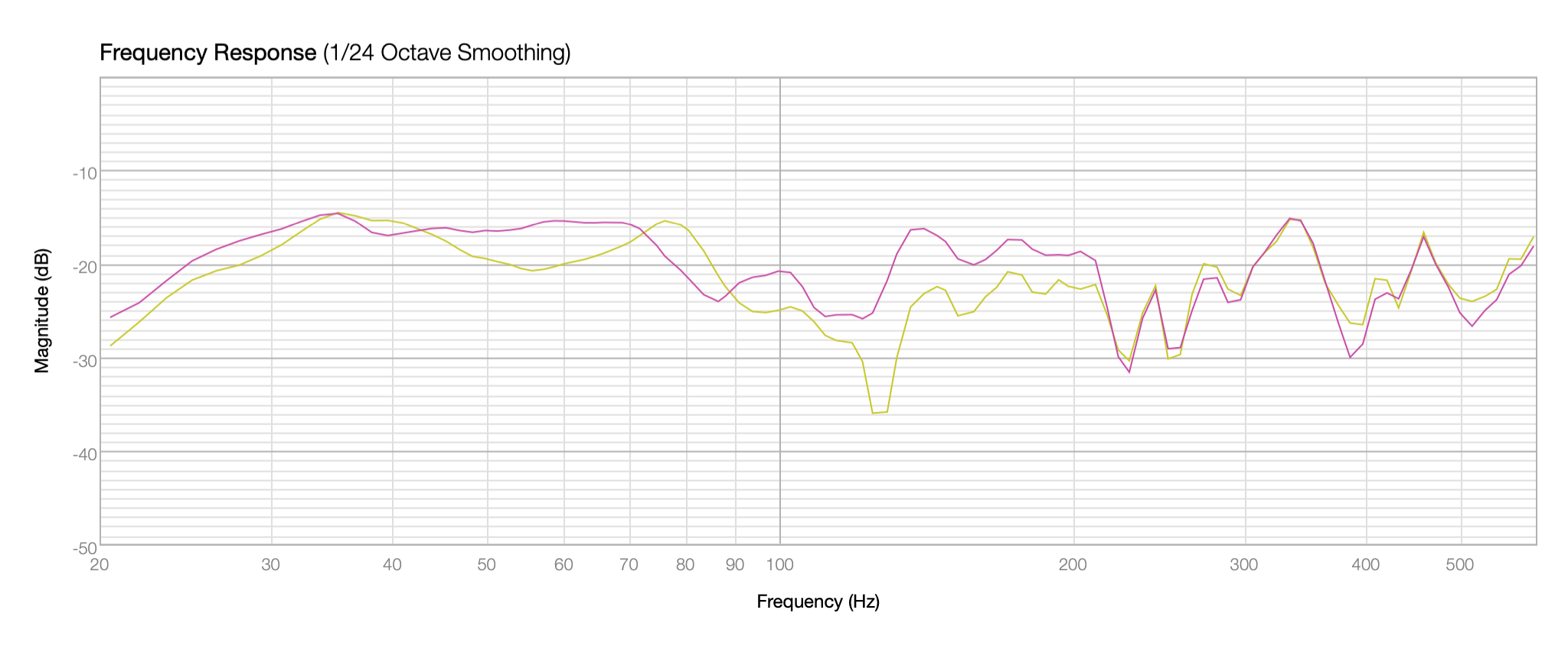

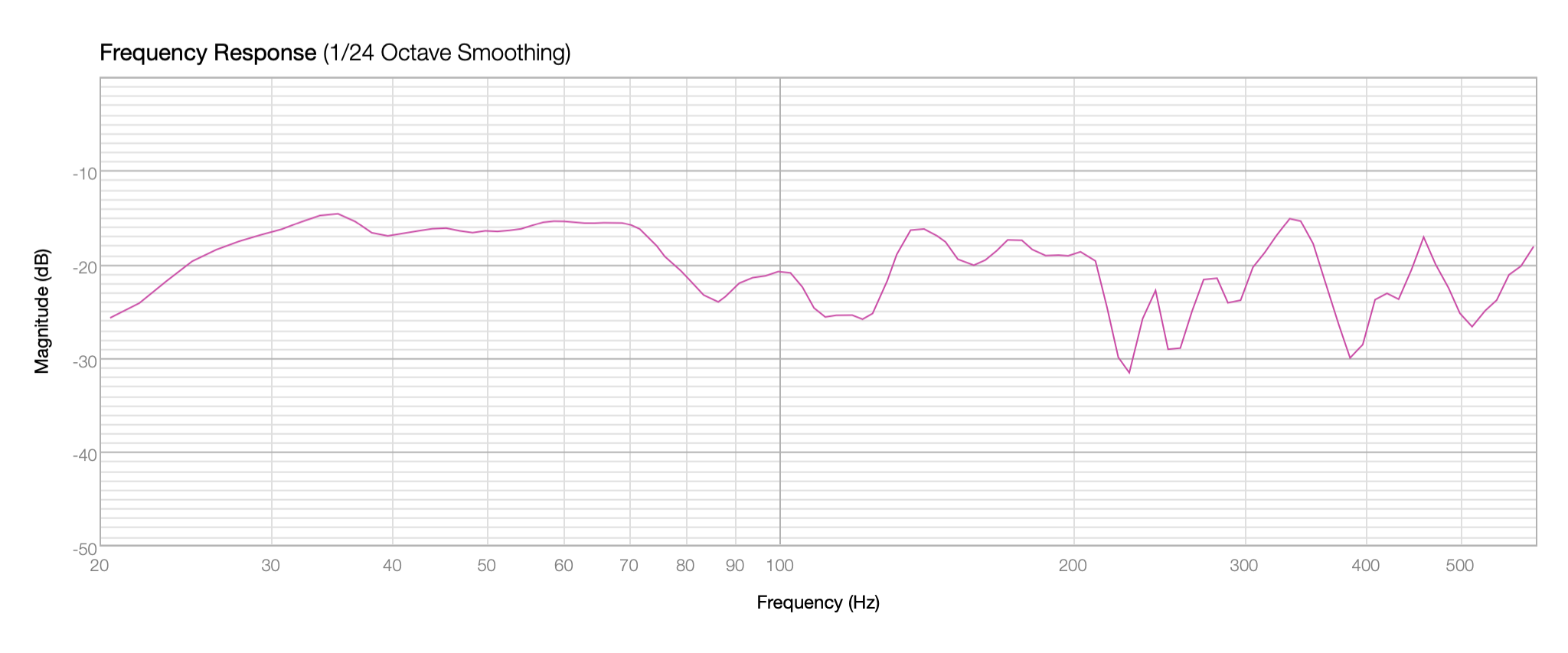

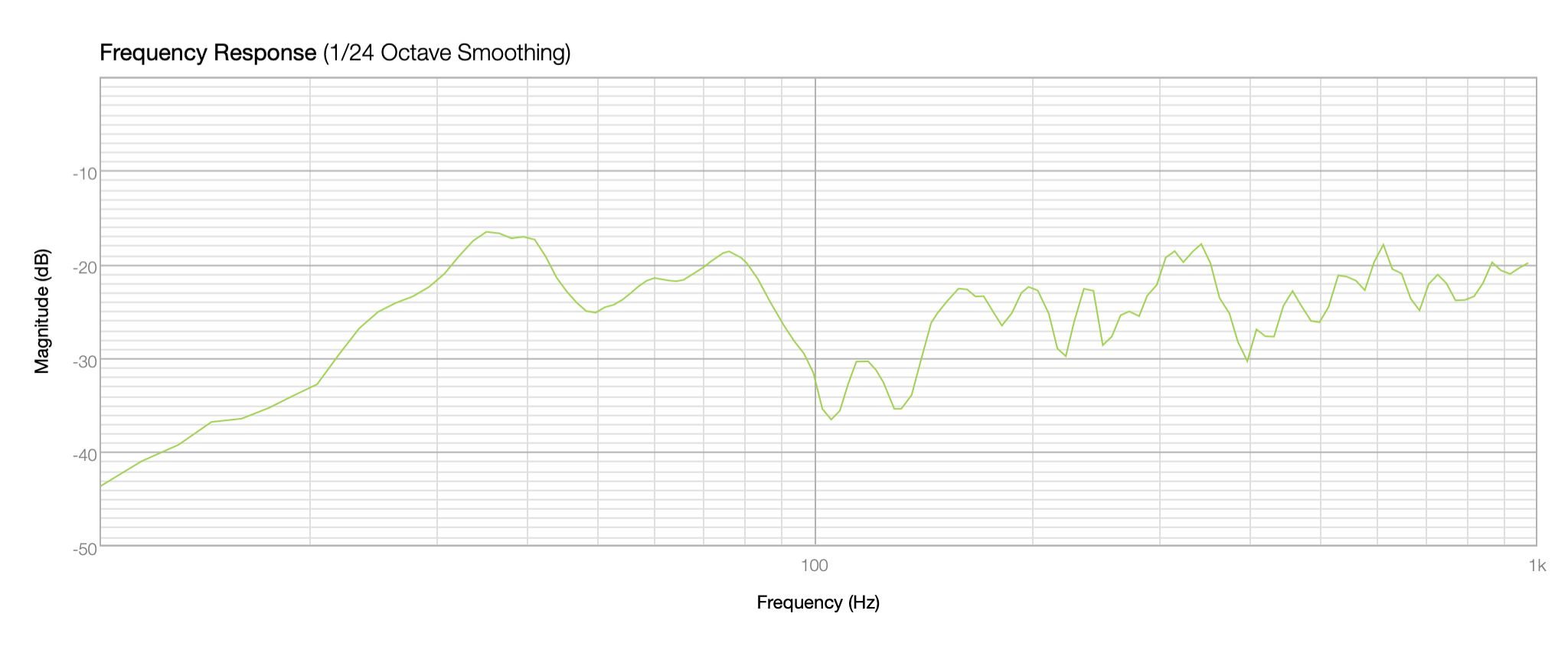

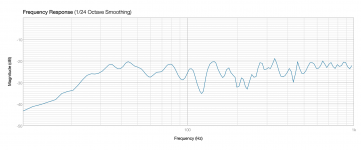

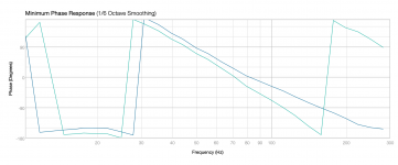

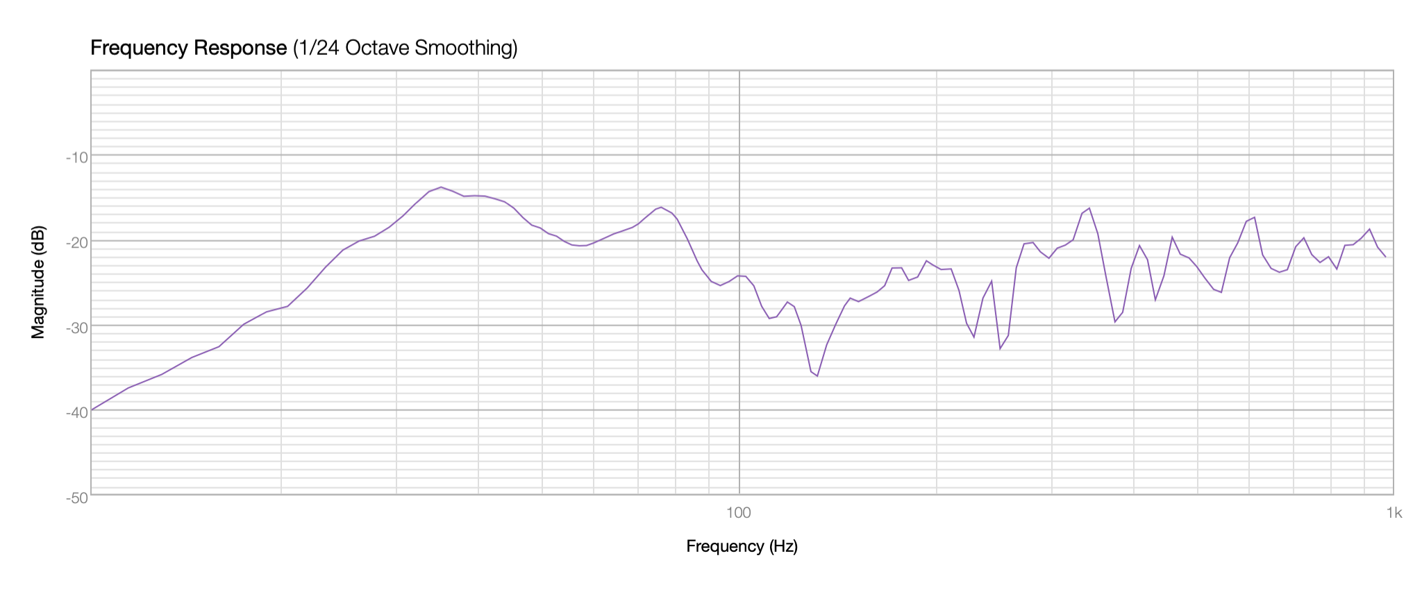

I have followed the literature on the multi-sub approach. Recently there was a great sale on my subs so I was able to get two more for a total of 4.
Mains are JBL LSR 6332 (ported 12" W):
https://www.jbl.com/on/demandware.s...ult/dw2e824d49/pdfs/JBL_LSR6332_SpecSheet.pdf
Subs are JBL 550P, 10", sealed:
https://www.jbl.com/on/demandware.s...ecification Sheet - SUB 550P (English EU).pdf
The subs have a line input with variable XO, 50-150Hz and a LFE input. Phase switch between 0, 180 degrees.
All graphs shown are with subs out of phase (180). Low frequency extension was compromised with any 0 phase settings (? from the phase of the port roll-off of the mains).
One sub is under each main. The back corners have 1 each.
The room is 14x15x8. Beside the left speaker there is a large opening into the hall/rest of the upstairs (pretty clear based on the measurements).
I have Fuzzmeasure on my Mac so used it for measurements. Happy to clarify anything about them.
Running into the LFE inputs didn't seem to do as well. I tried all 4, fronts only, rear only.
What do you think?
Bill

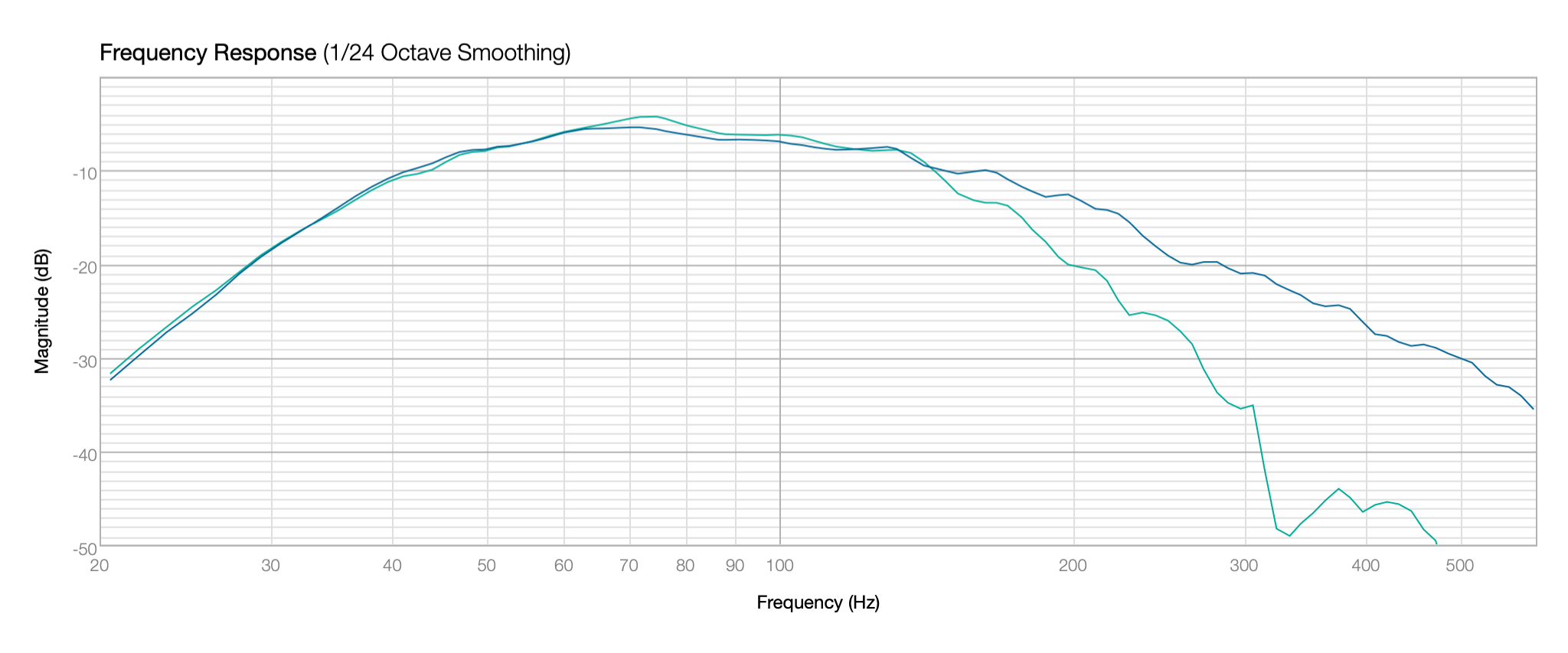

1- L main average
2- R main average
3- Sub FR XO and LFE
4- Sub phase with XO and LFE
What do you think?
Bill
1- L main average
2- R main average
continued
1- mains+L sub XO 150
2- mains+ L/R sub with XO
3- mains with 3 subs
4- mains with 4 subs

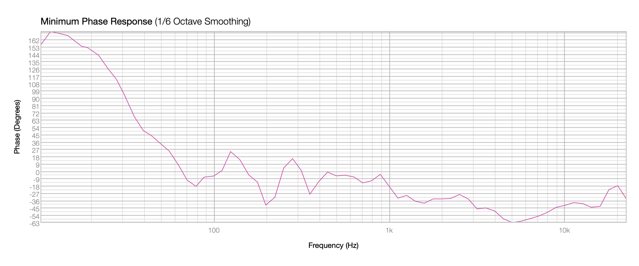

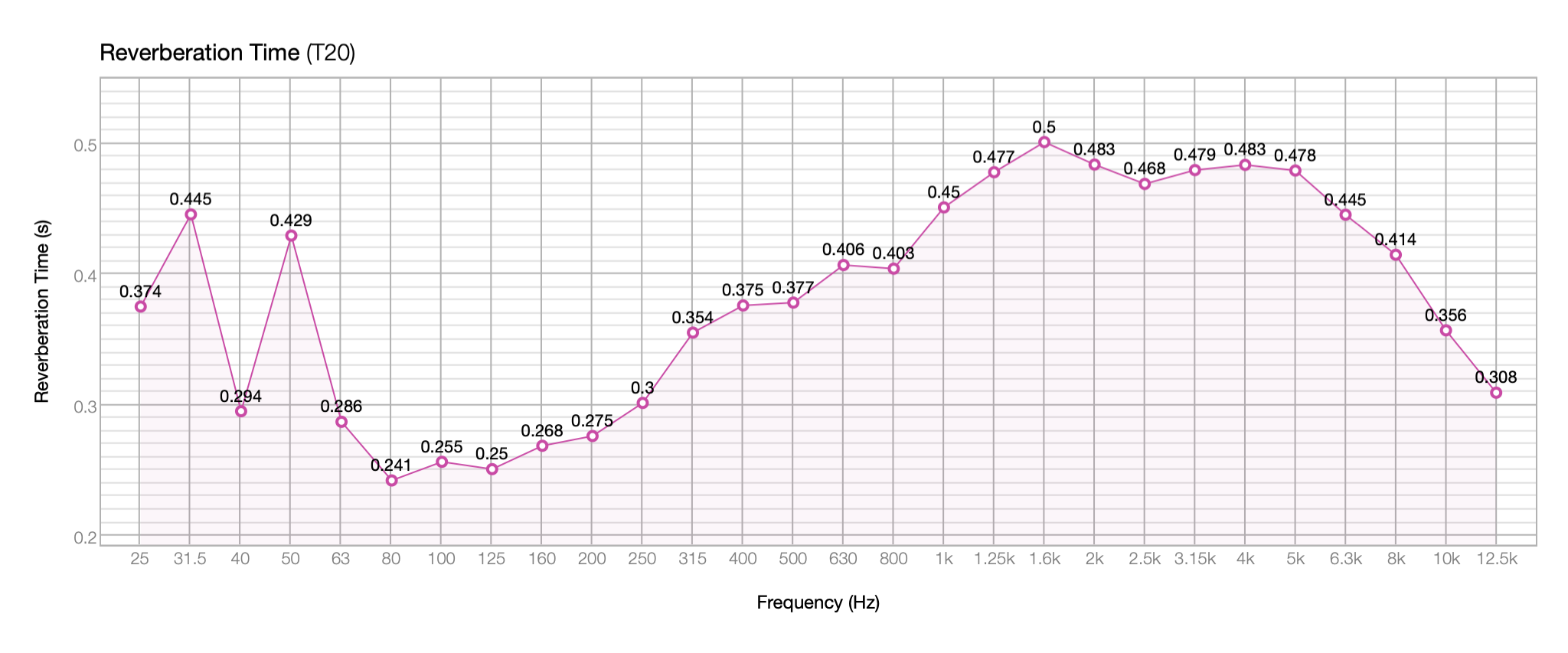

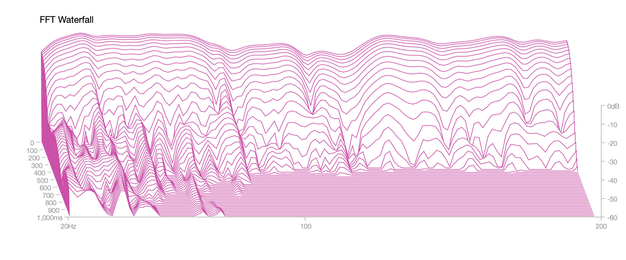

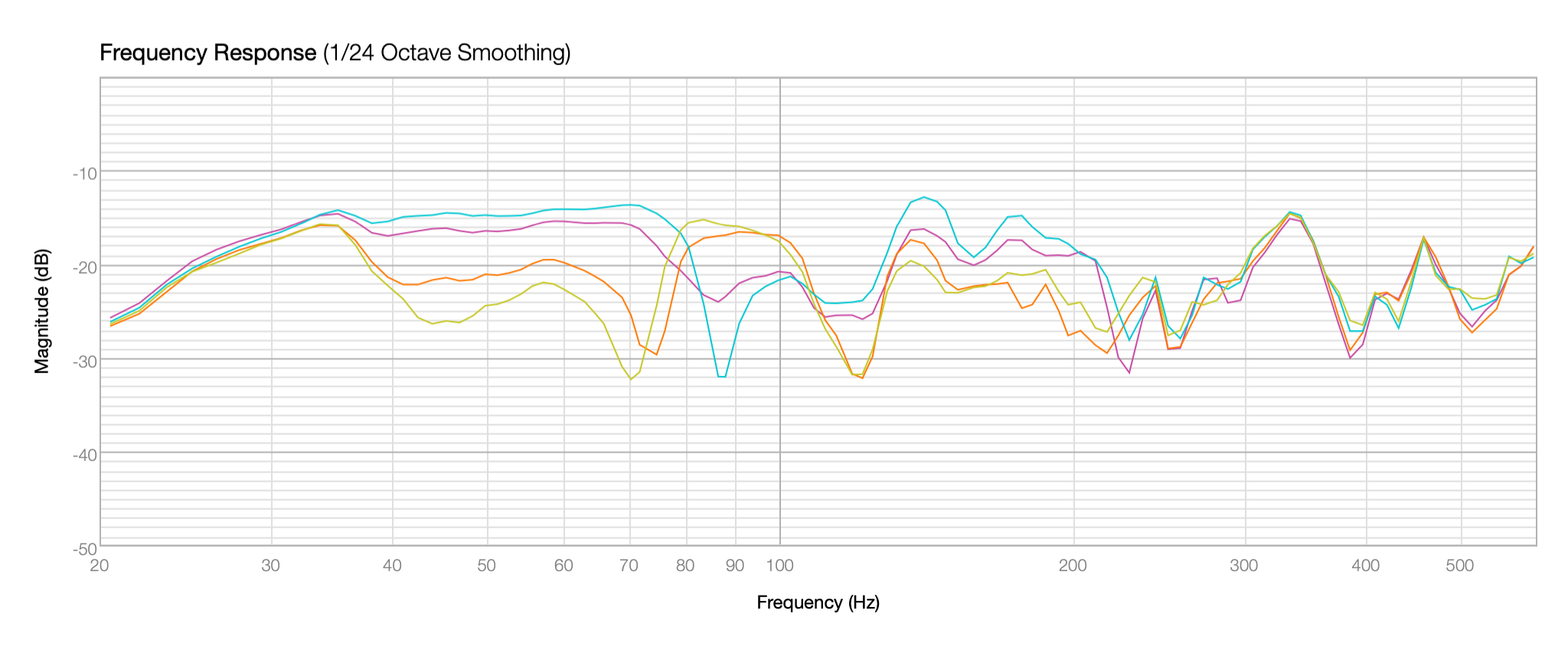

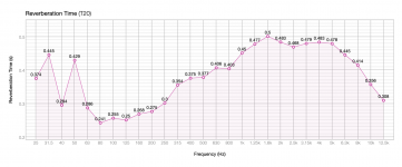

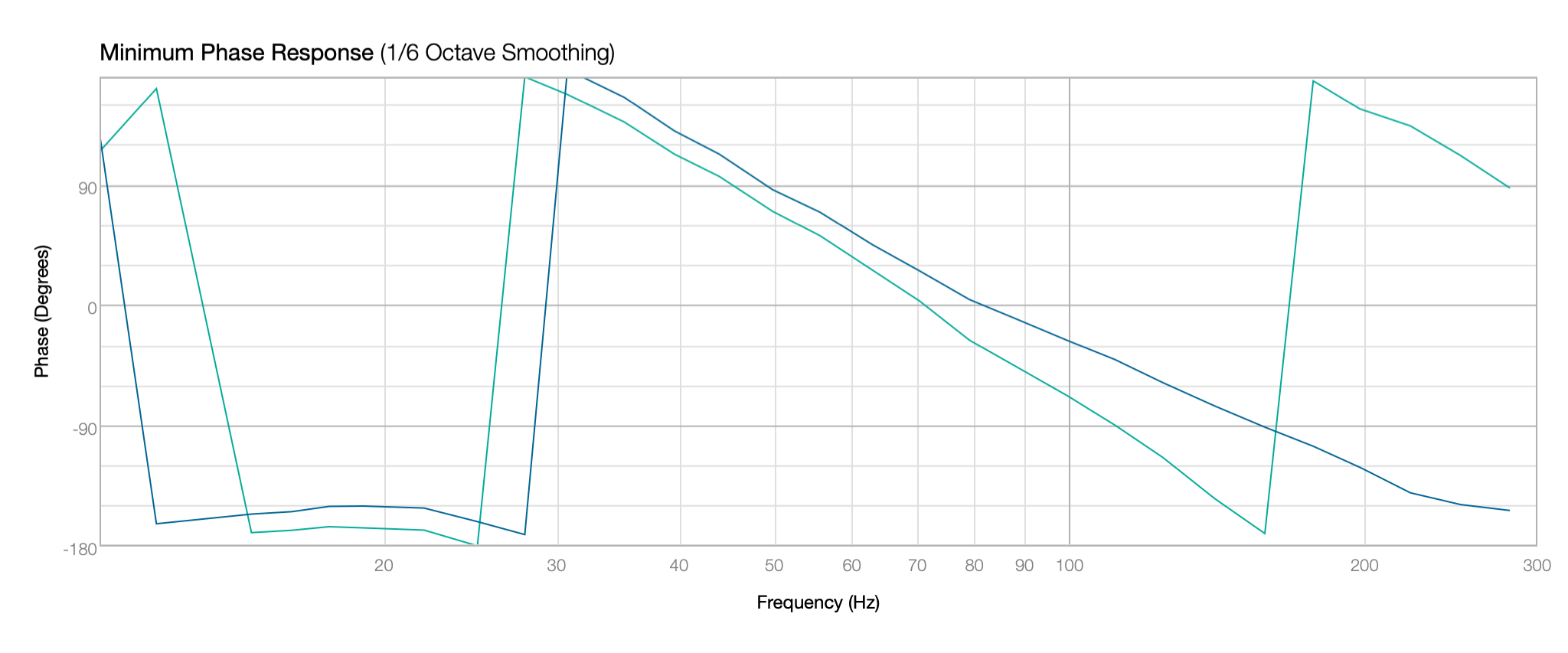

last ones
1- Mains only in green, 4 subs in pink
2- Mains and 4 subs CSD
3- Mains and 4 subs phase
4- Mains and 4 subs RT60
5- Mains with subs all XO (pink), all LFE (orange), LFE front subs only (blue), LFE rear subs only (green)

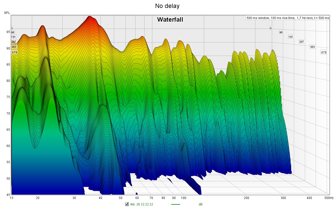

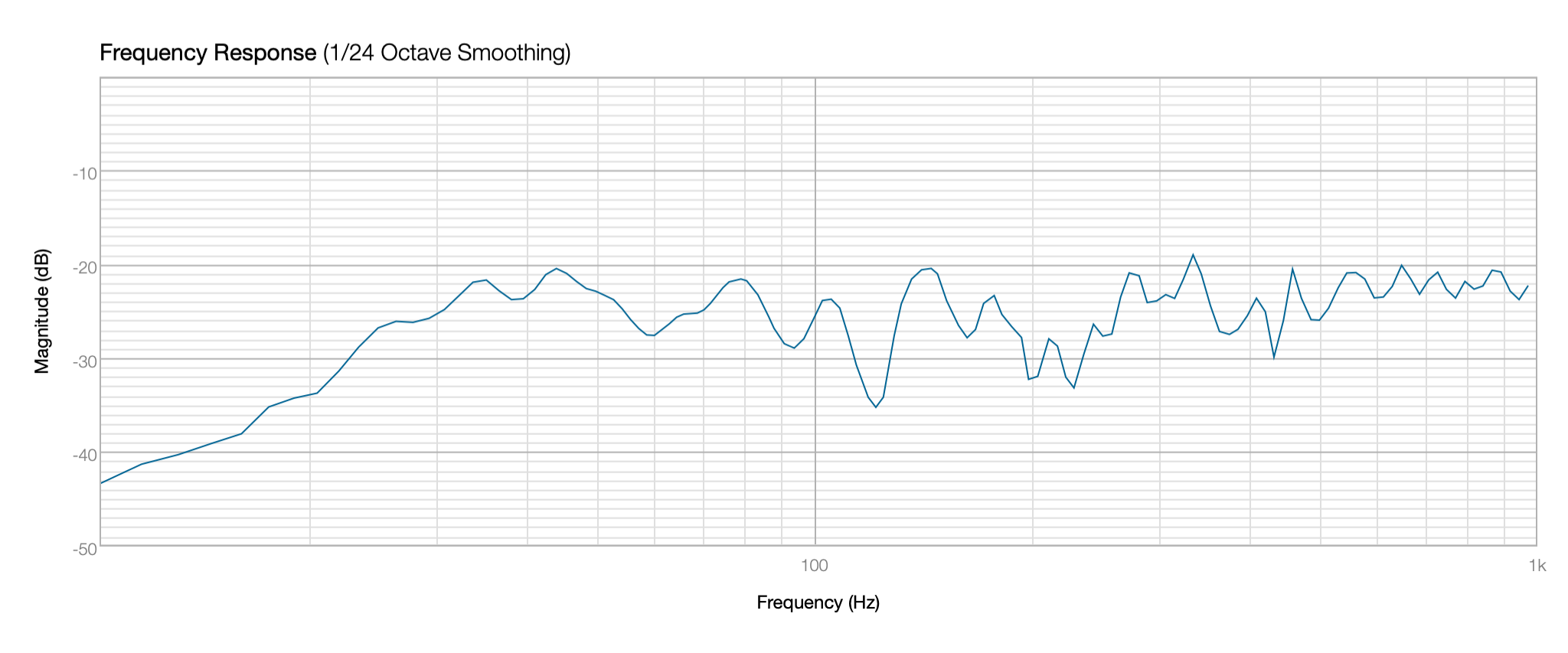

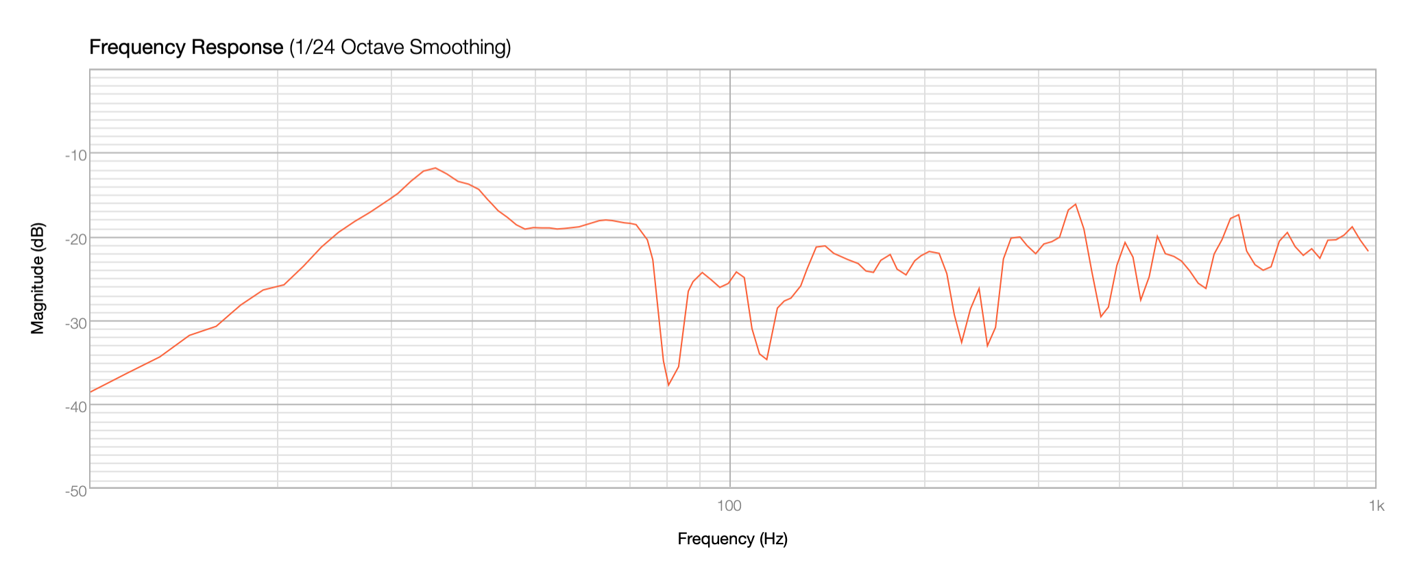

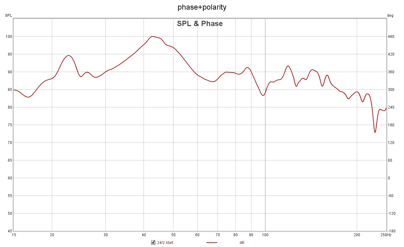

OK, I made a progress. I believe I'm done, the sound is great, FR looks good too.Believe what you want, but time alignment at LFs with multiple subs is a waste of time. The timing difference at LFs will be only a fraction of the period so in essence only a small phase change will result. This will be audible only to the extent that it changes the frequency response. But if the FR is set with and without the delay then the end result will be the same either way. The ear does cannot resolve time differences at the low frequencies.
I'm not a native speaker so it's possible to I'm not understanding you well enough.
Changing phase and polarity is time alignment, right?
We can also ignore phase/polarity settings and align our subs with delay.

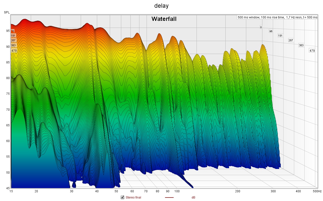

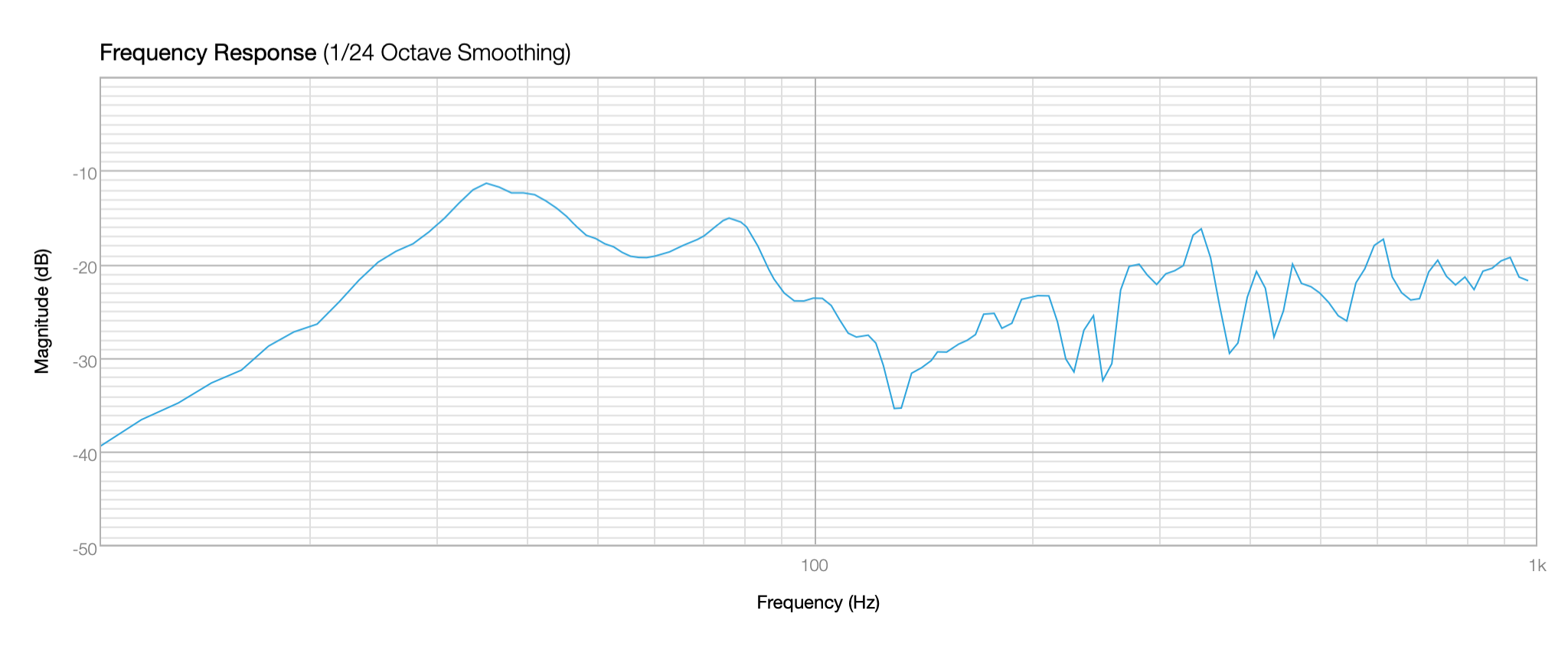

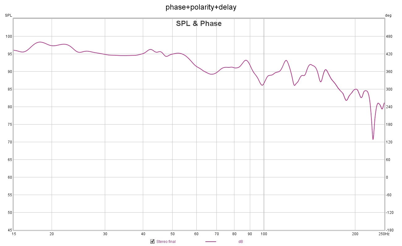

In my case, I got this result with phase/polarity settings (picture 1).
Then I delayed rear pair and got this (picture 2).
Seems to me time alignment is crucial for optimal results. I'm not sure if I could get the same result without delay but I'm pretty positive I could get it using only delay.

If delay would mess with modes then this would show on a waterfall, no?
In my case it didn't. Delay was set to 11 ms.

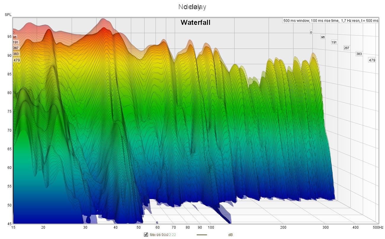

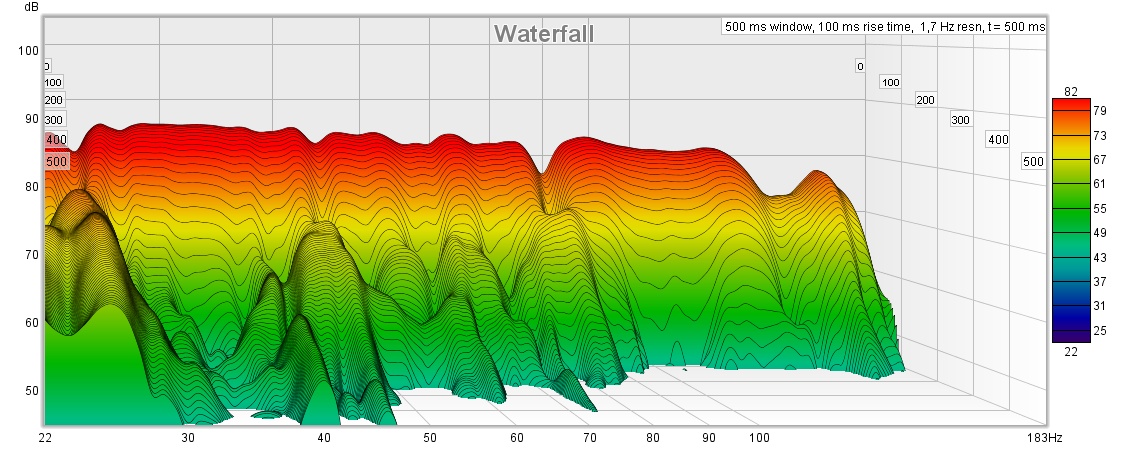

Sure looks to me like substantial differences from about 24 to 60 Hz 😉 about where experience would predict ..
(sorry, gave up trying to suck the 2 waterfalls on your #2273 down to here without going through my box and back; then the temptation to mark them up would've been too great ..)

You mean like that?Sure looks to me like substantial differences from about 24 to 60 Hz 😉 about where experience would predict ..
Yes, it's a nice change. I thought I would be able to sum all the subs up by using just gain/phase/polarity but obviously delaying the rear pair was necessary for a better result.
