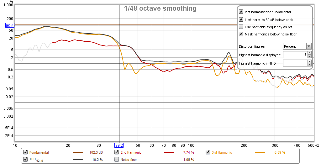

Based on my measurements (I analyze my builds by looking at their THD curves as well as FR an impedance), I'm pretty sure that most drivers start producing distortion as soon as their cones start moving 🙂.
The question really should be if the distortion is appreciable (measured) and noticeable (subjective). 10% measured THD at low bass frequencies could be considered appreciable, but whether or not it's noticeable is another matter - that's basically up to the listener and what frequency range we are talking about.
In general, I've found that different subwoofer alignments have different THD profiles, which generally have a lot to do with how the driver is loaded. 4th order bandpass alignments have the advantage of cutting a lot of the distortion generated in the passband by passing it through an acoustic filter, which results in pretty unique "THD profile" that perhaps accounts for part of the reason that it sounds "different". This THD profile could give the impression that it could be played louder before distortion becomes noticeable.
For example, I've attached a THD profile for my Enigma build, driven up to 10% THD in its passband (40 Hz to ~110 Hz). The "acoustic filter" seems to do a pretty good job of controlling distortion down to just above 50 Hz. Below that, the filter is no longer working to help reduce distortion and THD starts rising quickly. BTW, that THD peak around 170 Hz? That was caused by a rattling circuit board inside the enclosure (a passive two-stage limiting circuit that I added in series with the driver - to give it a bit more survivability, seeing that the Enigma was going to be used in my brother's bar as part of the background music system). The rattling circuit board was subsequently dealt with 🙂.
It may be possible to improve that THD profile 4th order BP alignment even further by "augmenting" the design with a small internal internal vent to introduce another driver displacement minimum, this one below the passband, the purpose being to reduce driver excursion more than increase output and/or widen its passband. Something I wanted to experiment with, but alas, the Enigma is already in use...
As for efficiency, that's an interesting question. Would a sealed alignment and a 4th order bandpass alignment with the same net volume and the same -3dB point have the same efficiency? One is a 2nd order alignment and the other is a 4th order alignment....
