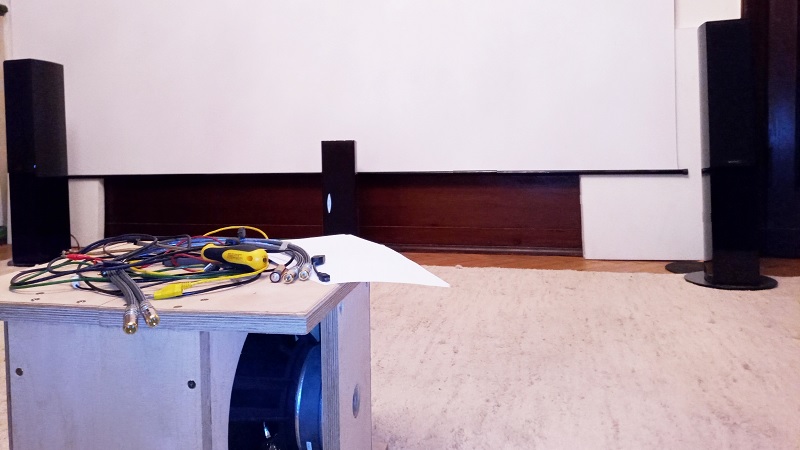

Hi, I would like to optimize my 7.4 system (4 = 2 bass reflex boxes + 2 Linkwitz dipoles) in a room 5 x 7 x 3.75 m3. T_60 in the middle frequency range is 0.3 ... 0.4 s. Large damping elements for the bass range should not be installed. There are no long corridors, ventilation channels etc. with exotic reverb characteristics (=> waterfall diagram not so important?).
Both film material with LEF signals and stereo music should be listened to. The goal is less a studio-like linear frequency response than
a) A clear dynamic (punchy) bass e.g. for heavy metal. At the moment the bass is not very accentuated.
b) not to be " pressed down " by organ music with longer low tones. At the moment there are resonances where you can really listen to how the resonance builds up and covers the "breathing" of the sound in the concert hall or church.
For reference I have a stereo system in which I can use FIR filters. FR and phase are optimized there for the listening position, in the bass they are not boosted. But in practice 90% prefer the uncorrected bass. In the long run the corrected version sounds more exhausting in the bass range: too unfree, not breathing and open, slightly over-regulated, unbelievable. Maybe this is related to the psychoacoustic effect that the ear wants to perceive the visible listening space, maybe the increase suggested by Earl Geddes is missing (3..6 db rise per decade from 200 Hz downwards). My conclusion is that < 200 Hz is no longer a studio-like linear FR.
The current goal is to find as systematically as possible what is possible with the current material. There will probably not be a procedure that leads to an optimal result.

SETUP
Receiver: Denon, the subwoofer channel gets a LFE + main signal. XO 80 Hz, filter details unknown, probably 12 dB/oct.

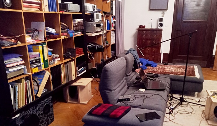

1) Front L+R Magnat Chromnium Style (with BR system up to about 30 Hz). Set as "Large" in the receiver, so they also get the full frequency response - unlike the subs R/L separated. So XO in the receiver (Denon) is basically an LP for the subs.
2) Bass Reflex Boxes (in future "BR") in the edge of the room under the shelf - they should stay there. (self made 60 l, chassis Seas Prestige CA26RFX (H1305), Free Air Res. 29 Hz, Q_t 0,34 Installation and cabinet resonance
tuned so that they do not hit the 33 Hz room mode).
3) 2 Linkwitz dipoles (future "LW") with 12" chassis (95 dB/W). 1 near the wall, 1 in the middle of the room, later under the coffee table.
4) Behringer DCX 2496 (3 input and 6 output channels phase, delay, EQ... adjustable), 4-channel Amp Img Stageline STA 2000D. Currently 1 In / 4 Out are in operation, you can define e.g. an EQ-filter for In, which will be applied to all 4 Out etc.

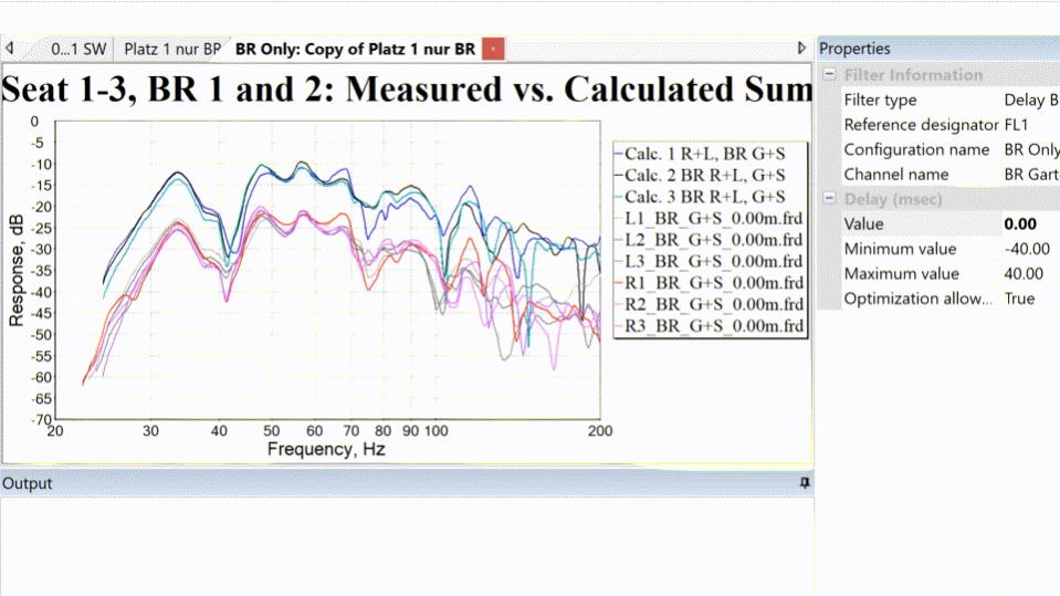

A very nice feature of MSO is that you can long-click the +/- buttons of the delay filters and the calculated sum FR will change in real time:
animated gif upload was only possible using zip:
View attachment mso_delay_screencam_4.zip
Sum of 2 BR Speakers: Measured vs. individually played and calculated with variable delay for one of them. "1"... "3" are the listening positions, "R", "L" the front speakers for the temporal reference "G+S" (garden, street) are the names of the BR speakers. "0.00m" means that the temporal reference for the phase starts at the maximum of the IR.
So you can watch how the calculated FR of BR1[with Delay]+BR2 approaches and moves away from the measured FR BR1+BR2 and get an intuition that deep narrow dips are noticeable but rather artifacts of calculation, while sums behave comprehensible. Finally the sound changes rather little if you change the delay a few ms.
In the animated version of the picture you can see how the dips become comb filters that shift to lower frequencies with increasing delay. Random calculations with wavelengths and distances show that the values are plausible.

BR Speakers
If possible, the position BR at the edge of the room should not be changed (matching the shelf, see picture). My ambition is to get the system with the speakers in the edge of the room acoustically under control - do you think this is possible? They are mainly responsible for the "heavy work" in the low bass range, since the other speakers cannot generate any sound pressure there. They should be operated up to 40 or 50 Hz (12 dB) to cut off localizable frequencies safely.
