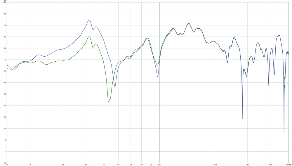

Yes, I'm aware you don't recommend any crossover and I would be happy not to use it. I have done it before and it was great. But this new place of mine gives me a headache.
Speaking of that, does no crossover rule apply to all sorts of speakers? Mine go down do 40 Hz and until now I have never thought this might be a problem when adding subs.
Plots with crossover at 60 Hz are there for comparison as I tried to disable the speaker ports and wanted to see some variations. There are other plots without crossover and there are plots for each speaker as well.

I see no reason to use a "crossover" on any multisub situation. I might in some cases use a 6 dB/oct HP filter on the mains if I felt that they could see significant excursions. But in my system there is no HP as the drivers are all large 15" pro units that would never even come close to excursion limitations in practice. Small drivers have no business doing LFs.
Of course there is always some LP filters on the subs, but seldom, if ever, will they be at the same frequencies as the mains or other subs. The idea is to blend the sources together with as much overlap as possible. Crossovers completely disable this possibility.
If your interest is the effect of ports, then I don't see the need for any crossover or the mains. Just show the subs with and without ports. The mains don't enter into the picture in this case.

Some additional information. My subs are closed design. Mains (with 12" LF units) have ports and I was testing the difference. Looking at the comparison plot opened ports add 6-7 dB at 25-60 Hz area. Not sure if that would make the integration more difficult.
On the other hand, I was testing delay on L/R speaker. Turned out I had to look further (up to 500 Hz) to see delay is not as good as I though in the first place (blue plot: ports open, green plot: ports closed).
What do you think (the plots are in wetransfer link above).

I'd want to start with them closed. (To me that should always be the case for mains used with multiple subs.) Then add some subs and see what happens.
Like I said best would be multiple traces with mono mains, and individual subs shown independently. Then you start tweaking. First try and find the best place for the LP filters on each sub (not the same frequency) and see how they blend with the mains. Then start going lower and lower from say 200 Hz and fix the peaks and dips with EQ. This can be global or individual, but global is easier. I set limited EQ on each sub and then fix the result with some global EQ.

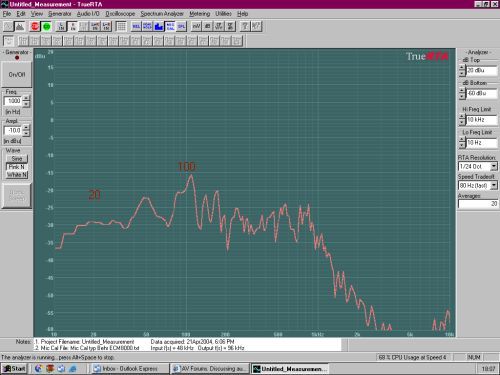

I understand most of the Geddes style multiple sub setup but cannot understand the lack of lowpass filters on the subs ?
Here's a measurement of my old tempest sealed sub at listening position (no EQ /XO). At 800Hz it's louder than at 20/30Hz.
A lot of people run subs a bit louder than the mains (I use the JBL synthesis curves for my system) So their sub could be outputting 800Hz material louder than their mains.
Unless Geddes assumes we're all using AV processors with built in crossovers on the sub channel I'm not sure I get it ?
Rob.
What you are missing is that I have never suggested not using "lowpass filters on the subs". I always have. The question is where! They should not all be at the same frequency. Some sub/positions work better for the upper LFs and thus their LP freq is higher. The idea is to blend everything together smoothly, not abruptly.
"No crossover" is not the same thing as "No LP".
Rob.
Rob,
When Geddes says don't use any 'crossovers', what he is saying and rightly so, is don't put a HP filter on the mains along with a LP filter on the sub(s) at the same frequency. That's a crossover. It simple doesn't work acoustically if achieving a smooth bass response is required in room. One should stagger the LP filter frequencies for the subs and that should only be dictated by measurements, period. Without measurements, this entire exercise is impossible. Now some speakers can get by without a HP filter on the mains and some cannot. In Geddes' setup (and mine, along with numerous others who have HUGE woofers on their mains), running the mains full range is the best option in all honesty. Indeed some fellas have mains with very small woofers and excursion limits are easily hit (along with alarming increases in THD and IMD, i.e. > 10% which becomes audible) and putting a HP filter on the mains makes sense, or honestly, just designing new speakers.
I don't use an AV processor. I use either a MiniDSP or Behringer DCX2496. It provides the greatest flexibility and that way I can let the AV processor do its own thing so to speak. Too many AV processors in my opinion do not have the ability to finely adjust all the parameters needed to get a smooth bass response.
