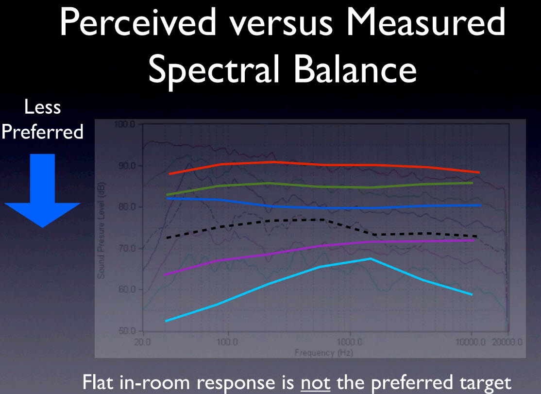

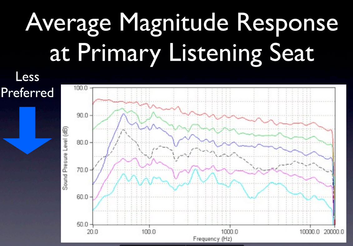

Perhaps the issue is because it is "flat" and that is not the target response according to Sean Olive and Floyd Toole.
Have a look at Sean Olive's, The Subjective and Objective Evaluation of Room Correction Products. There is also a PDF download that you may want to look at.
The point is that a flat in-room measured response is not the preferred target. If you look at slide 24 you can see a downward tilting response as the most preferred by test listeners:
See the top red curve/tilt. Roughly about 20 Hz to -10 dB at 20 kHz is the slope.
If you look at slide 26, to our ears perception, the downward tilting slope is perceived by our ears as flat or neutral sounding - see red trace again:
If you eq for flat in-room response at the listening position, it is going to sound way too bright and no bass...

+1Perhaps the issue is because it is "flat" and that is not the target response according to Sean Olive and Floyd Toole....
Someday scientists might be able to explain why so few folks in the subwoofer forum seem to know this, preferring instead to stick with the naive textbook notion of flat measured FR (assuming there actually is any standard way to measure FR in a room at home).
There is also a continuation of that slope in the treble. Not sure if it has been studied with the same care (including care in pre-testing the hearing of experiment participants).

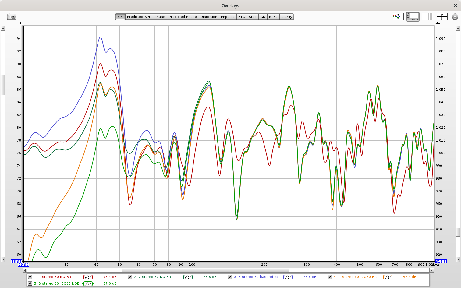

Would you guys care to take a look at these stereo measurements?
Which one would you choose for start adding the subs?

What are your measurements showing, what are the differences?Which one would you choose for start adding the subs?
Thank you for looking the plots.
If you look at the plot descriptions there are more details.
1. 30 cm from the front wall, speaker ports CLOSED, left speaker distance set to 1,1 m
2. 60 cm from the front wall, speaker ports CLOSED, left speaker distance set to 1,1 m
3. 60 cm from the front wall, speaker ports OPEN, left speaker distance set to 1,1 m
4. 3. 60 cm from the front wall, speaker ports OPEN, left speaker distance set to 1,1 m, crossover at 60 Hz
5. 3. 60 cm from the front wall, speaker ports CLOSED, left speaker distance set to 1,1 m, crossover at 60 Hz

While Dr Geddes may be the best person to answer your question, I will say that measurement 1 and 2 are interesting. Number 1 has fewer variations in the above 100Hz region, and number 2 varies less below 100Hz. To me this suggests a more wholesome coupling of the sub and the listening position through the room. Have you considered the advice here to average your measurements?
