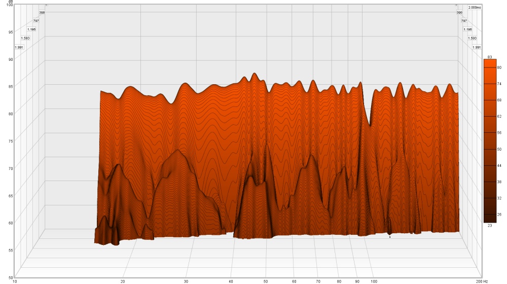

Once I measured all the possible locations for my stereo speakers. The optimal position (according to the FR) was 35 cm from the front wall. That leaves no room for a sub in a corner. If I move the speakers further from the wall, some dips/peaks would get bigger.
My question is if this would be solvable with more subs or is it better to start with optimal stereo position and place the subs elsewhere?

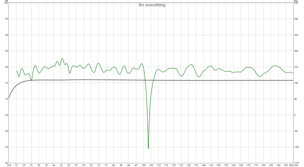

By the way, I did some really quick measurements, not by Geddes method but used an auto EQ option for two pairs of subs at equidistant locations.
No matter what I do there is this huge dip at 103 Hz. It just came from nowhere! I'm pretty sure it wasnt there last time I was doing measurements!
Could you please share your thought on this:
One of my main points with my technique is that it allows one to put the mains where the best performance for HFs (imaging etc.) can be achieved. Then you simply don't worry about what the mains do at LFs, because you fix this with the subs. Hence, it is certainly best to place the mains in their optimal position first.

Hm, I don't know ... if you take a look at my plot I posted earlier ... there is pretty big dip at 103 Hz. I tried to move the mic 40 cm forward and it was way better. So I'm sceptic moving the mic around.
So your Xover between subs and mains, are at a 100hz?Hm, I don't know ... if you take a look at my plot I posted earlier ... there is pretty big dip at 103 Hz. I tried to move the mic 40 cm forward and it was way better. So I'm sceptic moving the mic around.
If so - Geddes wrote that you need to let your mains run lower, so that you get and overlap.
Let's say your subs runs to a 100hz. Then your mains should run to at least to 60hz with a low order HP(if they dont like the deep notes). This could help with the dip. But it could also be a measuring issue, cause the speakers distance to the rear wall playes tricks on your measurement.

The crossover on these plots was set to 80 Hz. But like I said, this was not set by "Geddes approach", I just measured my current home cinema setup with auto calibration system.So your Xover between subs and mains, are at a 100hz?

After that I did some experimenting with RTA. I tried to move the mic a little bit forward and the 100Hz dip got smaller. That could explain this anomaly: during extensive watching in the last couple of years my seats (which are not screwed to the floor) moved backwards and therefore the 100 Hz dip was getting bigger.
