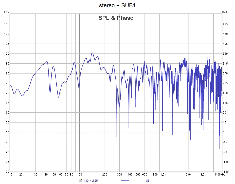

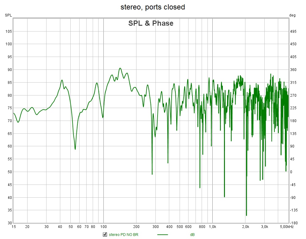

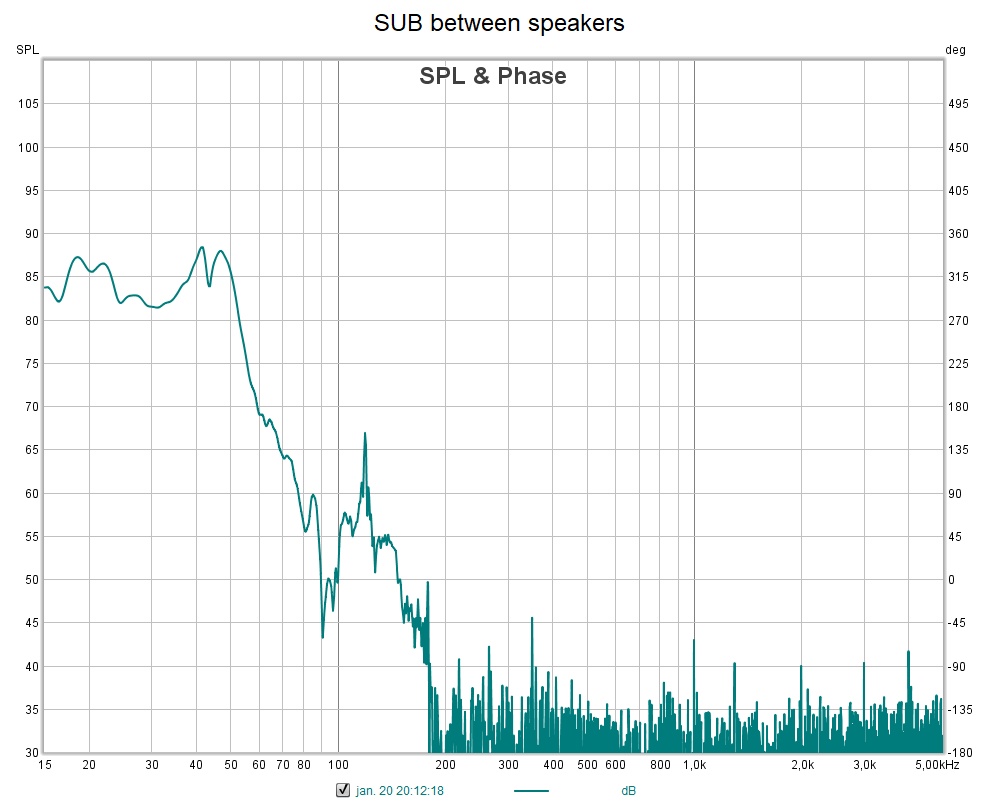

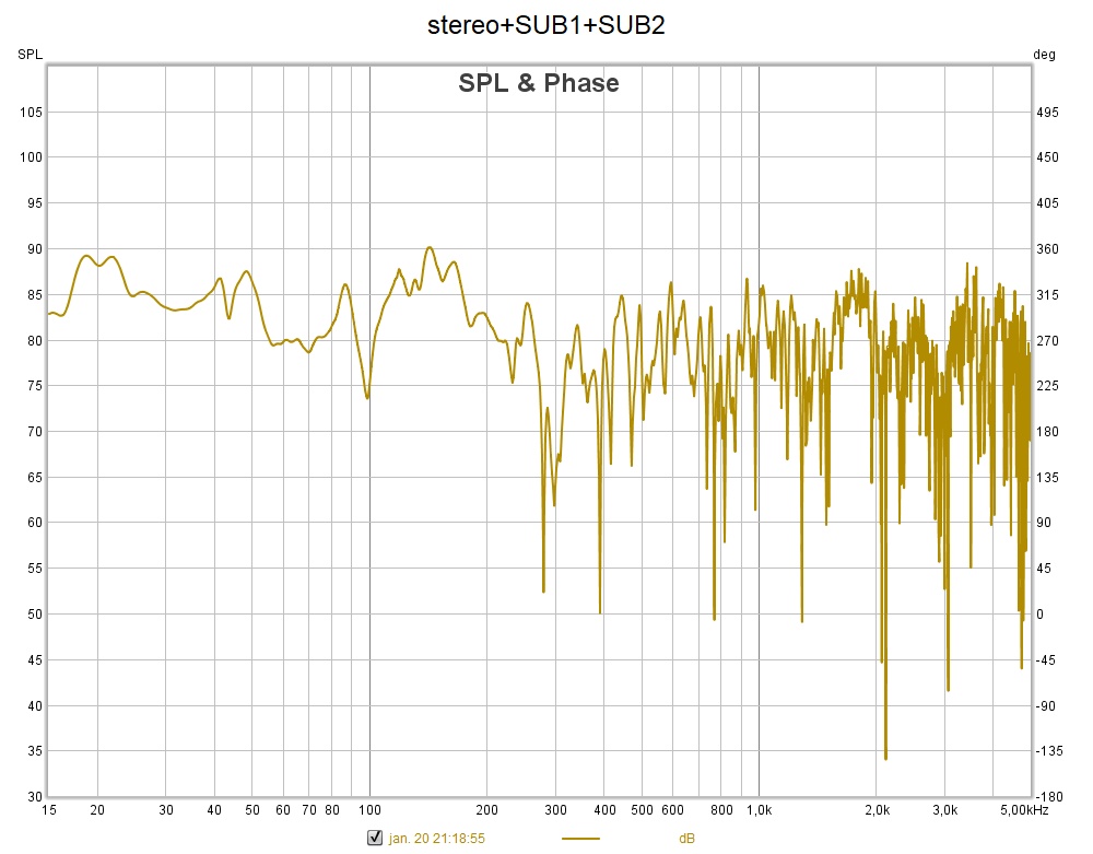

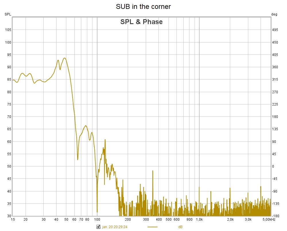

I know corner placement is preffered but I did a measurement in the corner and near the corner (between main speakers). I don't see any significant difference. What bothered me is how the gain is dropping above the 50 Hz area. What do you guys think?
attachment.php
attachment.php

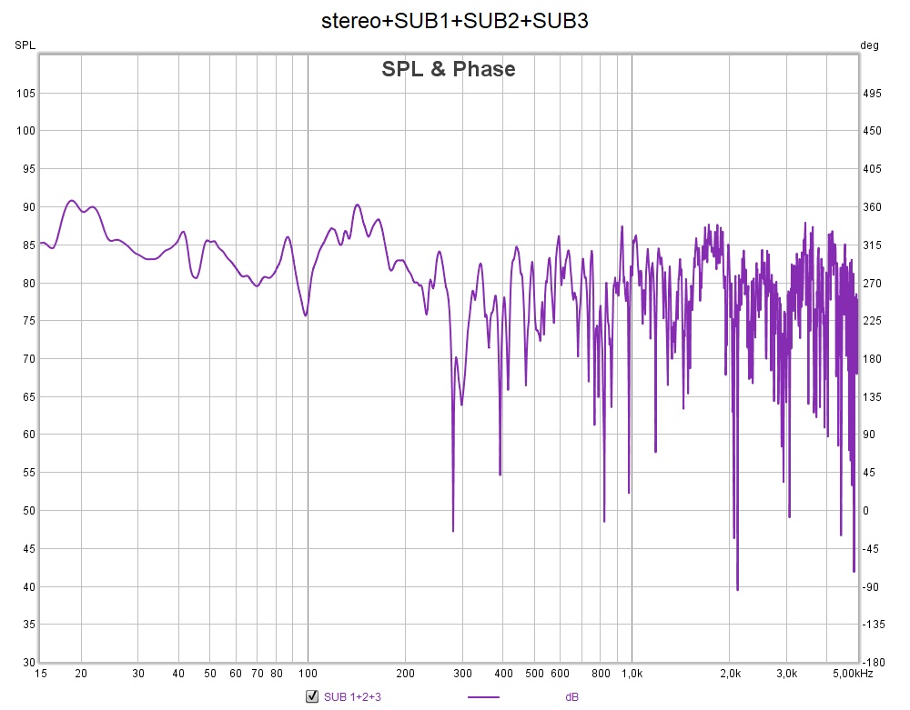

I then proceeded with adding subs. No EQ and no listening test as I have one more sub to add. Subs 1 and 2 are between main speakers, sub 3 is behind listening position.
attachment.php
attachment.php
attachment.php
attachment.php

I would do things differently. I would show four curves on a single plot; mains, sub1, sub2, sub3, not sumed, but each separate. That will tell you which subs should be dominant and which added later, if required.
Your sub 1 for example is not satisfactory as it obviously has some internal LP filter. It may be a great sub for the last sub added, but certainly not the first. The first should have a lot of overlap with the mains. To me, it is obvious that none of your subs is adequately dealing with the mains issue at about 100 Hz, which means that none of them appear to be going high enough in frequency to affect this region. The "modal" nature of the room is quite evident in your curves as the Schroeder Frequency (Fs) is clearly at just over 200 Hz. The subs need to go almost up to Fs. This must be a fairly small room with little LF absorption.
That said, it is obvious that the multiple sub situation is the best of them all, actually down right decent. Just goes to prove my point: it's multiple subs that matter, not so much the EQ or the technique, both of which will just be "icing on the cake."

Yes, room is small, approx 70m3 with mostly 8" damping.
No filters are activated on the subs, I re-checked the settings again.
First two plots (one in the corner and other near mains) are from SUB2.

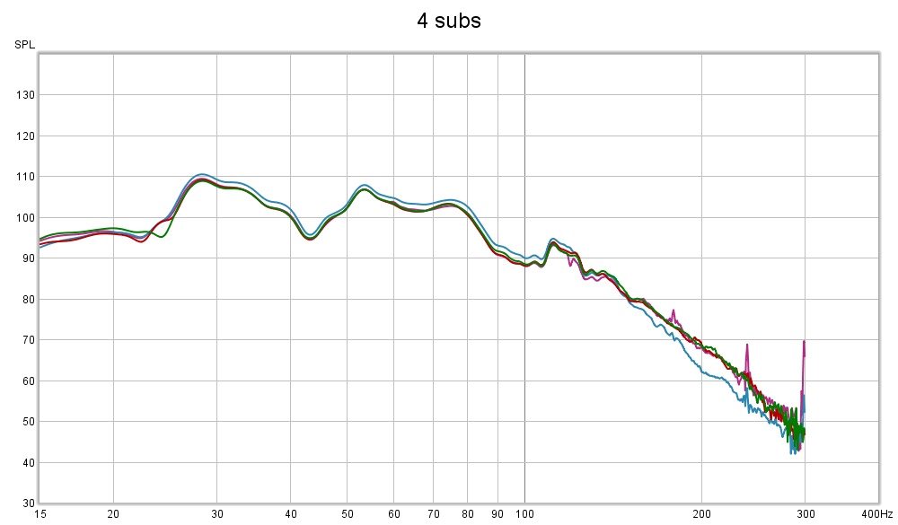

Please, see here, I measured each sub (I have 4 equal subs). I didn't place the mic close enough to the cone so probably room is affecting the measurements. Am I seeing this right - that 45 and 100 Hz are room modes?
Not sure what can I do to deal with 100 Hz issue. Elevate the subs?

No, no. These 4 subs were measured just for testing purposes. To see if they all output the same signal. That's why I took nearfield measurements.

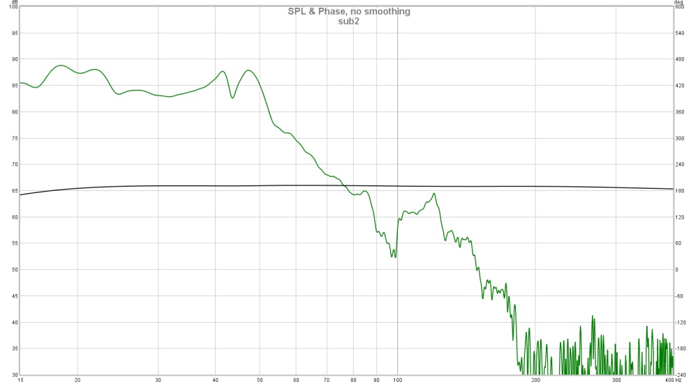

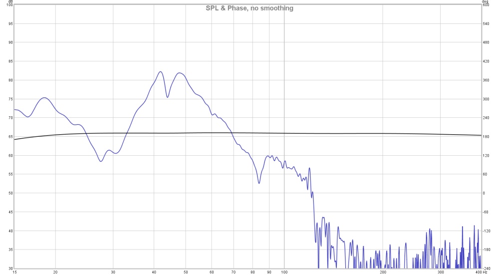

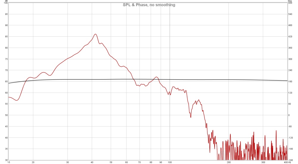

And here are plots for each sub - mic of course on seating position.
EDIT2: you are right, there was a HP filter. I didn't see it. Sub1 now has similar curve as Sub2. Thank you, Earl, I'm thankful you saw that. That's mileage, which I don't have. 😉

Personally I would want at least one of my subs to go above 100 Hz to better overlap the mains and help the mains issue at 100 Hz.
I am unclear how a sub cannot have much above 80 Hz as you show, is it a bandpass design? This is why I prefer just a simple closed box with a big driver. I can EQ this to be whatever I need it to be even up to 200 Hz + if I want. I gave up on bandpass and ported years ago.
This is precisely why I would not use subs with internal electronics. Those curves show a huge dependence of FR on level and this will pose serious problems with what you are trying to do. They also show a very limited output response above about 80 Hz - not what you want. I'd use different subs.
