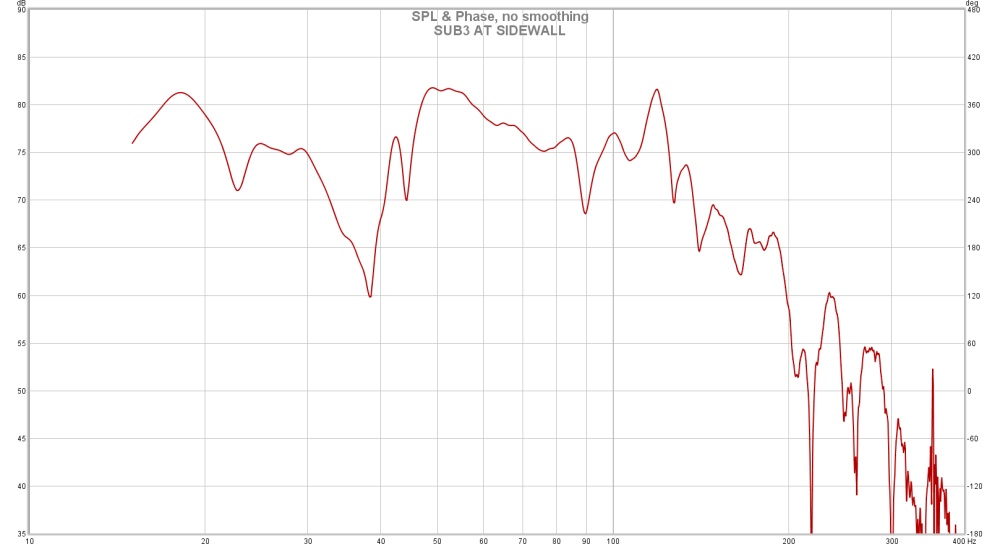

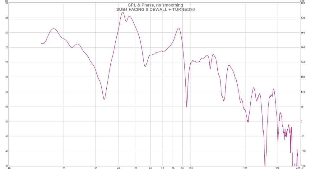

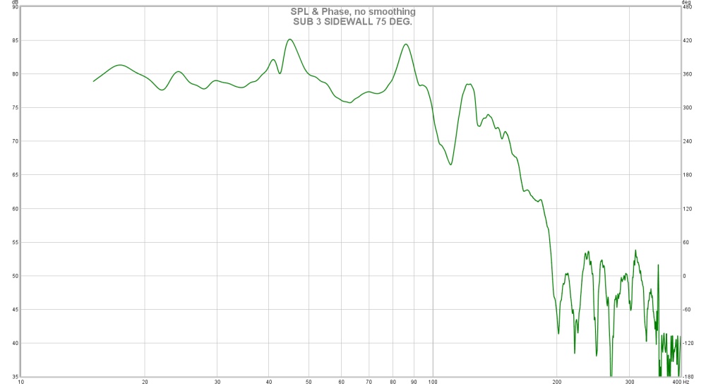

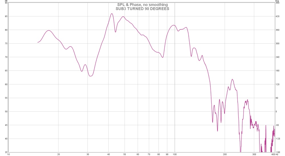

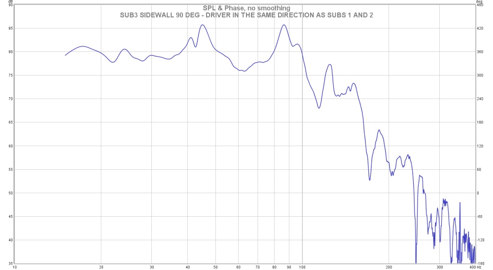

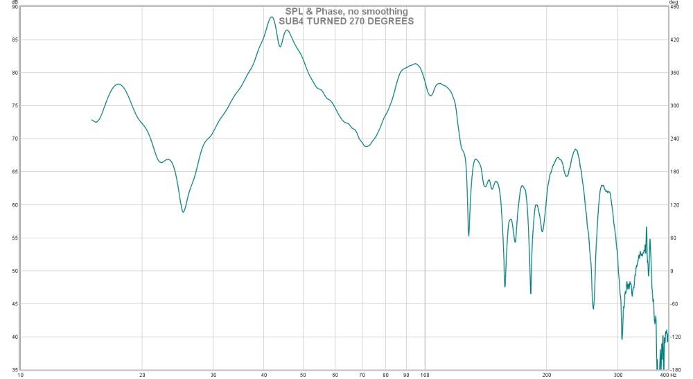

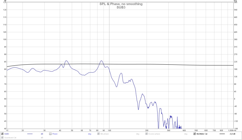

Here, a little experiment with Sub3. Interesting! Never see or read turning the sub could make such a difference.

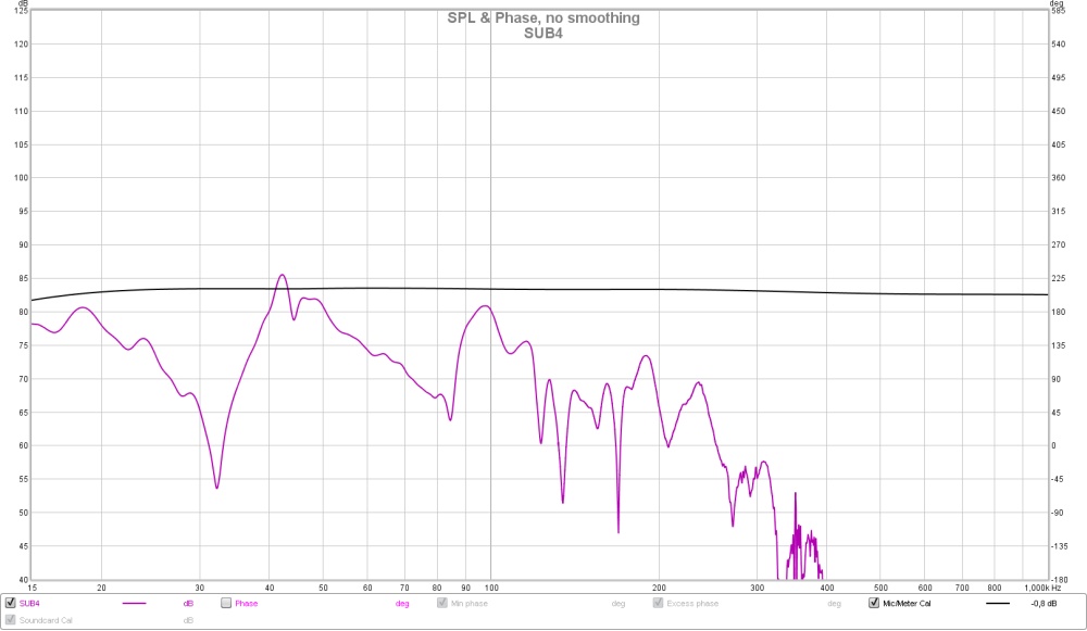

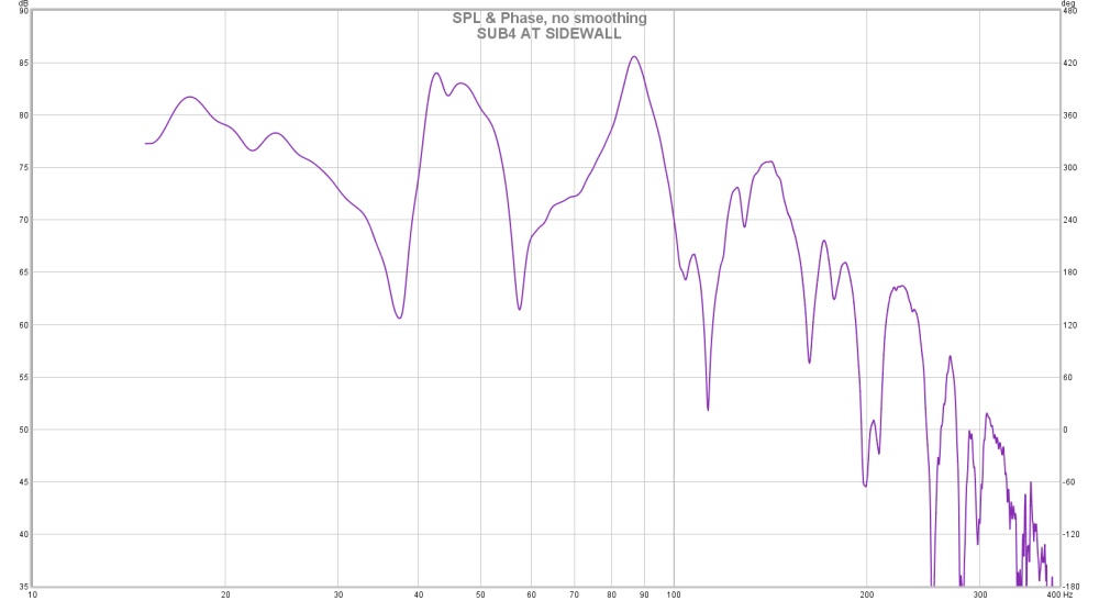

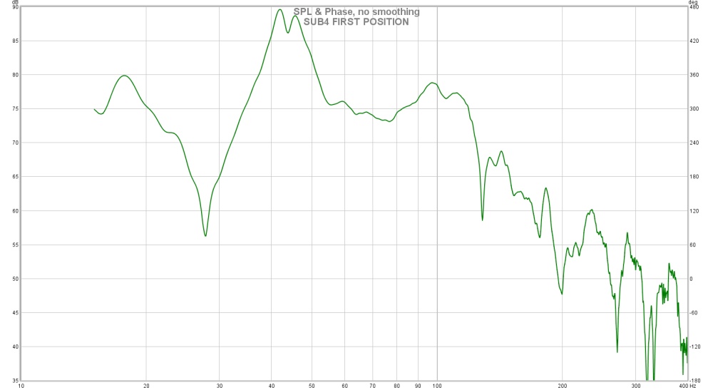

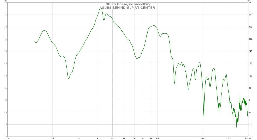

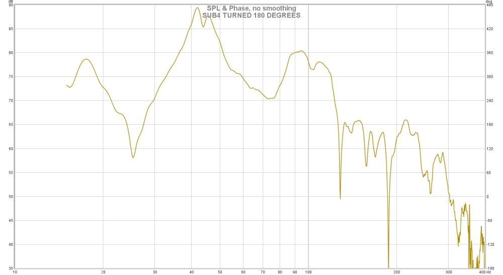

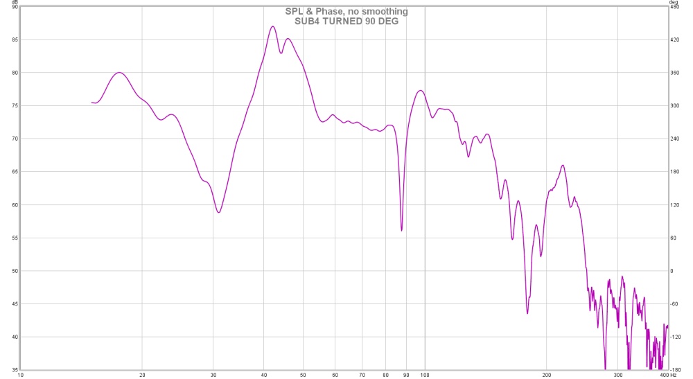

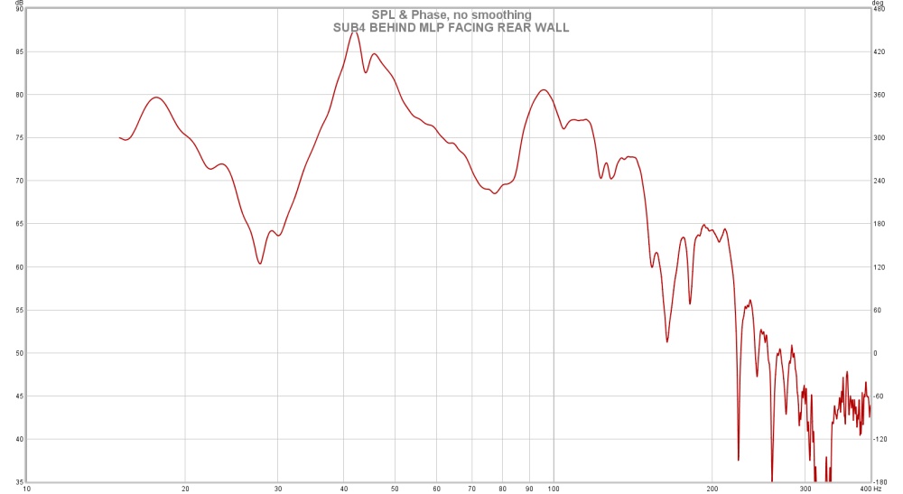

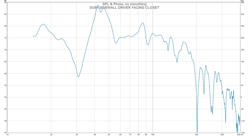

SUB4 at different locations.
Looks like the last measurement is the best altough moving the sub4 didn't come out as good as sub3.

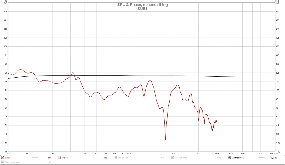

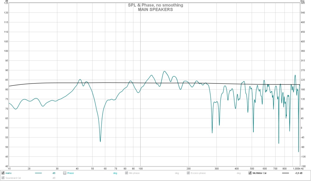

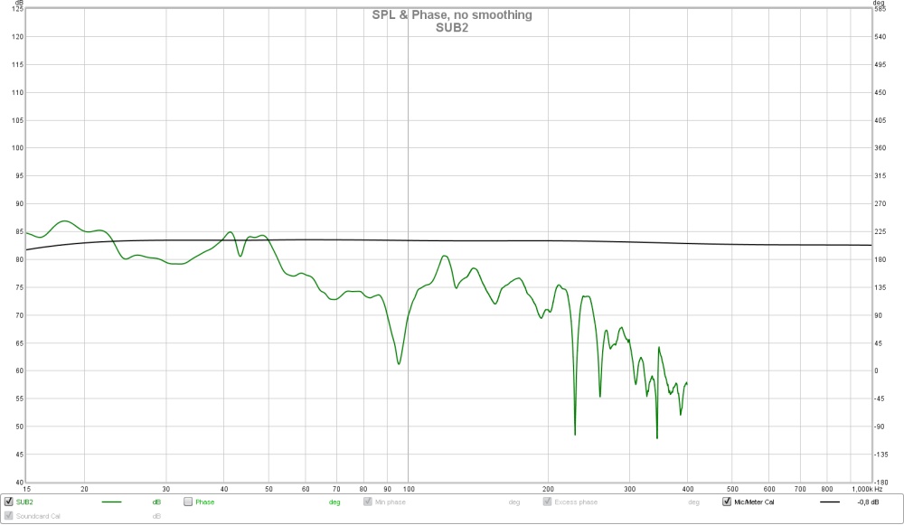

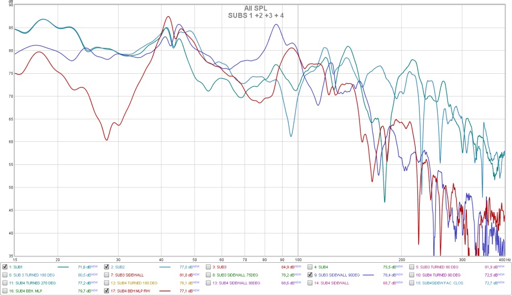

OK, here are now 5 plots:
Each sub separately + mains.
No filters.
I think this does not look good.
Dip from 50-70 Hz is giving me troubles.
I'm afraid different sub placement might be in order but I'm running out of options.
No filters.

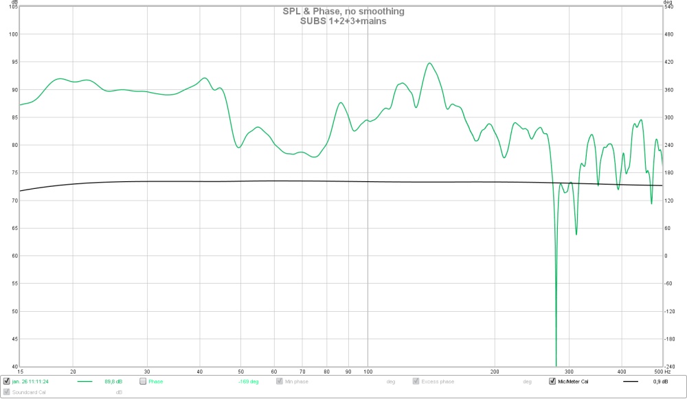

Earl,

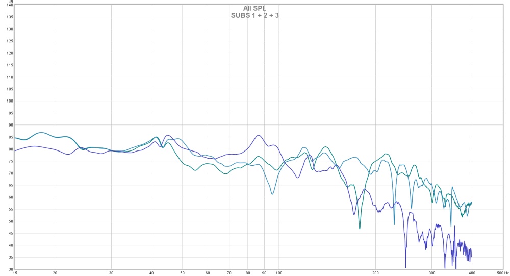

Here are subs 3+2+1 + mains.
Perhaps a stupid idea: would it make sense to EQ 20-50 and Hz area and then raise the gain?

I would be tempted to lower 80-200 (low Q bandpass) and then just the bump at 40 Hz. Maybe lower the overall gain of the subs, except that at 70 Hz the level is just right, so maybe a small -5 dB on the bass control.

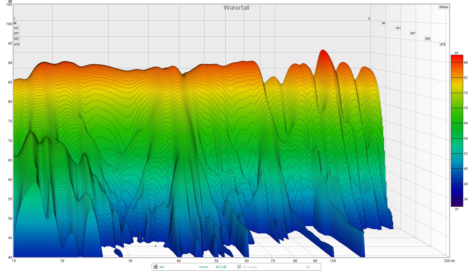

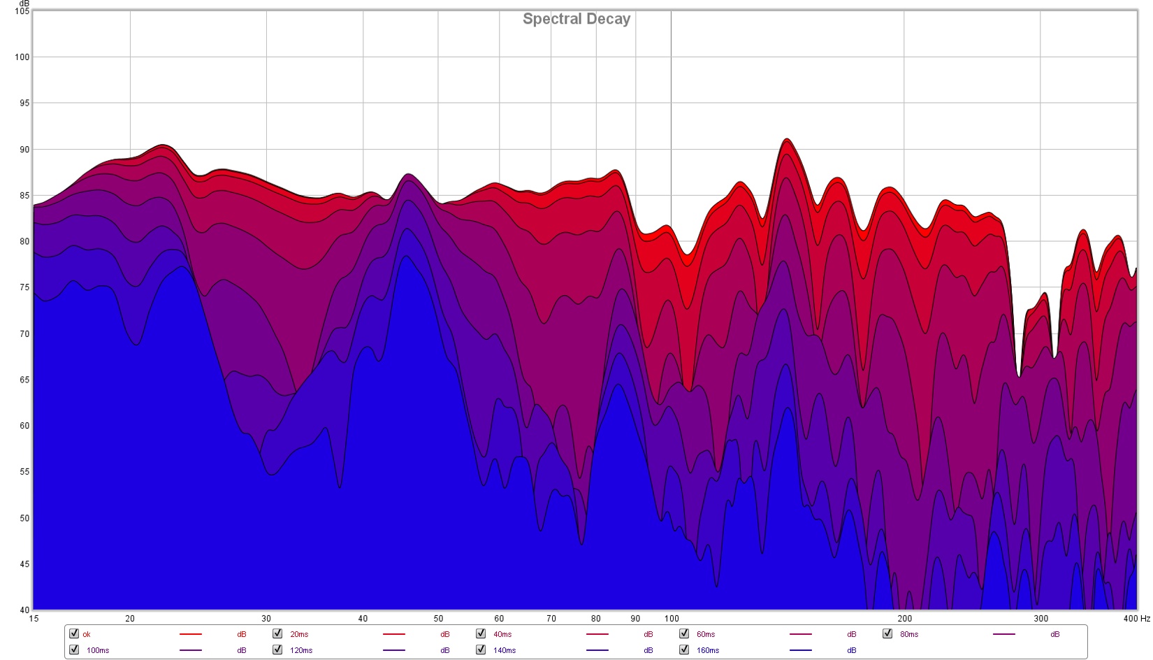

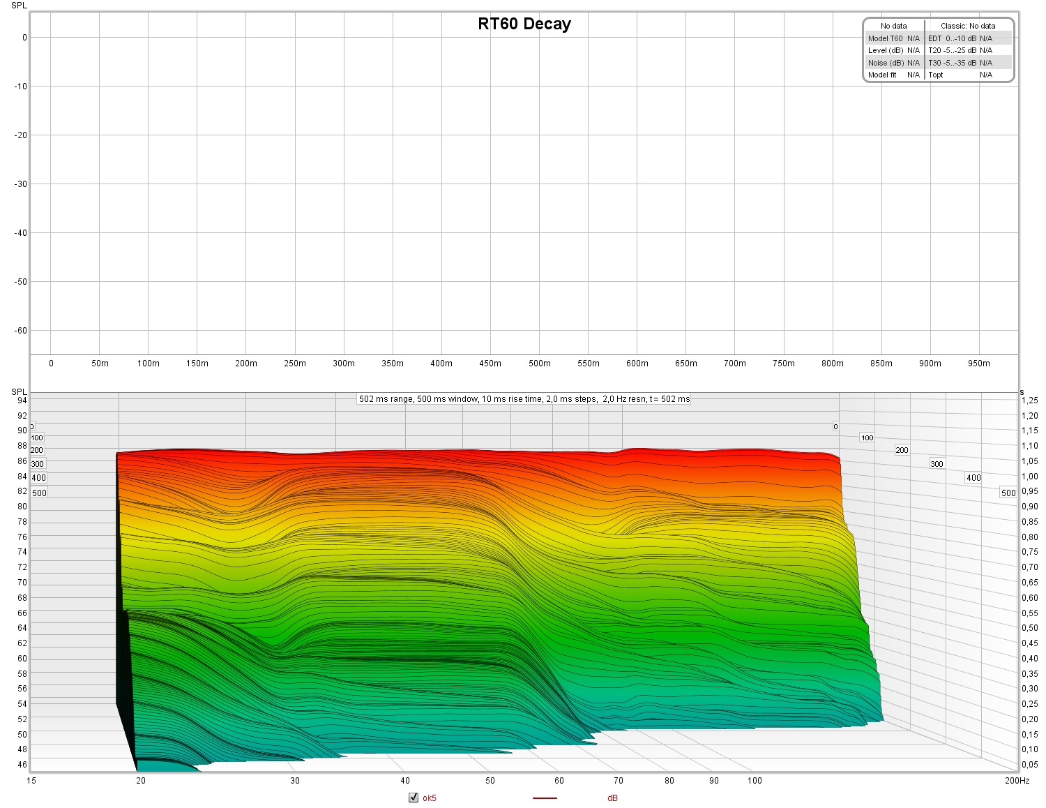

Before you replied I did some more work. Added one more sub in the equasion.
Turned out I got a decent FR but awful ringing at 40-60 Hz area (up to 600 ms).
Do you think sub positions are crucial in your method? I know you said you placed where you had space.
I'm asking this because couple of years ago I tried other sub positions which resulted in slightly worse FR but better decay times. That could mean placement plays an important role in the integration process. Does that makes any sense?
It sure is worth trying.
600 ms at 40 Hz.!? Seems implausible to me. 40 Hz will leak out of every small opening in the room. Is it a concrete bunker? How do you even measure the decay time?

Position should have nothing to do with ringing. The location of the source only affects the amplitude at which it resonants, but cannot affect its Q. Hence, no, position will not affect decay time.
I'm still unclear on how you determiner decay of a mode. From a waterfall?

Yes, ringing is visible on the waterfall. Or decay plot. Please see the picture and observe the 40-60 Hz area. That is probably the cause for lousy bass.
Why am I suspecting positions? I don't know much about acoustics but I'm guessing if there are room modes and if a bass source is placed in a proper place it could help with the mode. Probably that's why you are placing one sub in the corner?
I'd want to see a cut through the 20 Hz line. I'll bet that there is a rapid decay and then a rise. This means coupling of this room to some other place as the wave energy comes back into the source room.
I should think this a good thing at LFs (this may also not be true, it would need to be tested psychoacoustically) because it has a real mixing effect of the total sound wave directions etc. This coupling is now decorrelated from the original sound source. Good thing it appears only in the range up to 30 Hz. Two similar sized rooms weakly couple together might do this.
But, back to the point, the initial decay is what I am talking about. The later coupled sound arrival would very much depend on the sources location relative to the major coupling between the rooms.
PS. All the other resonances in your plot look normal - straight decays.

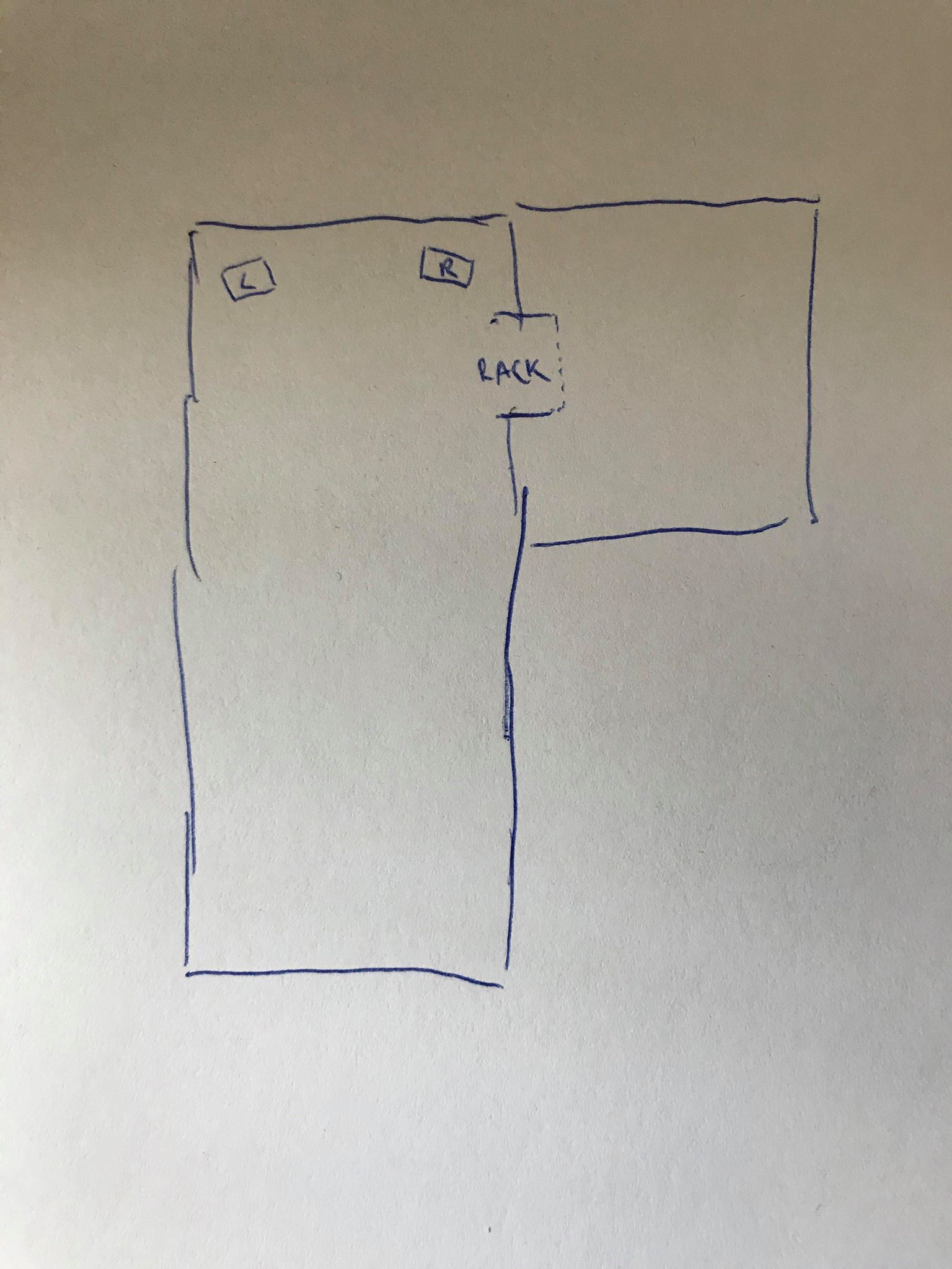

There are no similar rooms nearby. Can two rooms get coupled even with solid concrete walls? What to do in such cases?

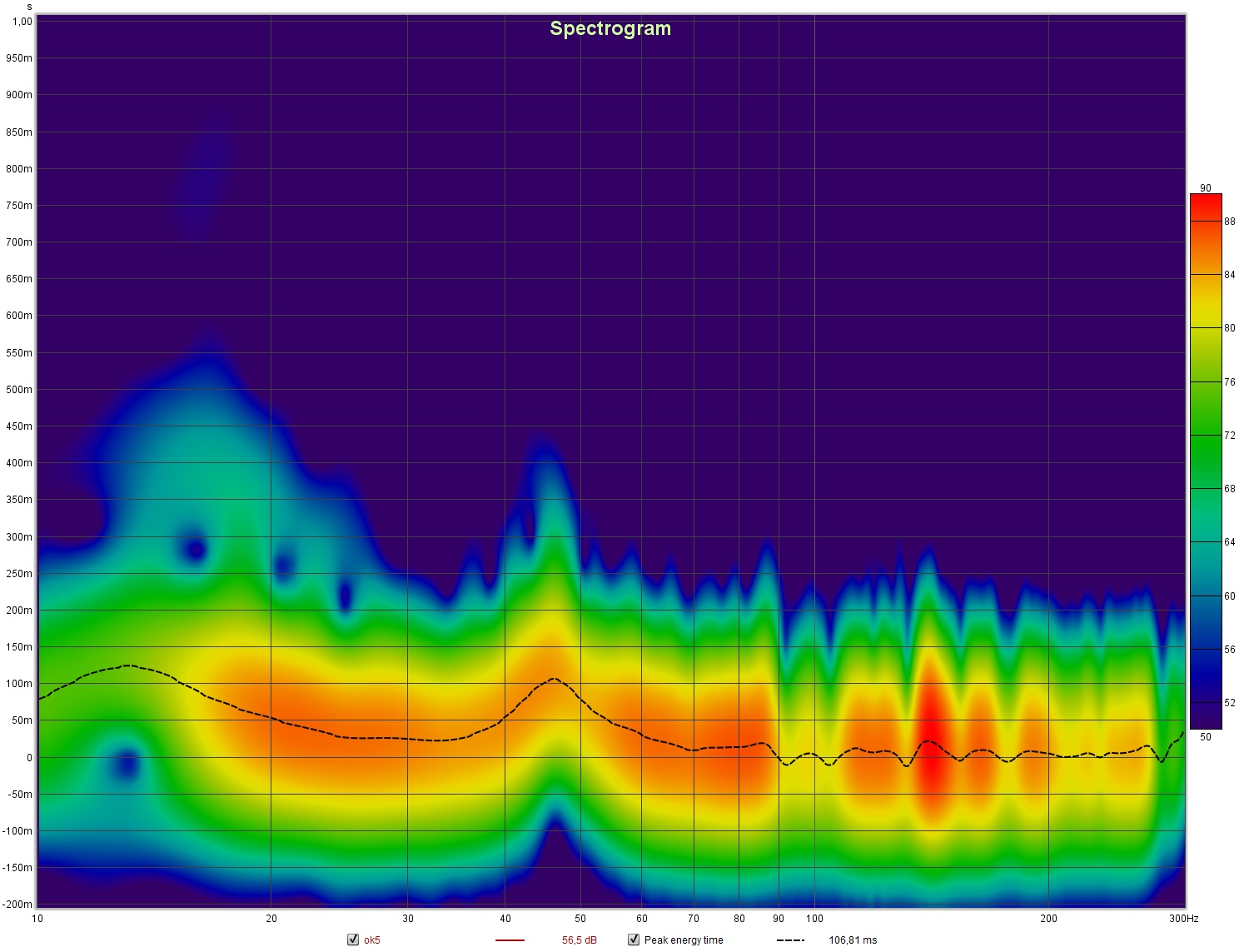

Is this plot helpful?
Those are all normal and those rates of change all indicat a T60 (as if that term applies here) of about 250-300 ms. I surely see a lot of LF energy coming back into your room from somewhere.
By "cut" I mean a plot of SPL vs. time at 30 Hz. It will fall to about 250 ms. then some other energy arrives pushing up the level and then falls again. This energy is probably 15 dB down from the direct sound, so its not large, but at these long decay times you can see these effects. I would guess some kind of giant Helmholtz resonator - f0 in the 15 - 30 Hz range - is coupled to your room. It's likely low damping. But heck, at these frequencies I just would give it much consideration.
Could this mean a panel has soaked up the energy and is re-radiating it, or that it actually left the room and returned?I surely see a lot of LF energy coming back into your room from somewhere.
Yea, that's certainly possible as well. Good thought. Both are possible.
It goes somewhere where it takes some time for it to accumulate the energy and then it passes it back. Could be mechanical, acoustical, ducting, ...

Now that you mentioned coupling. I have a rack hole that can be opened in the other room (much smaller, but same width). It is covered by a wooden doors on the back.
I thought this might be a problem so I tried covering it with absorbers (on both sides). No particular change.
A while ago someone else indicated this might by a resonance from the outside but I didn't take it seriously. Now there are two of you it makes me wonder what can be done here. How to check these things? And what is the difference between a room mode or a "coupled resonance"?
