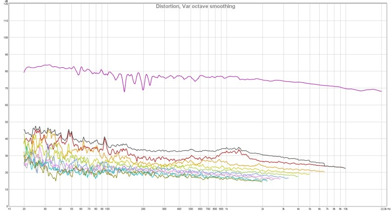

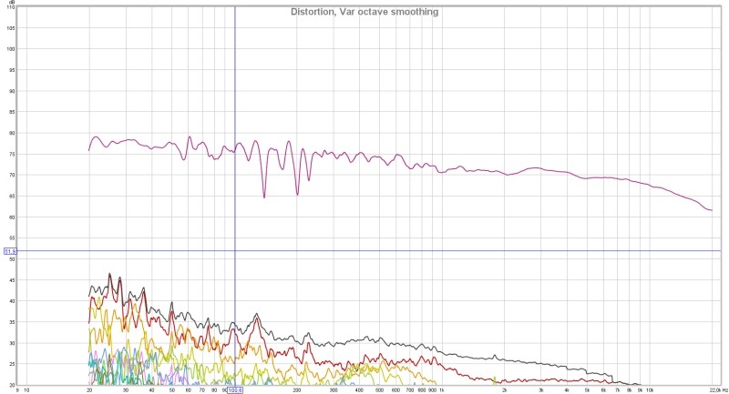

With a lot of room to move...
But the distortion graphs don't look encouraging though.

To me, excursion = distortion.
Xmax, I don't care as much about.

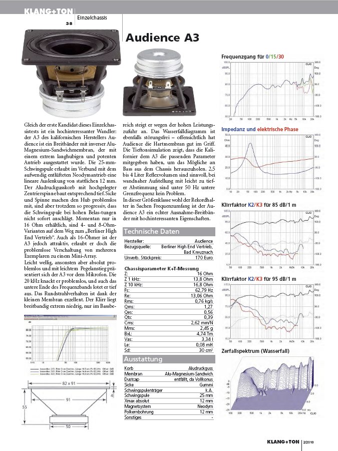

Audience a3.

Not in the real world on a tiny baffle and full space losses below 250 Hzdistortion when single driver used and expect it to produce 40hz
when used multiples of them sharing power together, used xmax will be less and each driver operate at low power so lower distortion.

for rising and extended highs, one could use the Faitals and make a line at a fraction of the A3 line price.Pricy drivers though.....
Audience a3.
Very good drivers, the Faitals. I'm sure they would give the A3 a run for that kind of money.

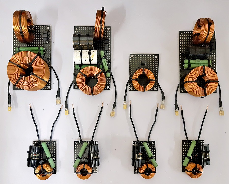

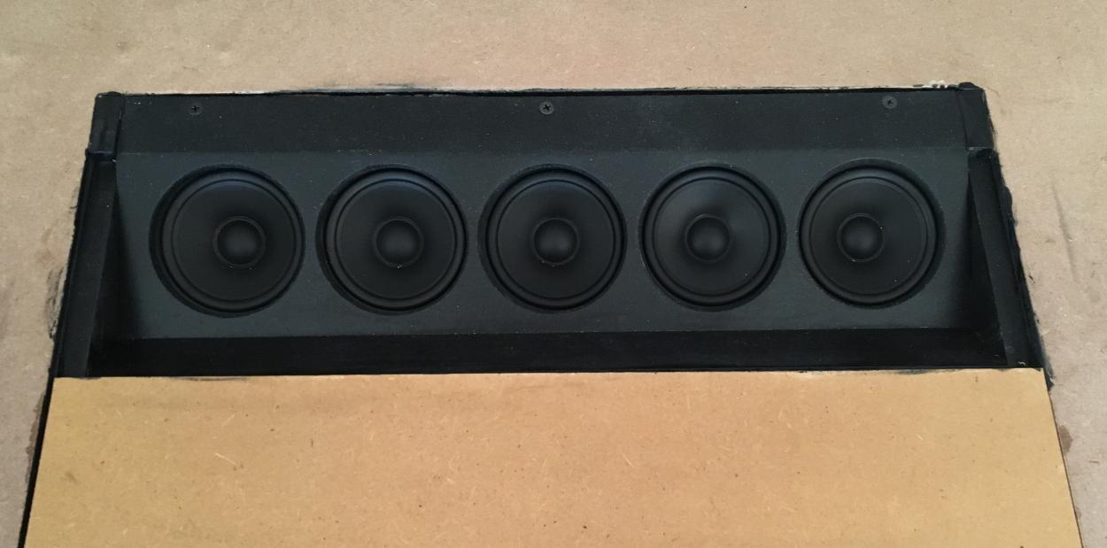

Here's some ideas of using multiple drivers, all producing bass, but only one treble. The one on the left is my traffic light speakers, with one driver facing the rear, the middle was an idea for a floor stander, and the one on the right is the quad cube.
It looks like this in a schematic:
So it's still a 5x5 series/parallel but with a few passive parts added in the mix. Due to having one of the driver groups split up (5 center drivers with a group of drivers around it, 3 below and 2 on top) I added some extra notches to keep it mostly symmetrical around 3 -5 KHz.
(above are the filters used in one array, below are the notch filters, two of those for each array)
I started with an unfiltered 5x5 driver series/parallel and added the filters as best I could to make the vertical pattern control as tight as I could. You could do even better when starting fresh with this goal in mind 🙂. I have done a few schematics like that for fun.

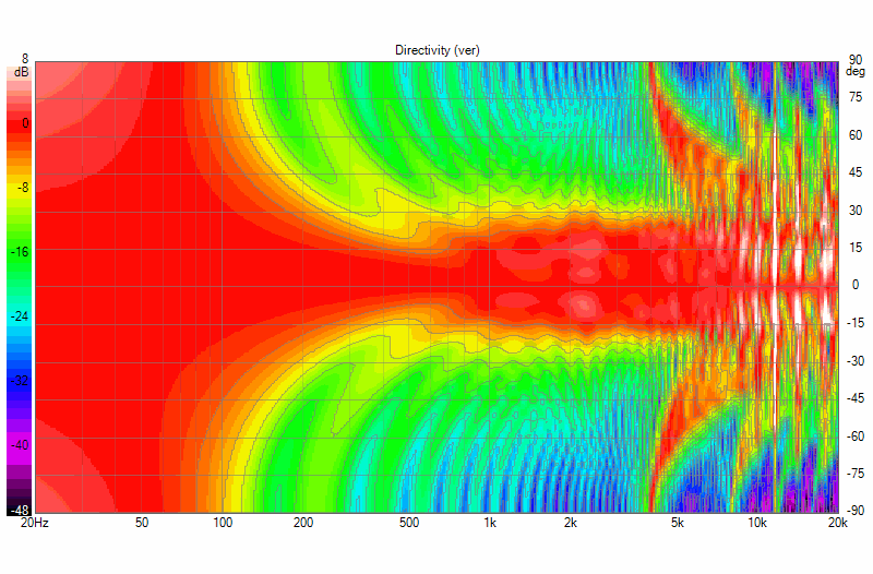

The vertical pattern control of the filtered array compared to an unfiltered array:
I wanted a wide enough vertical coverage to be able to listen sitting down and standing up, something an unfiltered array does quite well.

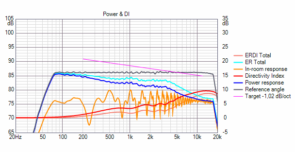

People are always afraid of comb filtering in an array. What they don't realise is how much the room causes combing with even a single driver playing. This, plus the fact that Stereo listening is always causing a comb filtering at the ear due to the left speaker reaching the right ear and vice versa. So the combing that does exist in an array like this, while it is doing something (as you need boost to get it up in level) it's not nearly as detrimental as some will have you believe.
Looking at the in room frequency response of a single driver compared to a (filtered) array with floor and ceiling reflections added makes this clear:
The orange line is predicted "in-room" results with floor and ceiling reflections added at a level of -6 dB (quite a realistic number).
So which one has more comb filtering going on... the magic word with arrays is averaging. Averaging of reflections to be more clear.
Along the same lines of making a multi point measurement to take out the room, each driver has its own position, relative to floor and ceiling.
When you combine them all, you average out the effect of floor and ceiling reflections. The more drivers in the array, the better that result becomes.
Up to a limit of course, as the geometry has to be right to make each frequency sum at the listening spot. The filtered array does a better job at that.
It's still not perfect, but quite a fun compromise. The hard part is to land on the right tonal balance, as you have to draw your own. You can't make it flat anechoic and put it in the room as we do with a "normal" speaker, as in this case the room is part of the mix.
Get it right though and it will be surprisingly clear with a lot of potential.
Setup right (making sure parallel planes are treated) and with the right EQ to back it up, it is a fun but above all, potentially loud and clear speaker.
And with the right driver and positioned so the room helps out, it can make bass too.

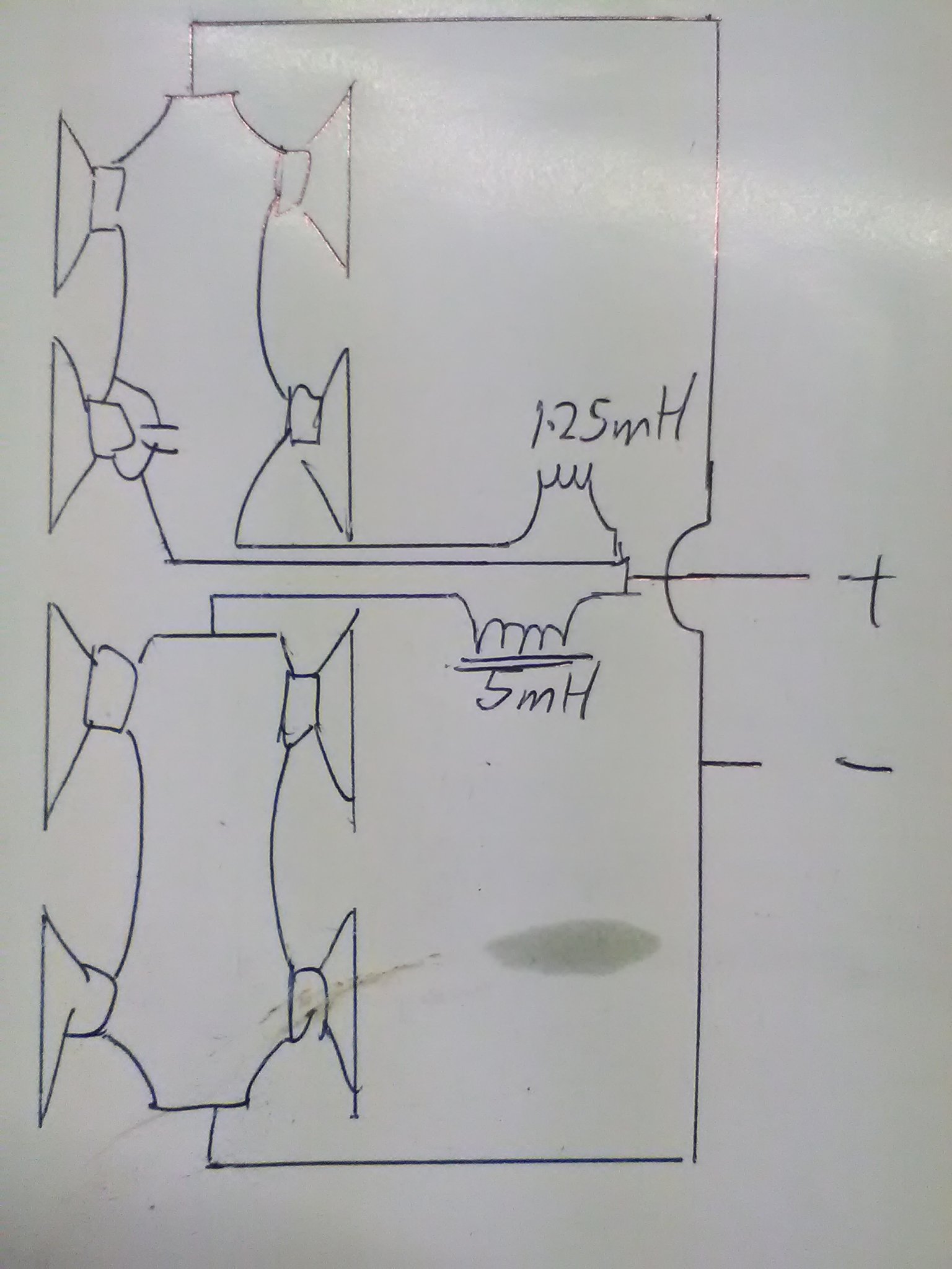

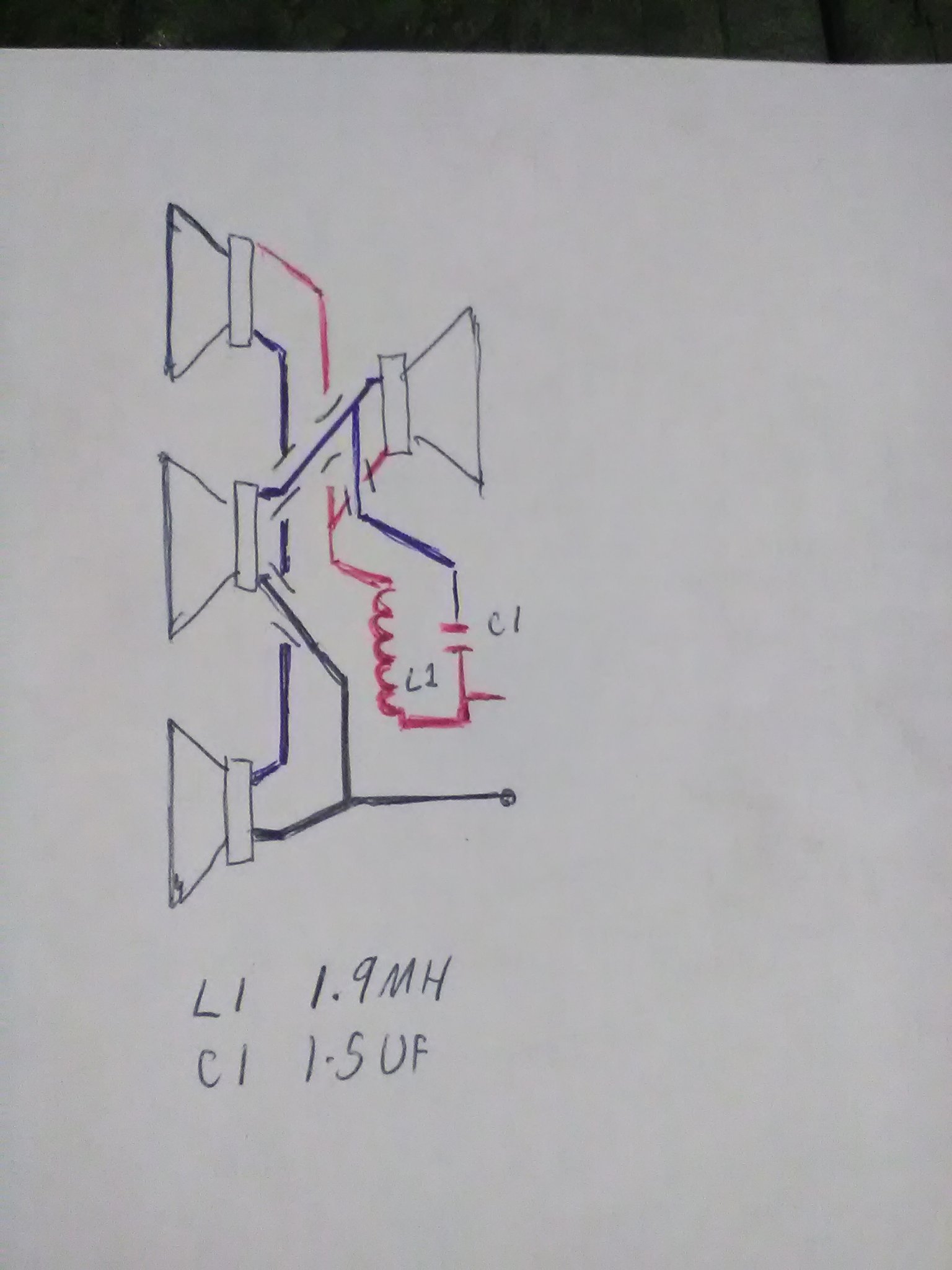

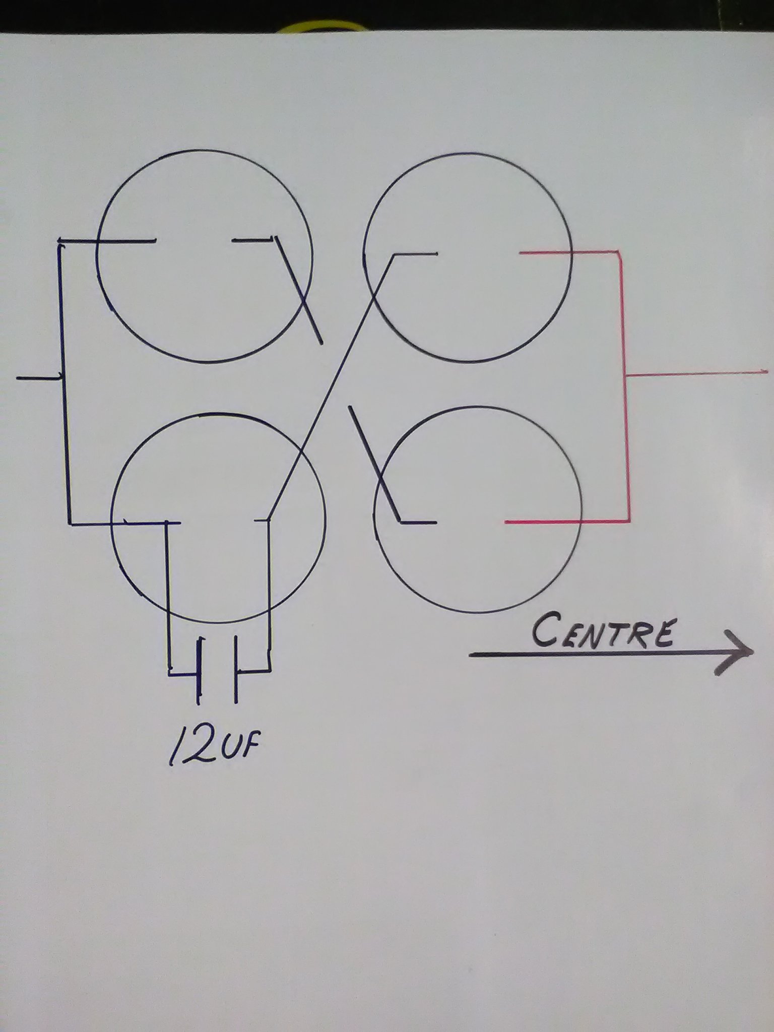

Late to the discussion, but I have built several speakers with using all the same small drivers but not all playing the same range. Here is one example.
In this the center driver is the tweeter, the other four drivers are the woofer. IIRC the crossover was first order, but I don't remember the frequency. I've also done this same array with the "tweeters" as the driver on the ends - either center or outside, depending on how I wanted it to sound. It all blended well enough and the crossover was easy, but there was no way to get it to play below 100Hz, so a sub was used.
