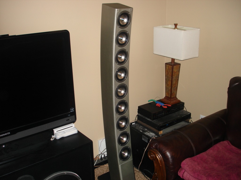

Hart audio uses lots of small bass drivers in the rear of their speakers, and some (octagonal fronted) ones look well cool. If you had aperiodic damping and a little boost bellow resonant frequency, would the high f3 matter? 8 drivers (per side) per side could handle a lot of power. Surely the main limitation of small drivers is their small x max?

If you use multiple small full range drivers, you'll have the advantage of the cone brake up of a small cone, but the cone area/sensitivity of a large one, plus of you use caps to bias the treble to one driver, you have the beaming (or lack of it) of a small cone, all without the phase issues of a crossover, or the change of dispersion from a cone bass driver to a dome tweeter. The best speakers avalible may by cone bass/mid, dome mid/treble with complicated crossovers, but for someone enjoying a bit of diy (like myself) multiple cheap Amazon drivers is a practical solution. Yes, I have "the gene" that makes me want to do things differently, I'm not going to say that it's the best way, but I'm just curious to try it. Perhaps it would be cheaper and better in the long run to invest in some decent drivers and build ONE well engineered design from a respected designer, instead of multiple weird things, but coming up with weird ideas for speakers keeps my mind occupied in an otherwise dull, monotonous life.

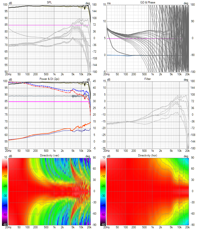

He is using 8 of them for low, that could squeeze out some more lows with EQ, 40Hz seems feasible...What perceval said.
This will not go low. You might squeeze 70 Hz with a big horn. And a phase plug in such a small driver? Looks good but not that functional.
I’d stick with something known. Unless they are dirt cheap and you just want to play with them.

I would make massive line array with this speaker like wesayso did (25 driver line array)
https://www.diyaudio.com/community/...ers-a-25-driver-full-range-line-array.242171/
He wants to use 8 per line, 4 for bass, 2 for kids and 2 for highs.He is using 8 of them for low, that could squeeze out some more lows with EQ, 40Hz seems feasible...
I made a small 9-driver line with 3" drivers, and if pushed lower than 80Hz with EQ, distortion was audible.
I would buy one or two drivers and test it out, before buying 50 drivers of unknown origin.
Where 25 drivers help out in the low end,
20 drivers work together to do the mid frequencies,
10 play up to about 7 kHz,
and 5 do the top end.
