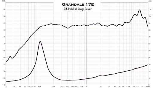

this driver has Fs at 110hz and been used in line array model G7 ( https://www.grandaleaudio.com/grandale-g-7/ )
now I plan to use these drivers in a floor stander but not as line array. Instead I plan to use 8 of them as woofers in a sealed or ported box to handle below 300hz. two of them as mids to handle from 300-3khz. then use two drivers as tweeters. one in the front at ear level and one at top as ambience tweeter.
will such a configuration work? I am guessing this configuration is called 2.5 way??

I think its interesting concept which should work just like conventional 3-way. The only disadvantage I see is high Fs of that driver. Even if you have 8 of them doing low-end you wont be able to achieve deep bass.

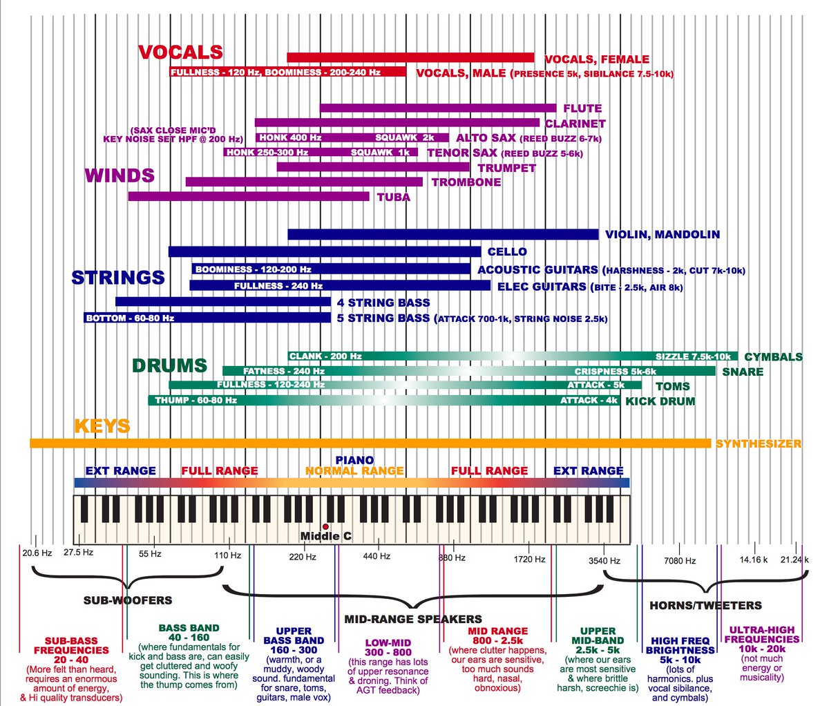

looking at below chart, I understand our ears are most sensitive in mid range and upper mid range (ie from 800hz to 5khz). This range I want to cover using two mids. for freq above 5khz, I could add a super tweeter I guess provided I can find one with impedance match with mids so that I can use just one small capacitor. Then it can look like a MTM configuration. using a tweeter at 5khz, I hope will avoid any lobing issues and let mids do their job cleanly.
And as mentioned, 8 woofers will cover lowest possible freq to upto 800hz.
So one inductor for woofers at xover of 600hz with single order rolloff
one capacitor at 600hz and one inductor at 4.5khz or so for mids
one capacitor at 4.5khz or so for tweeter (3/4" tweeter or super tweeter would suffice I think)

4x 3.5" drivers will not give you bass. Unless bass around 100Hz is enough for you. Lower than that will not have much impact, and if pushed, distortion will rise quickly.
There's not much data, but that deep cone will probably beam very early, so the highs will drop as soon as you move slightly away from on-axis.

This will not go low. You might squeeze 70 Hz with a big horn. And a phase plug in such a small driver? Looks good but not that functional.

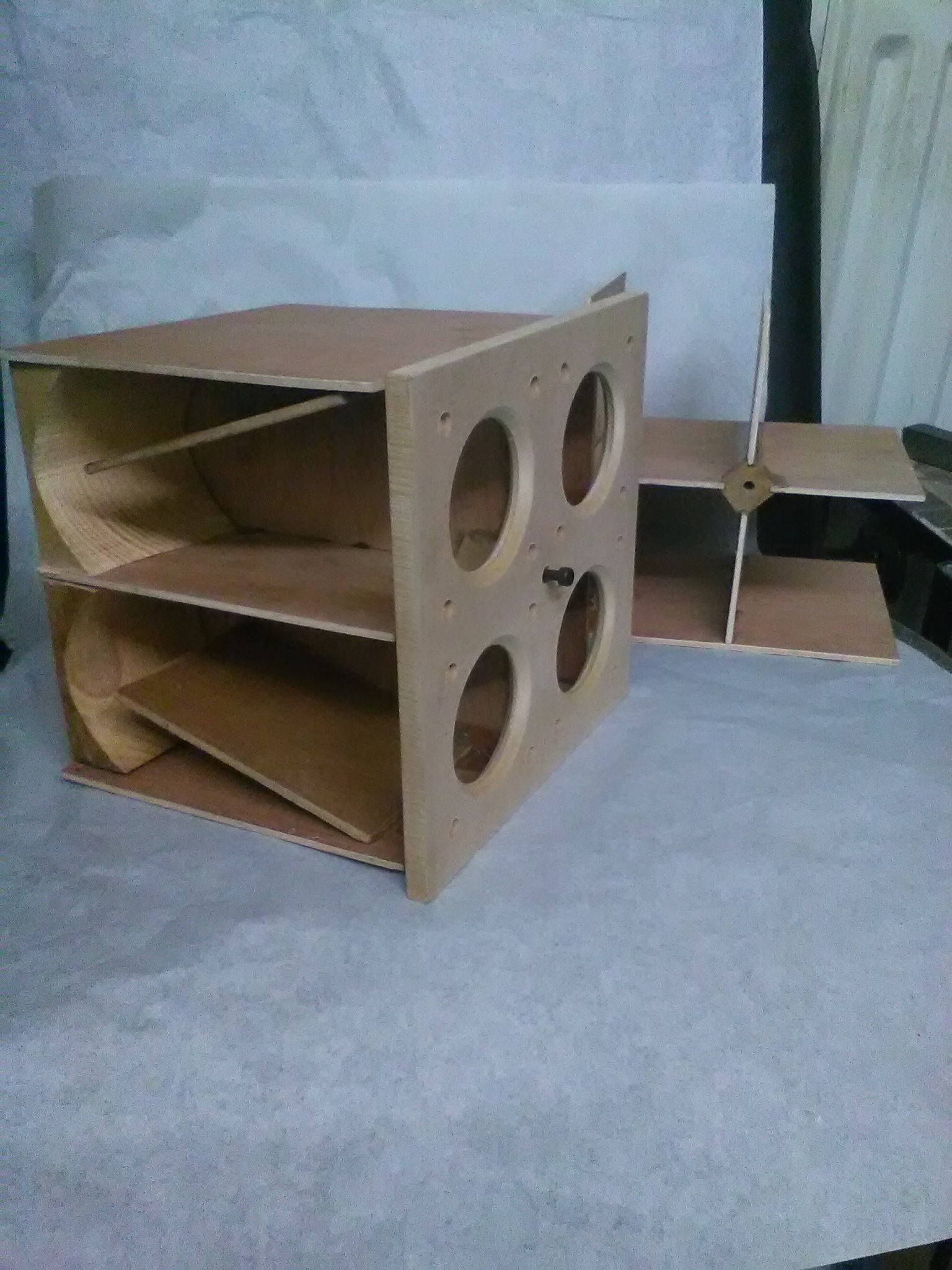

What if you had 4 for bass, then 4 more full range, with three cut off above 8,000 Hz, and let the peek in the last one fill in. I have used multiple full range drivers, mostly two per speaker, wired in series, with a 1.5 if cap across one to bias the treble to one driver. I've also used four drivers, in my traffic light speakers I used three in the front and one in the back, with treble biased to the middle front. In my quad cube (pictured) they're wired in series/parallel with one cap to bias the treble to one, disspite 4 drivers, there's no beaming; you could do the same, just with the addition of 4 more (or 8) to augment the bass.
