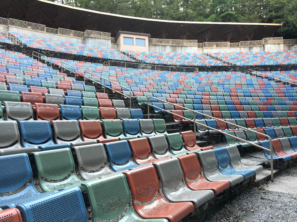

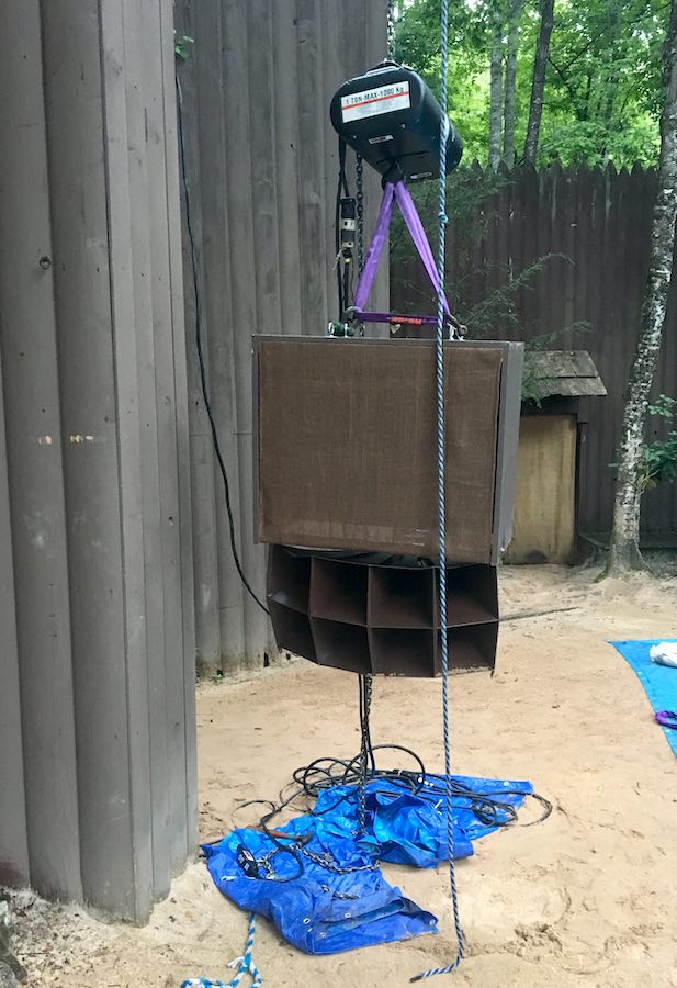

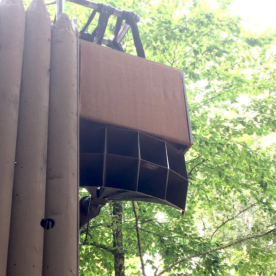

FWIW here are some pics of the Brown Bomber in action. The Altec multicell horns take spray paint very well. 🙂
They fly about 20ft off the stage and throw to the center of the theater is 94 ft.
As far as I've been able to determine, I'm running about 8 volts RMS on the horns (16 ohm) and 28V RMS on the 18" woofers (8 ohm) in the boxes above the horns.
Also included is a photo of the seating area. My mix position is all the way at the top, behind those two closed windows.

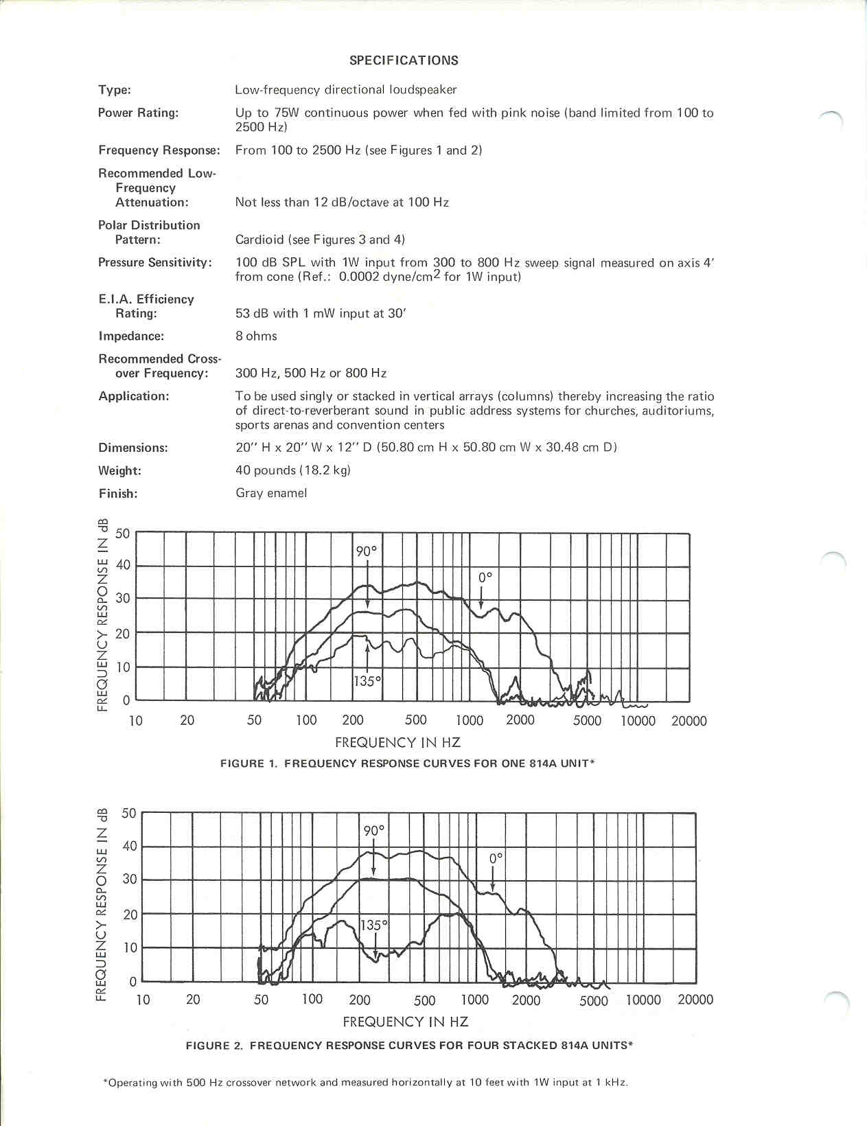

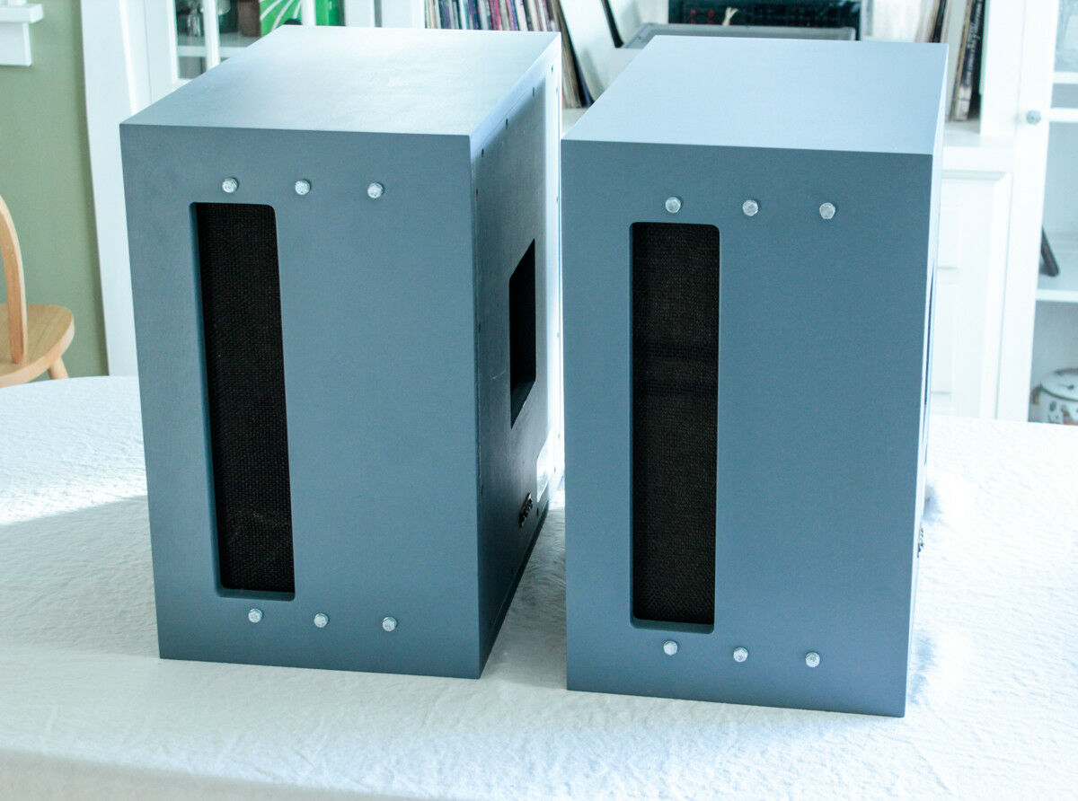

Thanks for the pics Pano !

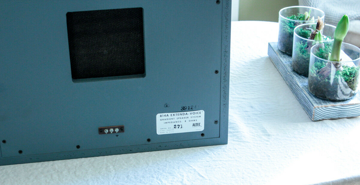

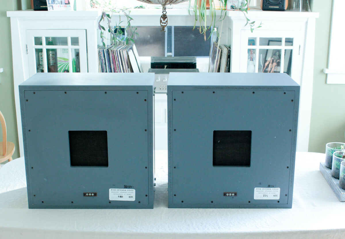

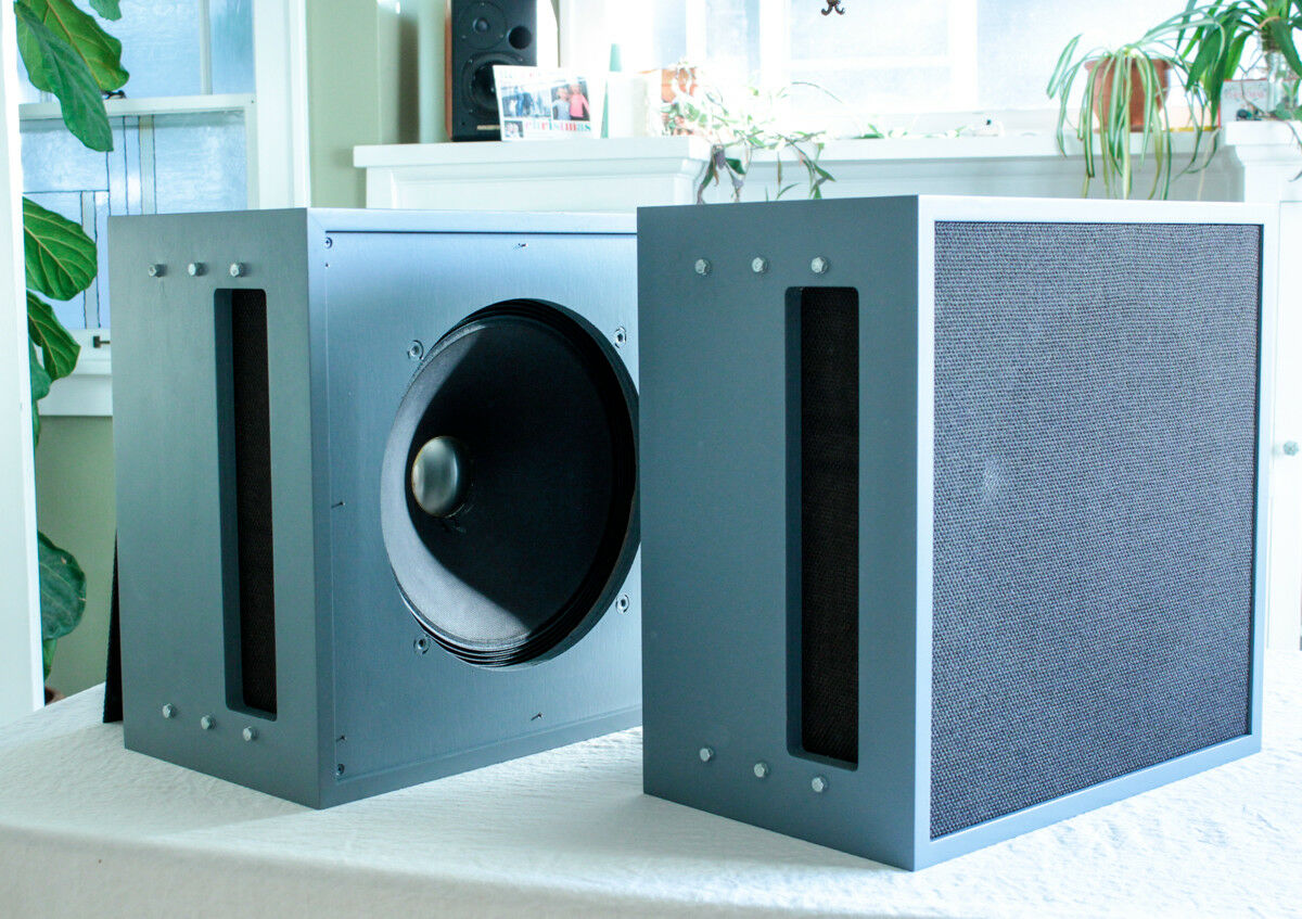

I figured you might appreciate the following info ( given your comments within the Cardiod Midrange thread ).
Altec 814a
There are some excellent eBay pics of a pair of 814a's HERE!
Additional info might be available through a patent search ( haven't tried that yet ).
Here are some of the better pics for anyone who might want to try their hand at reverse-engineering this design .
