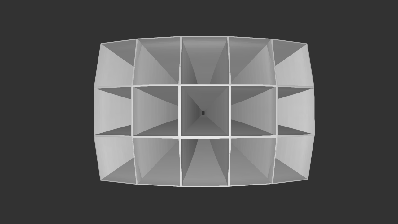

Has anyone tried nesting a dedicated tweeter horn in the center cell (closing off or removing the cell for this tweeter)? This would make a coaxial muticell horn.
What is the obsolete part about them? Aside from difficult manufacturing.
The modern tweeter horn would play from 3Khz up.
So we are looking at the multi cell to cover approximately 600 Hz to 3 kHz. The question then becomes what are the issues with the multi cell in that specific range?
POOH commented that the multicell is obsolete but my question is what makes it obsolete? Bandwidth limitations -- is it in the upper frequencies? Or manufacturing expense?

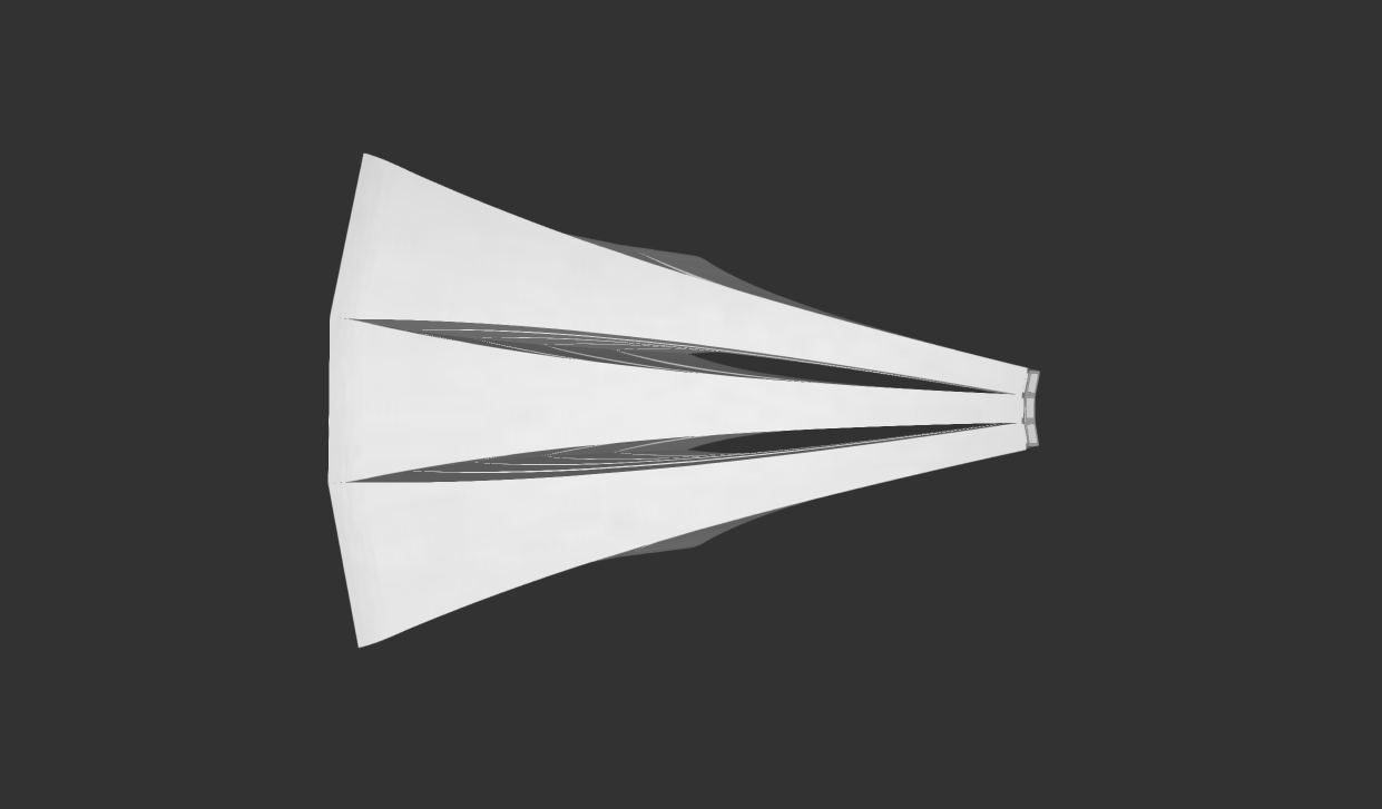

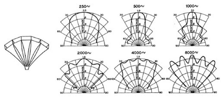

Multicellular horns may be obsolete, but that doesn't mean they are no longer used. On the contrary I would say.
Traditional exponential multicellular horns are reportedly subject to beaming and multicell comb filtering, aka fingering.

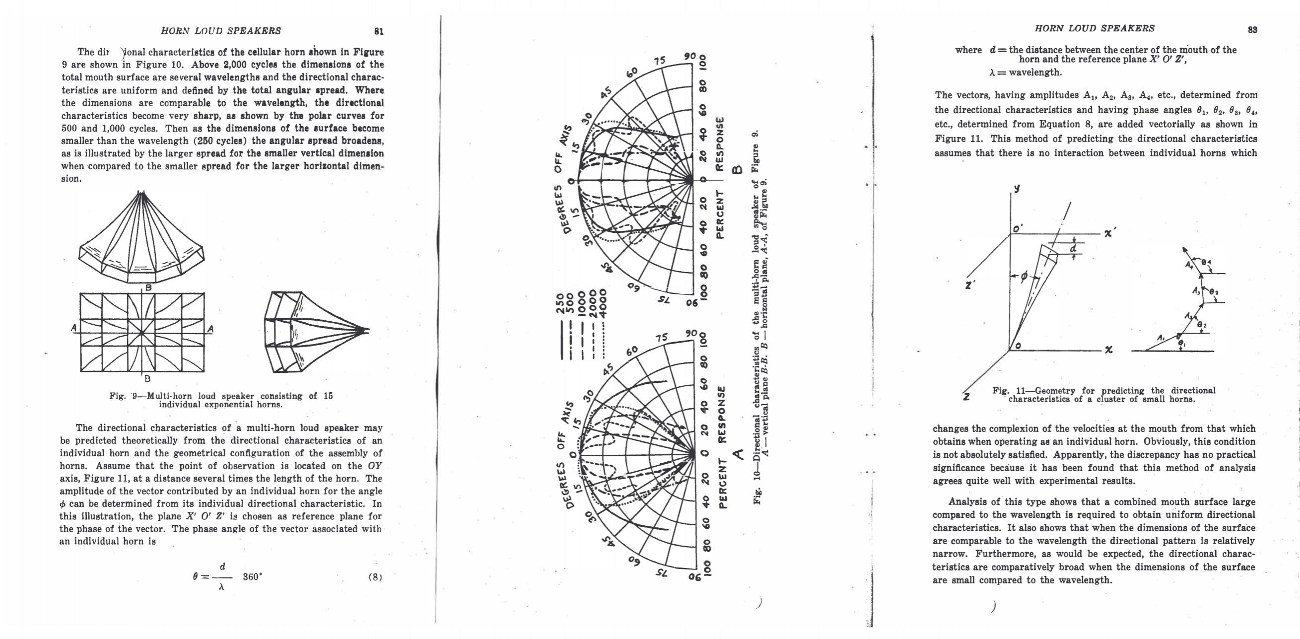

Follow up:
Pat Brown published EASE and CLF ballon data of an Altec 1005 on SynAudCon.
Unfortunately, the files are no longer retrievable, not even through archive.org.

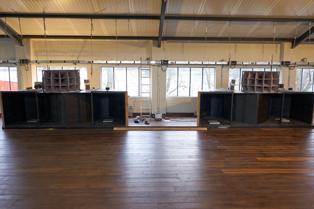

I feel I have seen these before. Are they in Europe (France?) in some guys multi million mansion who inherited his parents' (fabric or paper?) factory and managed it against the wall but still came out pretty well for him self? With very good room acoustics?
- Multicell horns
