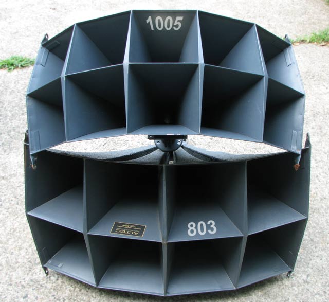

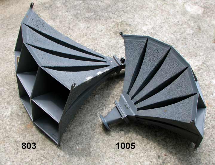

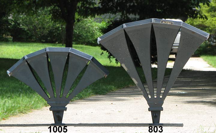

1005 vs 803
Here are my Altec 1005 and 803 horns. 10 cells 500Hz cutoff vs 8 cells 300Hz cutoff.
They measure a lot alike with the same driver. The 803 does go a bit deeper, the 1005 goes no higher, but is flatter thru the midrange. Distortion is also almost the same, H2, H3, H4.
They do sound different, tho.
