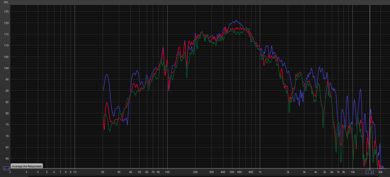

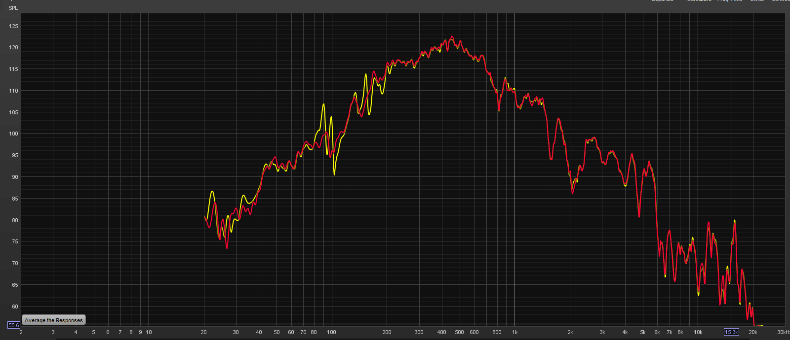

This is the raw midbass response. orange open, green closed.

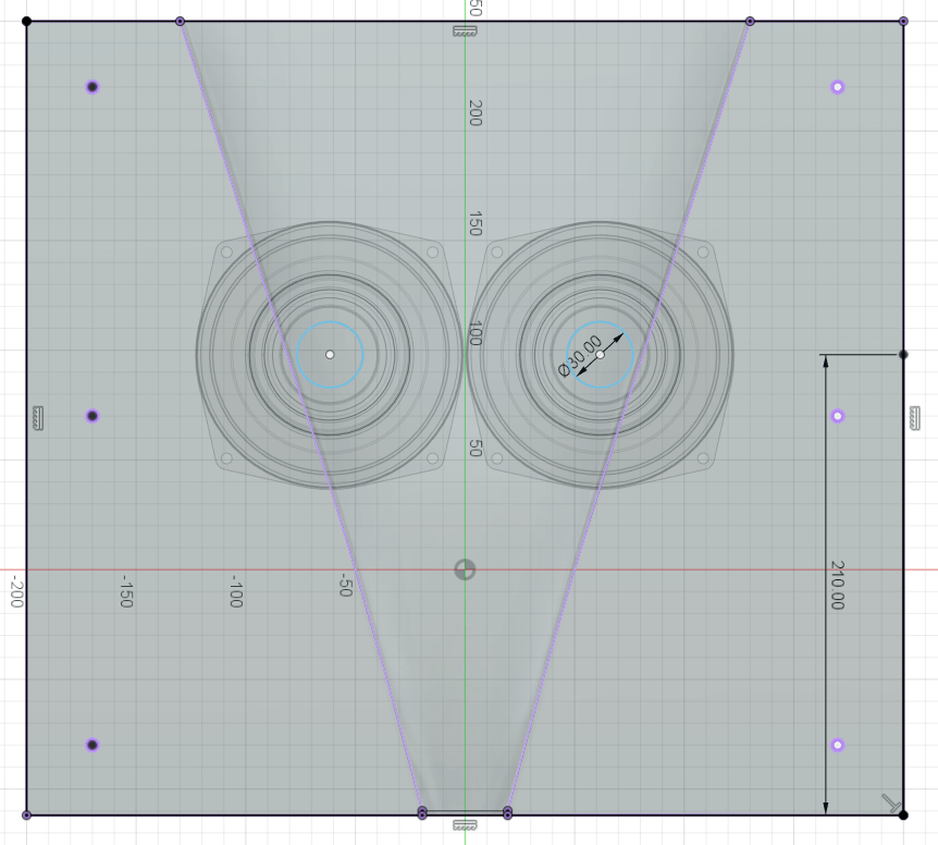

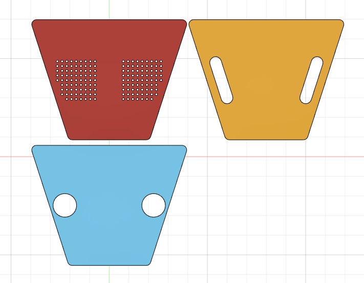

how are you cutting these they look very precise ? with a router or cnc ?
interesting design, I don't see why it shouldn't work to have two chambers. I guess your mill is only 3 axis so you cannot make angled holes as per the pk sound design? it may also help to randomize the tweeter side holes size and position (within constraints) such that any error is distributed over position and frequency.

Yes, i have a "small" cnc router 😉 Its diy (not by myself) and i have a working area of ~45cm*45cm 😉how are you cutting these they look very precise ? with a router or cnc ?
Wood is no problem... aluminum ist possible, but not so easy because of missing experience 😉
Hi Kipman
Randomice is a good idea... will try to figure out, if i can do that with Fusion 360... it's just a hobby 😉
Yes... but maybe later on i can try to reactivate my 3D Printer 😉I guess your mill is only 3 axis
My hope is to have enough holes, that its not realy working as a chamber but at the samte time, tweeter is not disturbed.I don't see why it shouldn't work to have two chambers.
Strange
New version, but not really a big difference:
Blue: old verision
Red new version
Green: new version but different place in the room.
In generell it look not so bad, because the raise is, because the Horn starts loading. My hope was, that maybe the drop at ~105Hz would change.
Any idea, what i could try here?
Yellow: tweeter removed. So i have some reflections from the tweeter, but that doesn't seem to be that bad. But still no change in the 100Hz region.

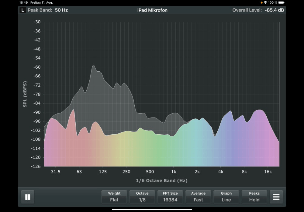

Maybe it is "simply" a resonance of the Horn.
It is only ~5mm thick.
When i knock the horn i get the feedback of the peak curve!!!
You can try to hot-glue some plywood-ribs on the classfiber-horn to tame/move the resonances!? Hot-glue is pretty strong if you use enough of it. And the ribs can be removed again.

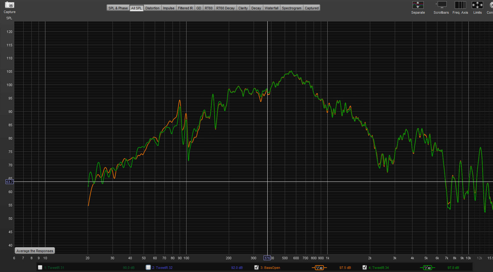

I had some Alubutyl left... not that much, but it seems to be the right Track 😉
Yellow without Alubutyl
Red with Alubutyl!
Red with Alubutyl!

3 Inlets:
Frequency response Tweeter:
I thoght the small holes would be the best... but, the 30mm round is the best 😉
3 Inlets:
Response of the Bass. Independent of the holes, almost some frequency response.
Red (small holes) is without alubutyl!

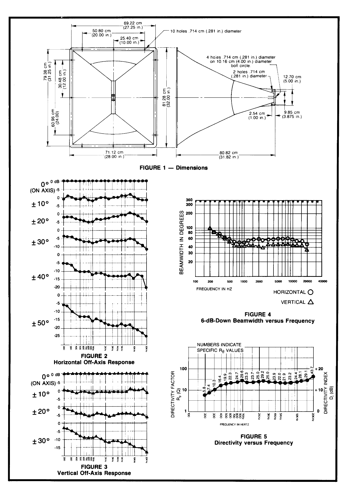

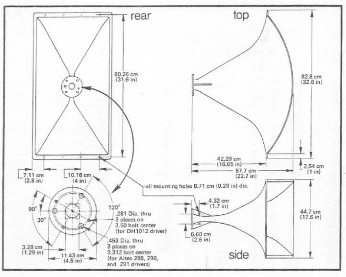

I have also a pair hf HR6040.
The big question: maybe the better choice?
https://products.electrovoice.com/binary/HR6040A EDS.pdf
Every comment is welcome 😉

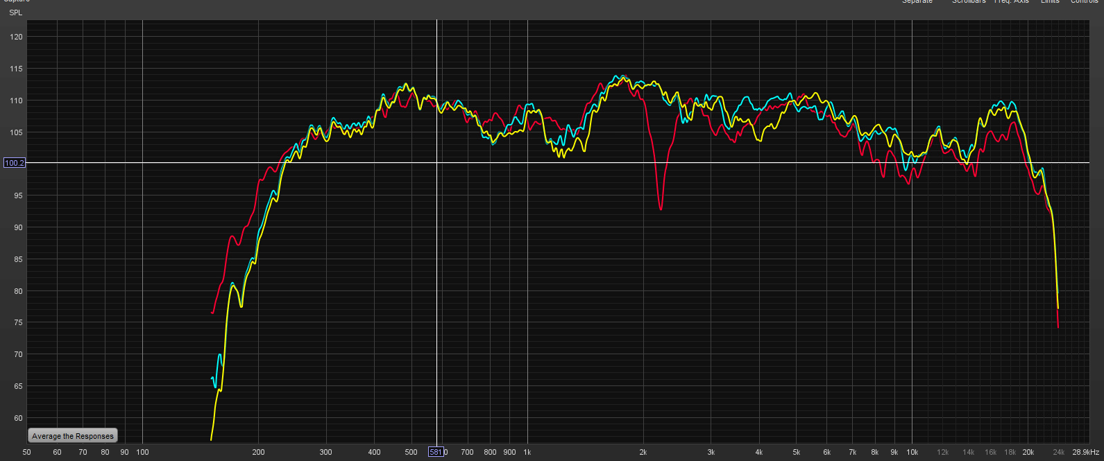

6.026 inches = 2250 hz. This is sort of close to the 17cm distance from the throat, if this is still correct. 17 cm = 6.69 inches.
What frequency is the dip? ( red trace ) - of the tweeter alone.
The closest I can estimate is around 2250 hz looking at your trace.
„ What frequency is the dip? ( red trace ) - of the tweeter alone.“

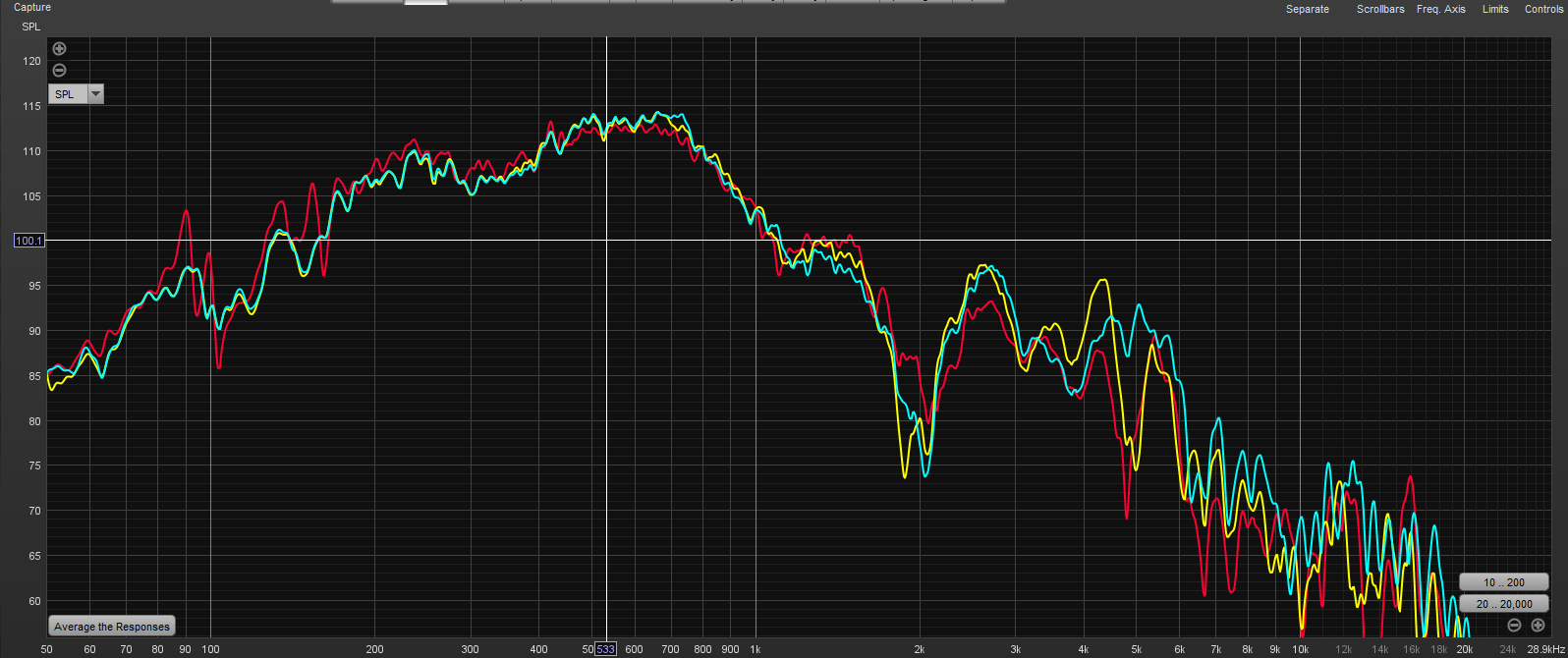

First picture is tweeter alone, with the three different inlets.
Second one the 5“ alone with the different inlets.
Color of the trace: color of the inlet.
