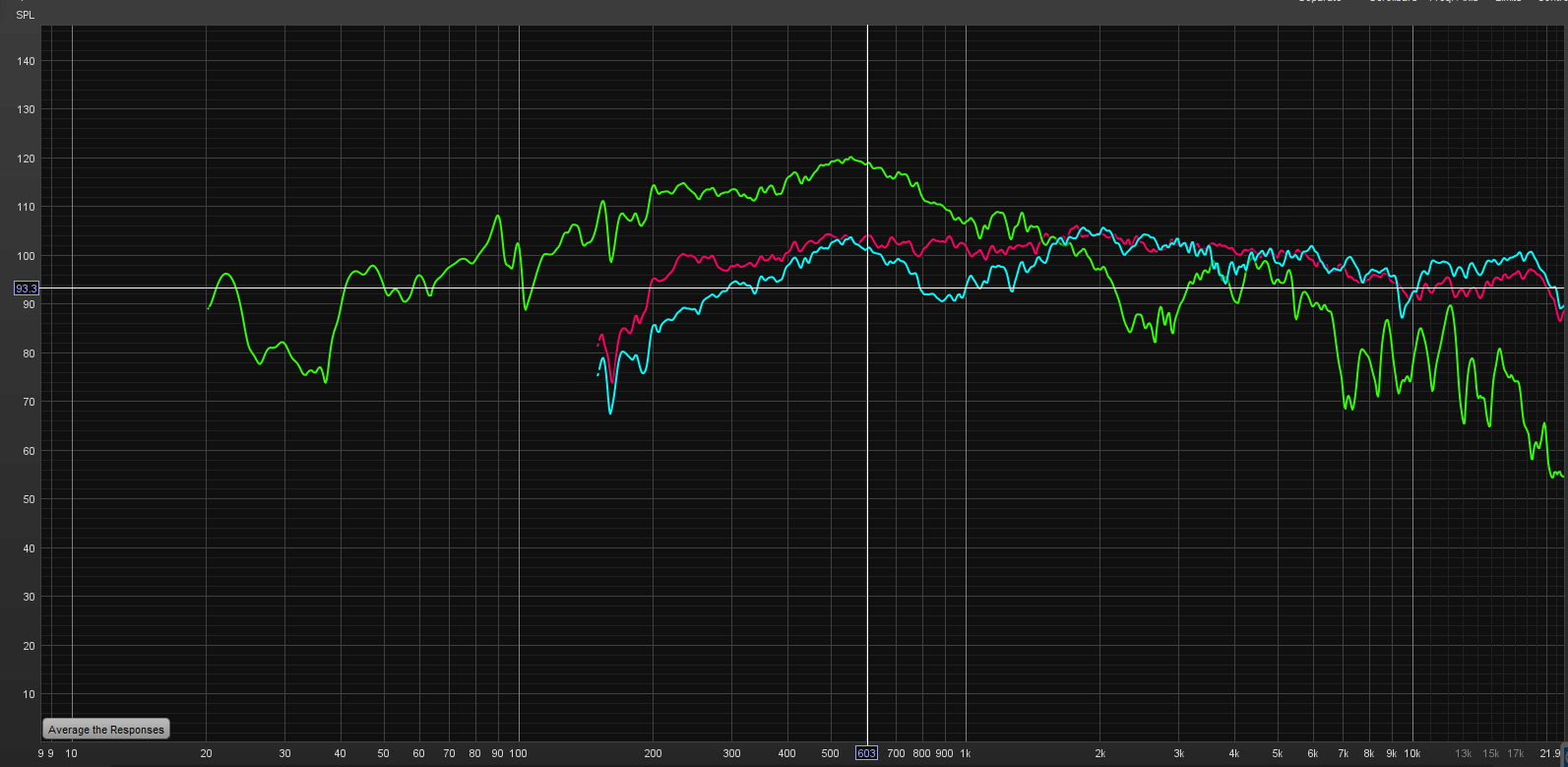

Before i start to modify the new throat, i was interested in the raw frequency response of the "tweeter" and i am very happy with it 😉
It's measured 40cm in front of the mouth.
It seems, that i could start lower then 500Hz. What do you think? And keep in mind: just home, not pa 😉

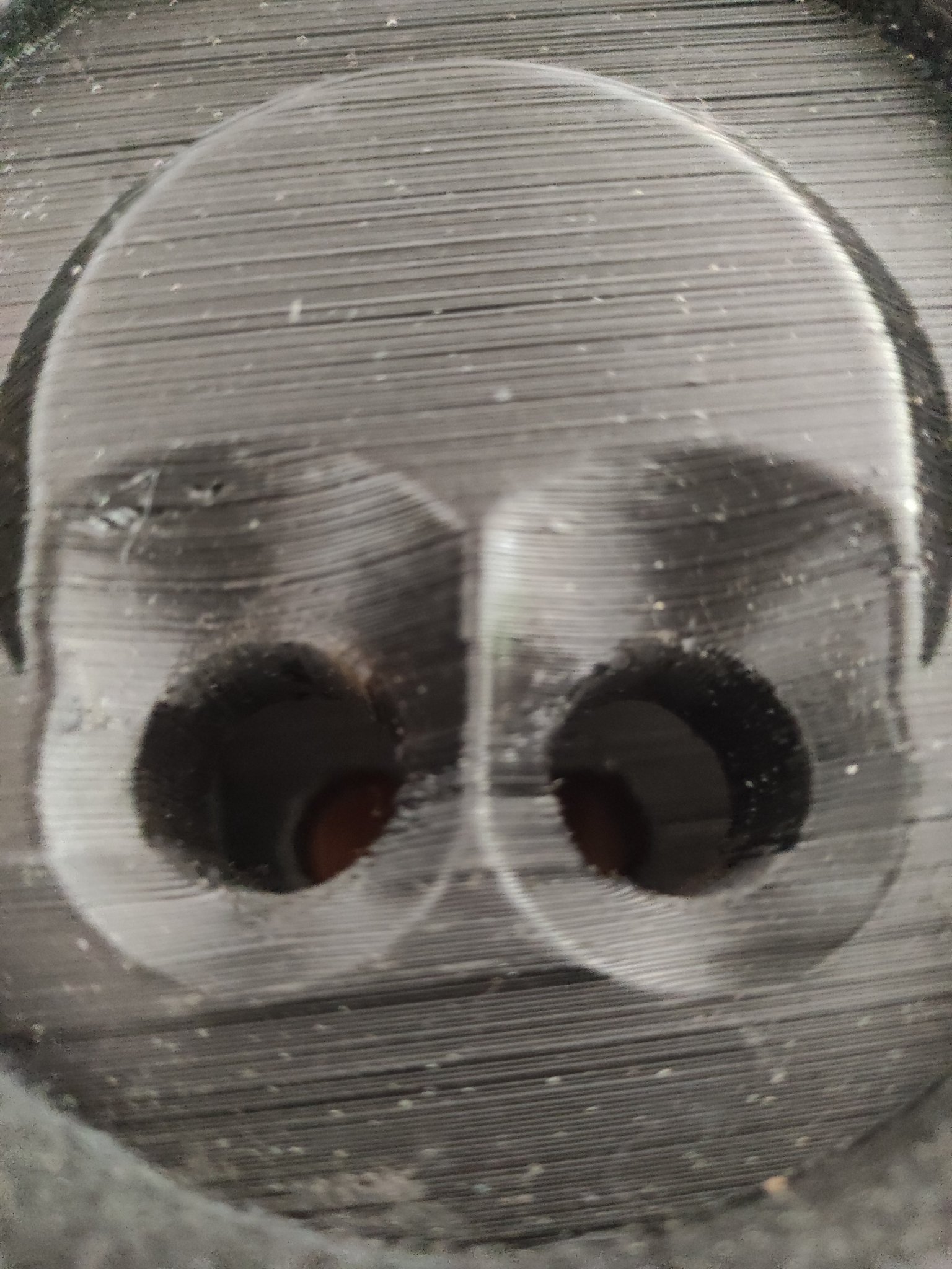

I have moved the port a little bit forward, that it should fit for 400Hz at diaphragm. If I can go higher in crossover… fine 😉

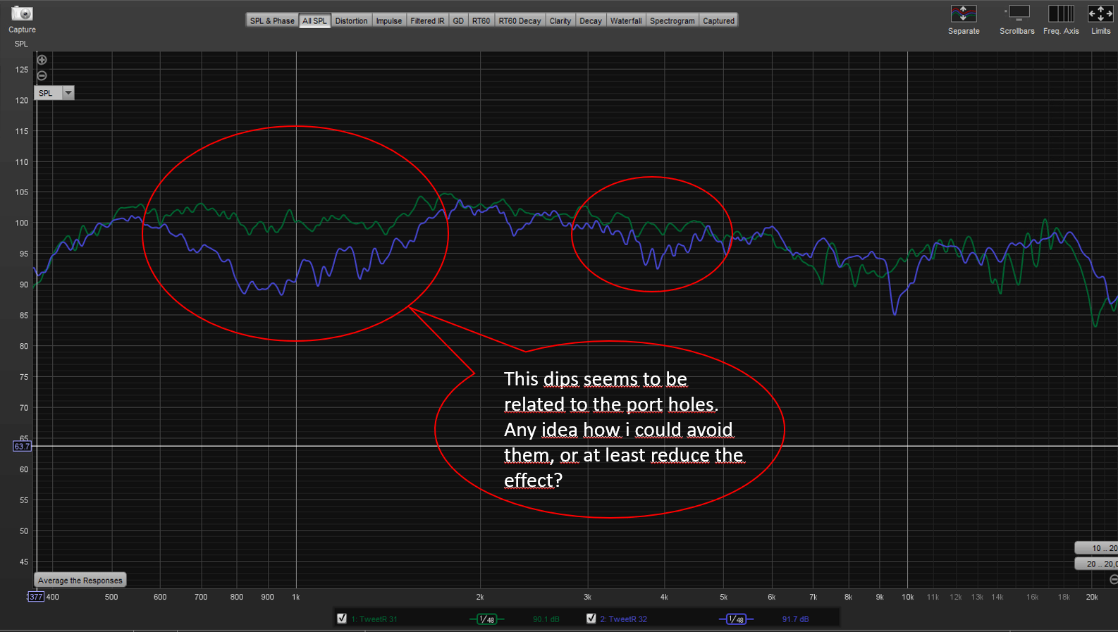

Big difference in the tweeter after making the ports at 900Hz ;(
Bass: i would say, something i could work with.
To me it seems, that its maybe better, to move the ports more to the mouth. first notch is at 2,5kHz. This will maybe also make less trouble in the tweeter?
My problem: no experience what is a good result including the ports 😉
Any comment is welcome!!!

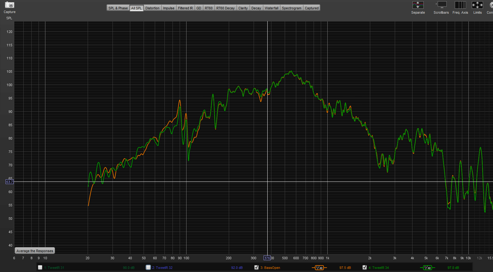

Because this is a project without experience, i only have one speaker for the moment... but sounds already promising!
At the moment the mids are open... but will try closed as well!
I have to tweak the frequency response... because this is jut roughly done in one hour, i am sure there is space for improvement 😉
EQ's are just IIR, not FIR and i have tried to avoid to many of them.
