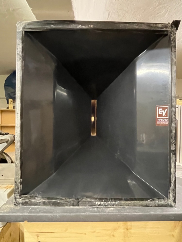

The MidBass drivers will be almost parallel face to face to each other, because the HP6040 horn walls are almost parallel to each other… could this be a problem? Or is everything fine in the frequency range, because wavelength is already relatively long?

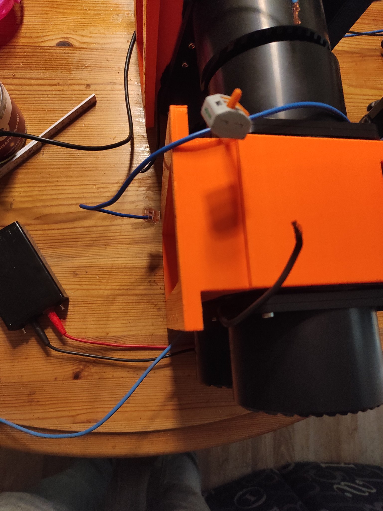

... and i am sure, that i saw this picture somewhere before... looks pretty unique 😉
... and i can see dats for TSP measuring 😉
Wow i made that picture today 🙂
But yeah maybe you saw a picture of the complete speaker at facebook.
Dats is a good tool i love that, sometime you have to proof some theorys and with dats it`s super easy.
impedance sweap is your best friend 😀

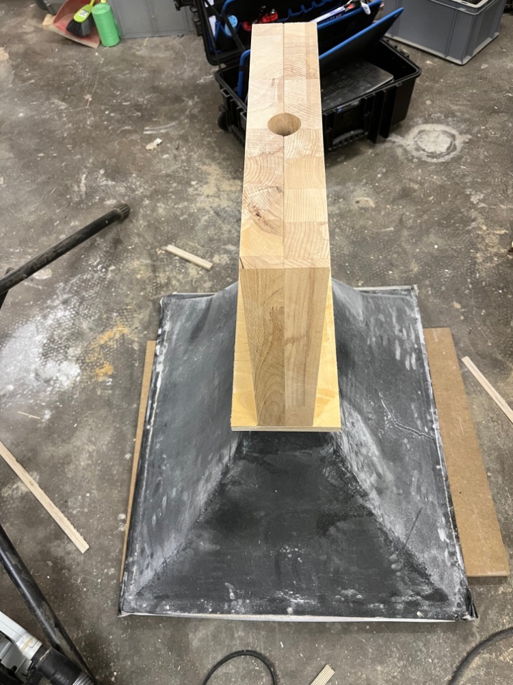

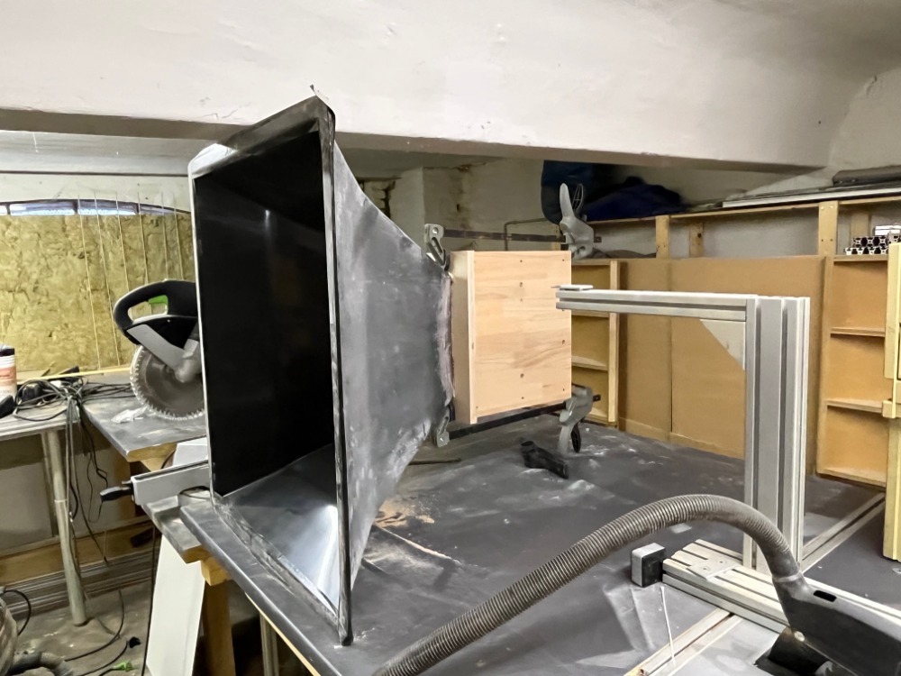

I was referring to the modification of the horn with a circular saw. I think its a great idea though, although I am curious how you will join your new throat to the horn. The holes should as pelanj says be larger. The holes should be positioned where the local flare rate is correct (plot flare rate with respect to axial distance for your horn):
there is also an effect where the sound reflects from the throat and destructivly superpositions limiting the HF output of the 12". However I have seen some data recently here that seems to contridict that theory :/ in general you only want them to be as close to the throat as is required for your target HF corner frequency.

Thx!! joining: epoxy is my friend 😉I was referring to the modification of the horn with a circular saw. I think its a great idea though, although I am curious how you will join your new throat to the horn
To be honest: don't get what you mean. Maybe you can explain it a little bit?The holes should be positioned where the local flare rate is correct (plot flare rate with respect to axial distance for your horn):

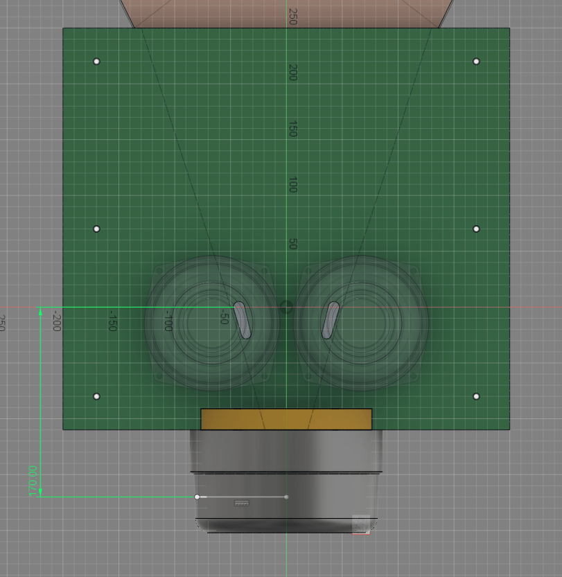

My plan for crossover is 500Hz. Wavelengh is ~68cm so max distance from diaphragm to the endpoint of the hole is ~17cm correct? Thats where the ports are at the moment... is my idea wrong at this point?in general you only want them to be as close to the throat as is required for your target HF corner frequency.

locating the midrange taps too close to the throat results in a high local flare rate with limits the low frequency performance of the mids. Your 17cm tap position should work fine as long as your incorporating the mid notch into your crossover.

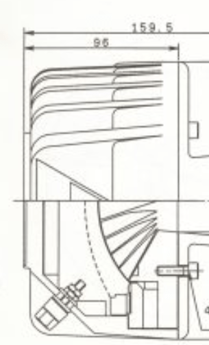

The reflection-point for the 1/4WL-frequency is not necessarily at the diaphragm of the compression-driver! It can be further out and needs to be found experimentally I think.
I would make a flange on the horn and be able to work with replaceable "first-horn-section-parts" to be able to experiment! Have to go now.

I could roughly cnc some different Horn Throughts to check this out.
I think, I need the original Compression driver mounted correct?
