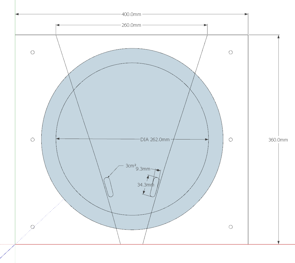

Too small… yes maybe, that’s why I wrote, that I will start small 😉
The are roughly 3cm * 1cm each.
SD of the driver is 55cm², my ports have ~6cm² what is not so far away from recomandation, or is my calculation wrong?
And: what I think to know is, that the distance to the diafragma should be max. 1/4 of wavelength of highest frequency… less is no problem. Is this wrong?
If I would use same frequency range but smaller driver, ports can be small… why not, if I have a larger driver? What are the disadvantages?
Will try to have them as small as possible to make sure, that I don‘t get problems (reflections in the horn) with the tweeter.
To close to the throat (dia)… maybe, the farest point is ~14cm. so i could move them maybe another 3 cm

I was confused by the 12" dimension of the woofer - these have usually Sd of around 500 cm2 - and the holes looked (visuaĺy) like less than 1/10 of the Sd. The important distance is along the centerline of the horn. Placing the ports is a balance between highest frequency required and amount of interference with the HF. I am not sure how that would really work in the narow slot you have. If the slots are unnecessarily too close, weird stuff happens. Less than 1/4 wavelength is great, much less than does more harm than good. How much less I cannot tell. If the woofers can play high, you can increase the crossover point easily to see the influence.
Now you should See the Misstake. The Sd of the beyma ist 550cm2 not 55cm2.
So your holes are much too small at the moment.
Ahhhh…
Yes… crazy… just factor 10 😉
And welcome back to the 4“ Driver 😉

The size of the Ports depents on different Things. It's a bp4 so the size of the Camber (place in Front off the Driver) is different to smaller drivers. So the bp4 Port Changes it's size or lengh.
OK... something what need to be accepted 😉
But it would be a little bit better, if i would reduce the chamber in front of the driver?
Anyway: will change back to the already advised B&C 4NDF34-16 and will use 4 of them.
Thx a lot for the help and the hint!

Another question: what Port size have you used?
Thx
Christian
Better then the 16 Ohm? If why?The 4NDF34-8 is the better choice i load them down to 120hz in a meh.
Thx
Christian
My First Prototyp used two 1,6cm holes that equals 4cm2 with lengh of 2 cm. They we're good from 125hz to about 1 kHz

I will make the holes a bit larger to get something between 4-5cm2

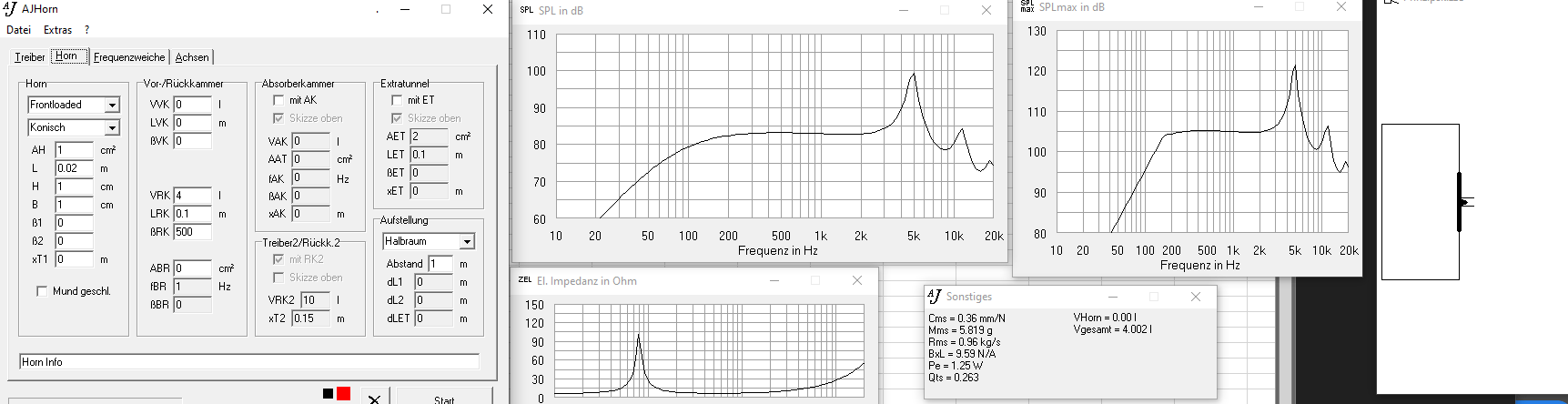

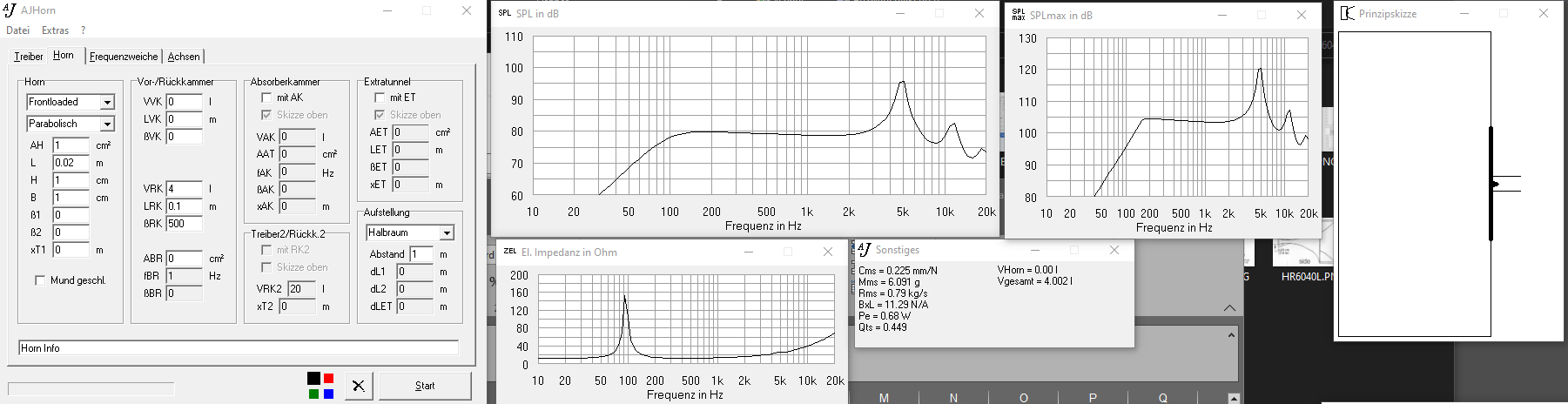

I made a simulation in AJ-Horn. I know, it can not simulate meh's but mabe it is a good starting point for bass behavior.
To me it seems, that 16 Ohm behaves a little bit better than 8 Ohm... is this wrong?
16 Ohm:
8 Ohm:

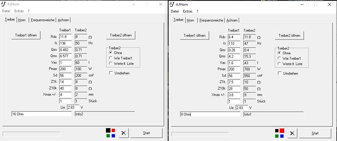

Used TSP:
16 Ohm:
8 Ohm:
Used TSP:
Hi, have you tested both, the 8 and 16Ohm ?trust me xmax is about 2.4 the data is wrong. xvar is less than xmax...
If so, please say how tested..
I've always thought the specs for the 16 ohm on tlhp looked a bit bogus compared to the 8 ohm.
B&C doesn't list 16 ohm specs that I can find....nor does anyone besides TLHP...
Also have to say 4mm xmax seems a bit crazed just looking at the driver suspension....
So really curious how you came about 2.4.
Yes i have both here. 2.4 seams right. i can get the right datasheet if you like.
The 8 Ohm Variant has an xvar of 5.7 and that controlled. The 16 ohm xvar of 3mm
but you can also calculate xmax from winding and magnet gab
i think looking at half the xvar 6 db less is possible
