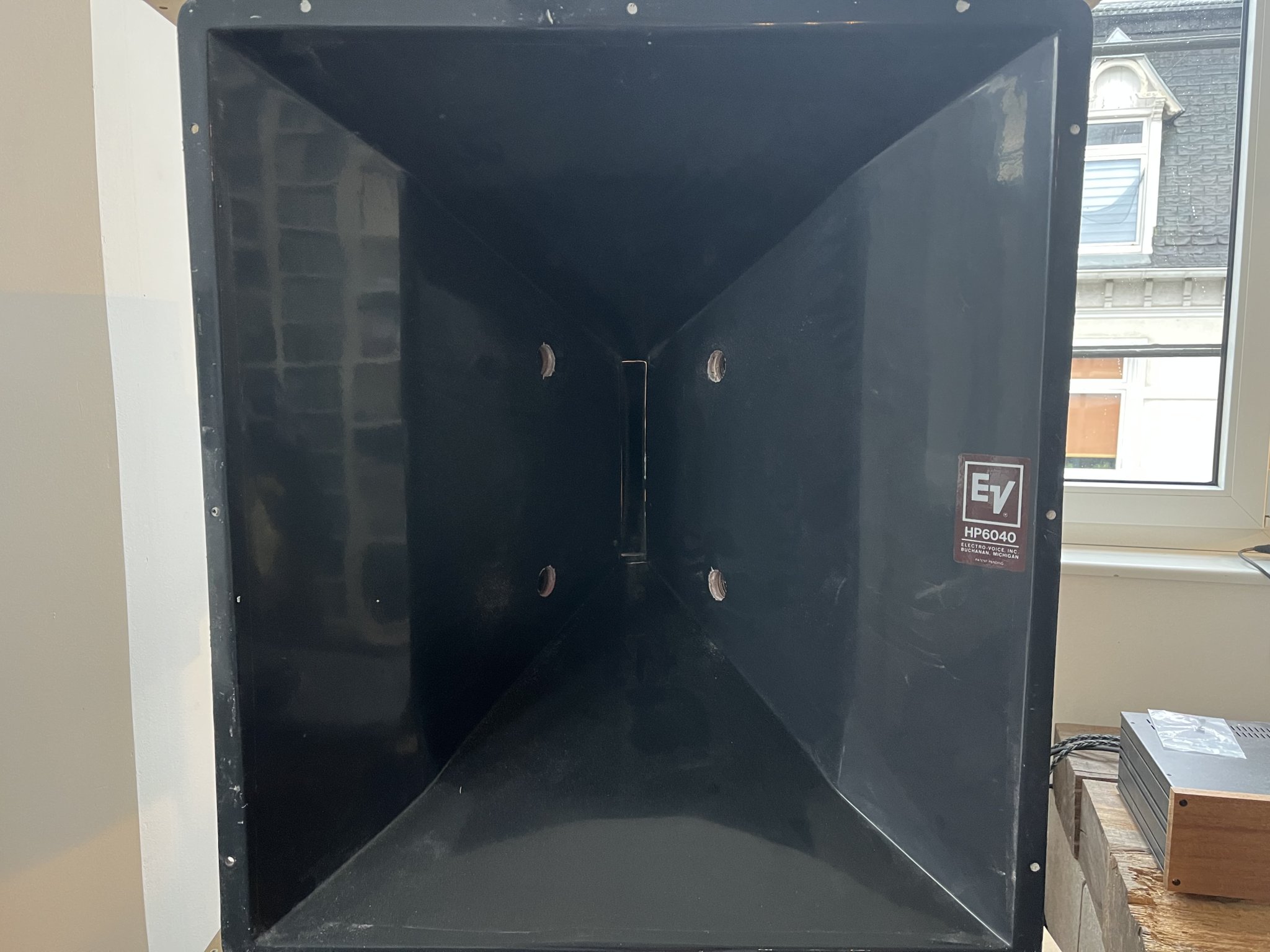

Tomorrow i will build wheels for the second speaker, and than, later on i will do some measurments… maybe on Sunday.

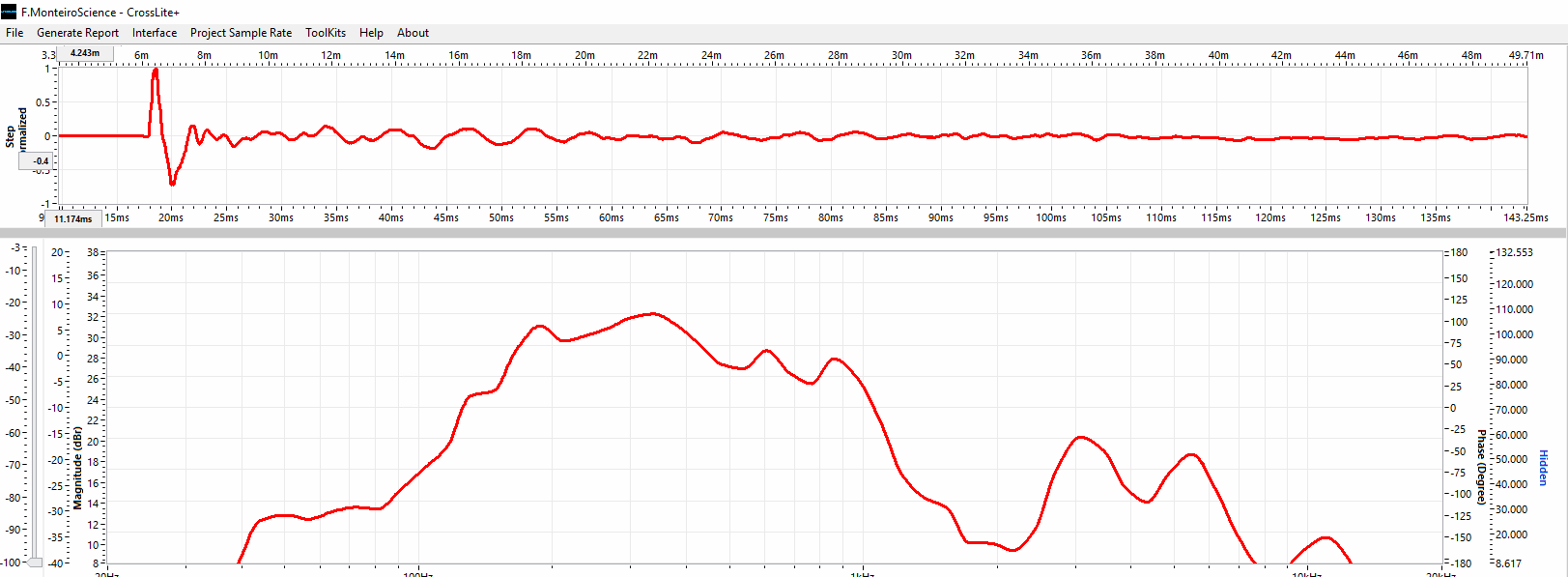

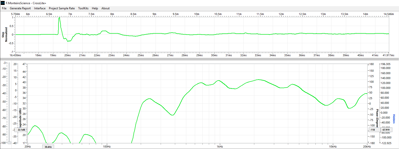

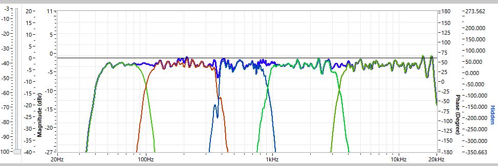

Hi Christian,
I'm looking forward to sending Francisco some examples of my work, to help ask about his FIR add on.
Still trying to get a better versed on Basic, to better what to ask about.
I'm using q-sys and 16,384 taps per channel @ 48k, lin phase. I use the same tap count on all channels because I don't want to fool with delays, and the q-sys Core can handle it.
I 1000% agree too much correction doesn't work. My normal method is to collect raw polars outdoors for each driver section, and average them to obtain a measurement to correct. That said, I've built enough of the conical unity horns to know 10-15 degree off axis makes a pretty good single axis reference.
Also, I never bother with room tuning...just quasi-anechoic. For room tuning, i just use real time EQ, like mixing live sound.
A bigger problem than polar averaging has been at what distance to measure, especially for the narrower pattern horns where the CD is farther from mouth.
Close to the mouth doesn't work ...inverse square laws are impacted, with the mic so close to outer ports. (this one is 75x60 degree)
The mouth tuning i showed above is very bass shy out in the room.
I tried the Vary-Time Transform noise reduction an all 5 sections.,...it has its own degree of smoothing in addition to impulse cleanup.
Have you tried it yet?
And It's not as neat as the 1/12th smoothing show before either, to avoid overcorrecting. 1/48th below.
It was more about learning the program., than trying for a real tuning.
But once i dialed up the sub and low sections, it did sound pretty damn good ...plus the syn11 sits on a double 18" sub cart.

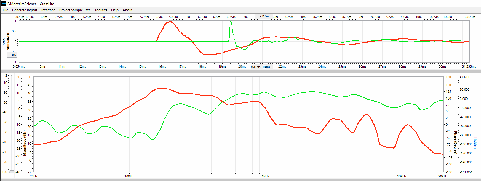

Measurements:
What do you like to see?

What is not working in the HP6040 ist the distance from the mids to the tweeter… I moved them out of the slot forward to tha mouth, because i had to many problems in the frequency response of the tweeter. I know, I am leaving the lambda/4 rule here… so: no lunch for free 😉
So it seems, that the HP6040 is not the best „playground“ for a meh, but the resulting sound is really better, than expected.
I am sure, this is not my last one 😉
Maybe, I will start to build the next from scratch… but this will be very time consuming 😉
Let me make sure I understand the measurements.....particularly the last one 'Tweeter and Midrange'.
Looks like they are both raw without any xovers in place. ?
(I guess the 150Hz hp and 600Hz xover you mentioned are what you decided to use on the processed posts you showed earlier, but not involved now.)
Looks like there is about a 3.5ms delay between the mids and tweeter.
Is all that correct?
What's the physical distance between the mid ports and tweeter?
Eyeballing the HP6040 drawings, and assuming you tried to get the ports as early in the horn as possible,
I'm guessing they ended up somewhere around 6 cm from tweeter.
That would account for a little over 1ms of delay, but I don't get where the remaining 2.5ms would come from without a low pass in play on the mids,
which doesn't appear to be in place????
Very curious....
Very curious....
Hi Mark… please don‘t care about the delays! I have a Crossover at i think 150 Hz in the DSP to protect the tweeter! Pleas only look the responses itself and don‘t compare the delays to each other!
I have moved the mids to the front, because the holes in the slot where destroying the tweeter response! Will post a picture what makes it easy to see 😉
- Multi Entry Horn ElectroVoice HP6040
