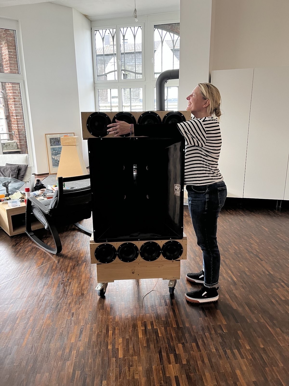

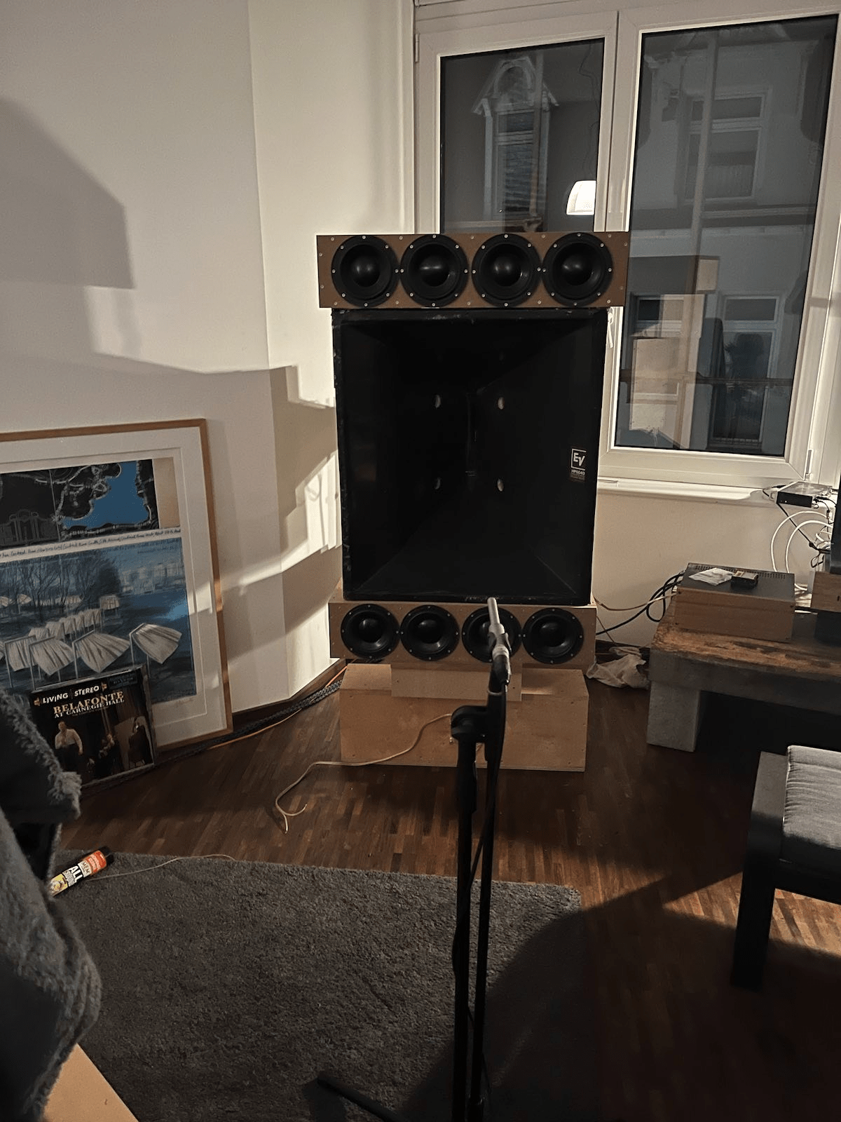

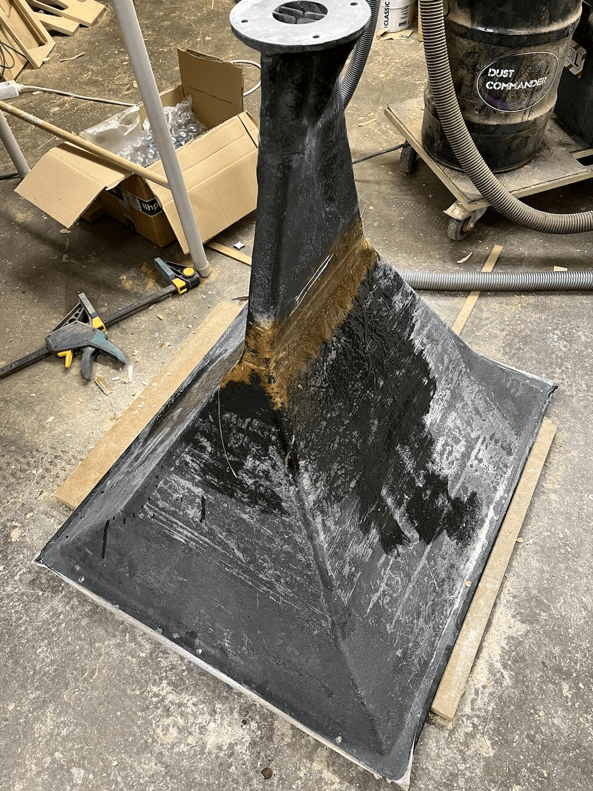

First Try was not that good, because i never get a good frequency Resonse in the tweeter, because of the positionings of the holes.
I "repaird the horn with the original Throat:
New holes:
Result:

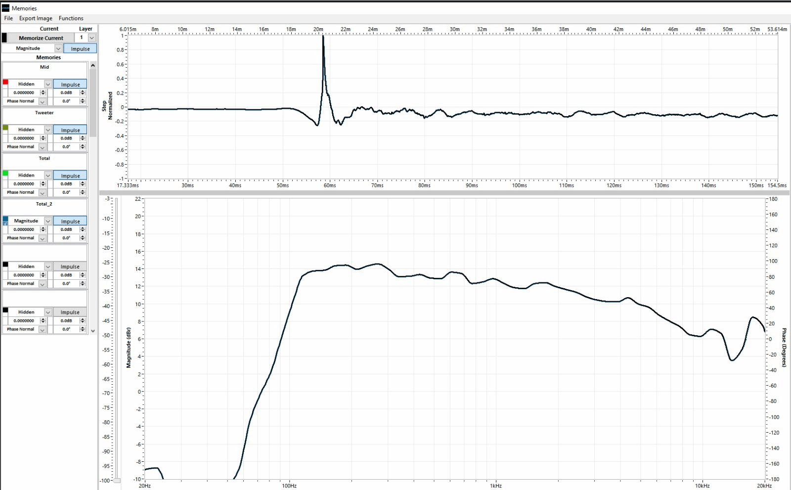

Crossover 90Hz/600Hz
Crossover: LinearPhase done in the Hardware DSP. Also a little Delay on the Midbass, what was needed anyway, to fit the LinearPhase crossovers because of different Tap Length.
No Bass at the moment!
I would say: not that bad 😉

No, but these are 3cm ports for a 5" chassis, which starts at 90Hz... at home spl... so i don't think, that this kind of noise will be a problem here 😉

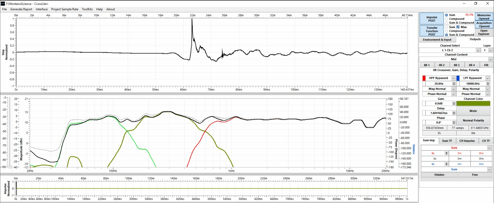

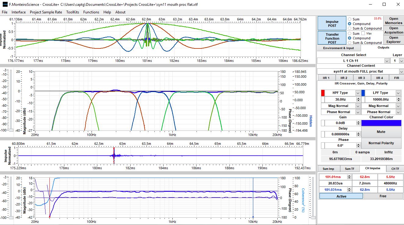

And to make sure, that my measurments are correct, i did the same in Crosslite+ what i use for the timing adjustments:
Looking very nice, way to stick with it !!
What's the total path length, CD flange to ports?
Do you have any raw response plots of the 5"s handy?

But it can be, that the "reflection-point" for the cancelation notch of the "midranges" is located around your first cutline of the horn, as the horn-contour there has a big change in profile, i.e opening up rapidly. Maybe that creates an impedance-discontinuity, making it the "reflection-point"? I have this idea, because Tom Danley has stated, that the "reflection-point" in a conical horn is at the throat of the horn and not at the diaphragm of the CD or at the phase-plug!?
Looking forward to see the raw-responses.
What LinearPhase-filters do you use?

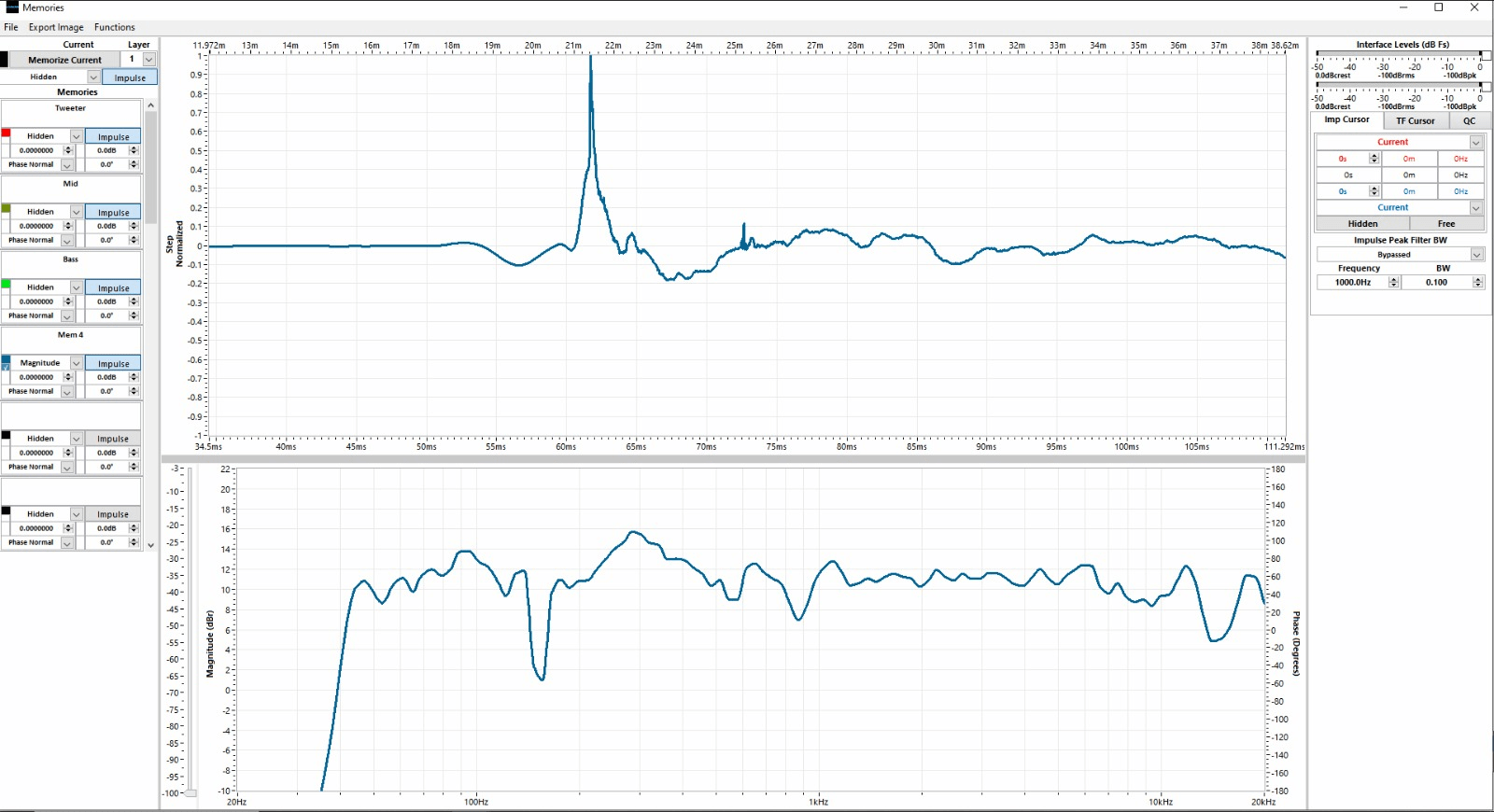

Christian,First Try was not that good, because i never get a good frequency Resonse in the tweeter, because of the positionings of the holes.
Sorry that didn't work out, but it was interesting to see the response with the 5" drivers entry point in the pinched throat portion of a diffraction horn!
Did moving the mid ports out of the throat eliminate their effect on the high frequency driver's response?

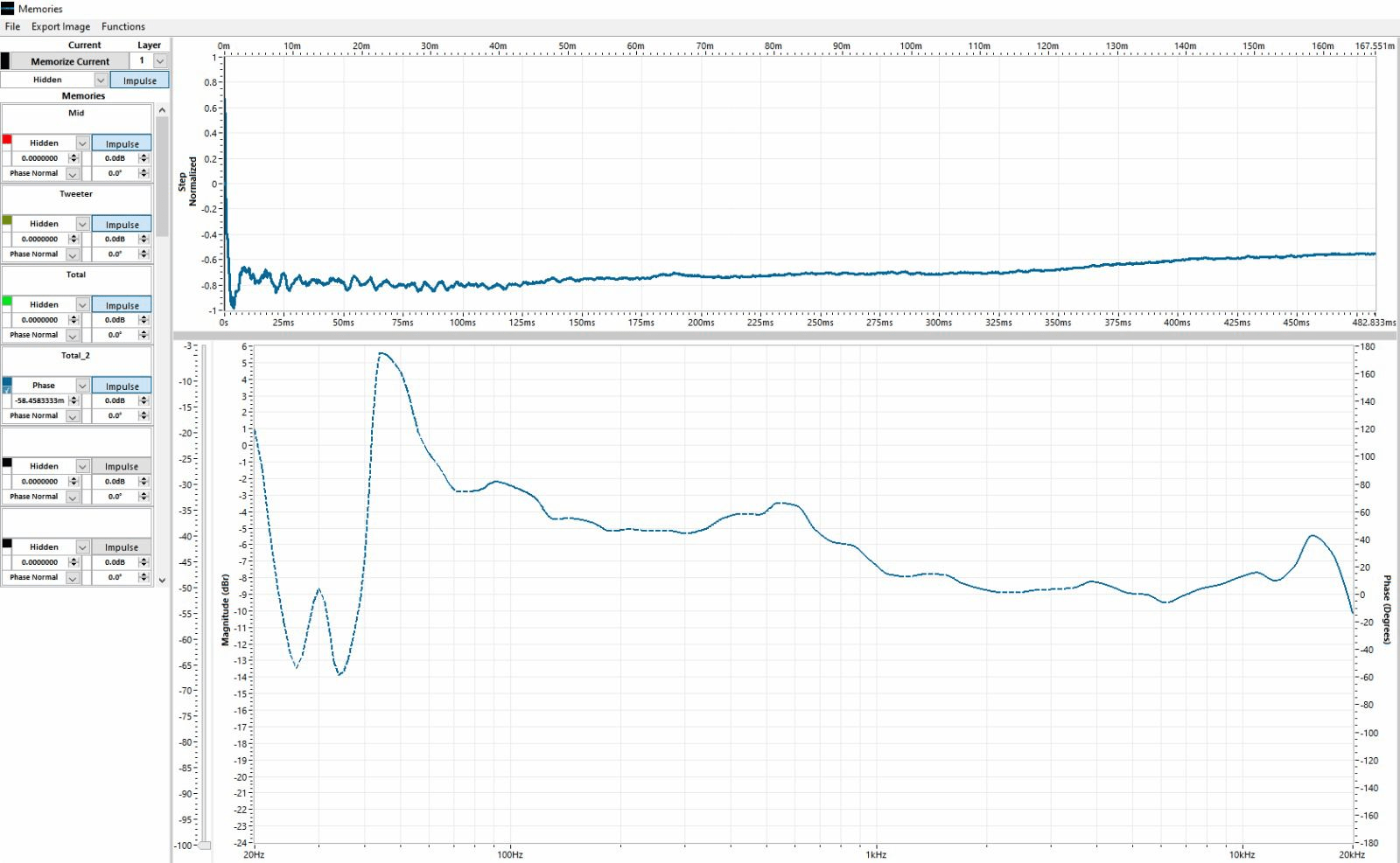

The processed response looks great!Crossover 90Hz/600Hz
Did moving the 5" out of the throat reduce their dip ~105Hz?

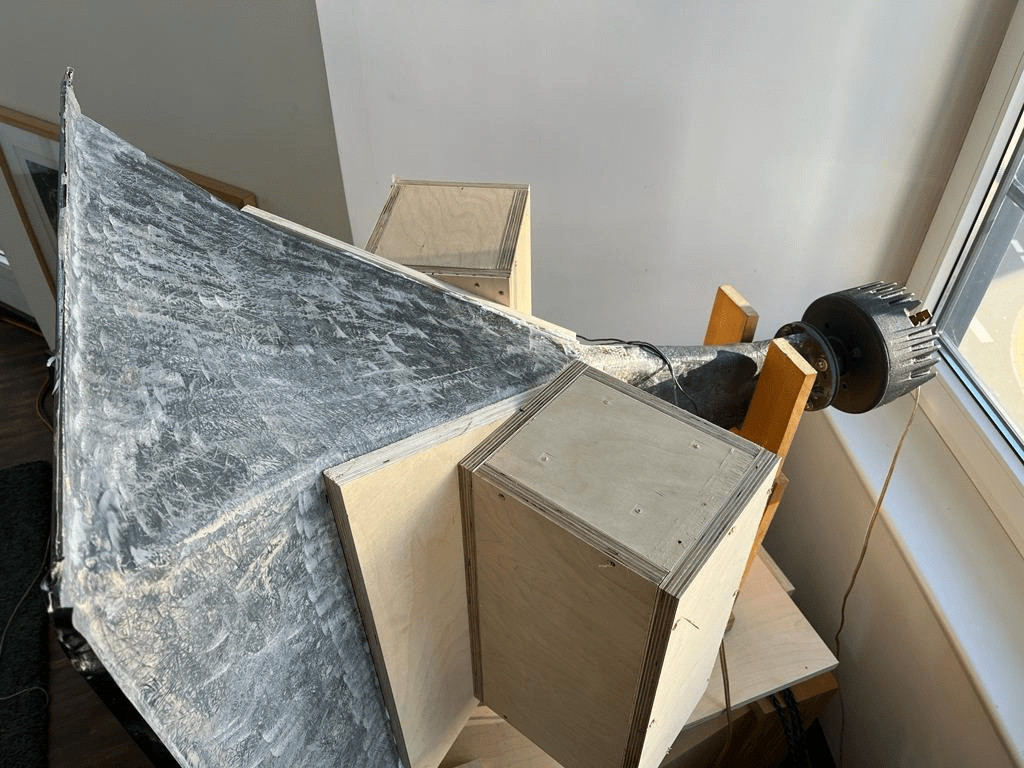

Think about adding another 2 8“ or 10“ because the 5“ start to drop from 150hz.

Maybe you could mount them on top and bottom of/ in the horn, before the final expansion? I know, more holes in the horn. But I think that Mark100´s experience with his SYN11 is to keep drivers/ports within 1/4 wavelength.
It is really tempting to make a mold for a fiberglass horn! I am slowly building a big MEH out of wood/plywood and there are so many parts and things to fit together. With a fiberglass horn there is ONE piece, keeping itself together! Hmm.

Have also 2* 12" Beyma in the cellar...

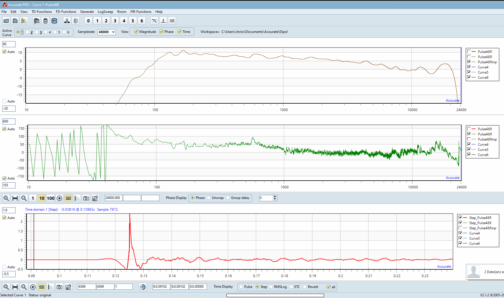

@chriss0212 I like the software you are using. I googled a tutorial for a two way speaker and it seems it can build some really nice FIR filters for MiniDSP. What is your general experience with this program? Are there things you like/ do not like? Have you used another FIR filter designer? This program seems to be a really nice "all in one" package for a fair price.

What was not working well in THIS horn was 1/4 for the mid drivers. I had always problems in the Tweeter response. No i am outside of the range, where the horn is more open, it works much better.

I am working with different software. I have Acourate, Audiolense and new: crosslite+
Crosslite is preety nice! And especialy the comunity (privat whatsapp chat) is pretty nice and helpfull.
But be aware: 500,- is not incuding the FIR option. This is another 500,-. But it is realy strong in finding the delay between the drivers. Measuere once and adjust in silence 😉

Second one is rolling in 😉
Hopefully I have some time on the weekend to share some measurements!
What I can say after so first times: the 4 faital (starting from 150Hz) playing much better and cleaner compared to the 12 Beyma midbass Horn!

Hey, I went ahead and got Crosslite+ ...just the Basic Tool-Kit so far.
Spent most of the week studying what all it can do....which is a hell of a lot, huh? 🙂
Here's my first go at using it for acoustic measurements ....made just today.
Syn11's 5-sections, at mouth indoors...with FIR corrections.
