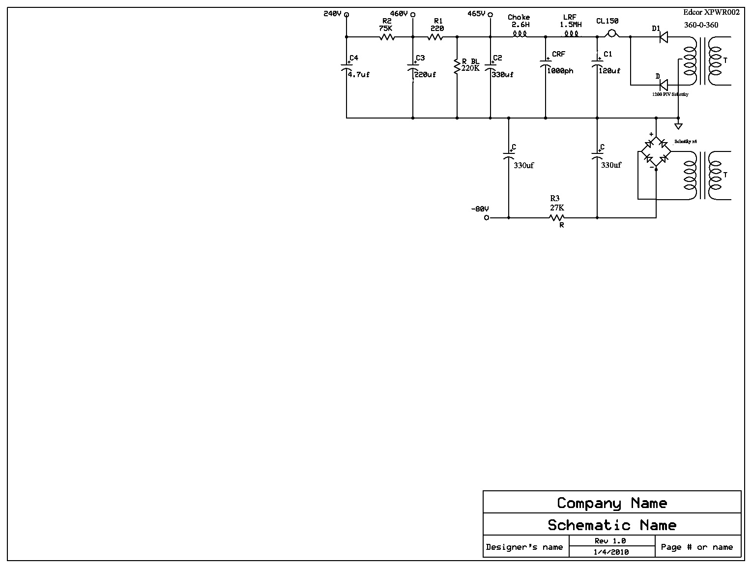

This may be a dumb question, but I'm unclear on why we would still need the boost on the Edcor. What's the problem with the head room on the LTP at 460V?
I re-read the first couple of hundred posts and was wondering if there was any other reason for dropping B+ to 465V beside reducing the expense of capacitors? It seems to me that revisiting that may provide a little more room to breath and allow the 12at7 LTP to operate closer to its sweetspot (3.0 to 3.5mA per side and ~220V). At the same time it would make it easier to get Vg to 100V.
I was playing with TubeCad using the classical LTP schematic with only positive power supply. If interested I can post some of the results. It isn't exactly like we are doing since it has a cathode resistor instead of a CCS.
boywonder,
The XPWR0002 won't develop 465V. Per PSUDII, it will fall in the range of 450V to 455V range when wired normally.
Eli, correct me if I am wrong, but we need the Vg to be about 100V to allow enough swing on the output. Vg will be approximatley a couple of volts more negative than the cathode. If we fix the anode resistor to 50k as the smallest value, it will drop 150V at 3mA. The cathode will be about 100V leaving 210V across the tube. 210V is within Eli's range.
If I understand what Eli was saying about the limit of Ra(anode resistor) 50k is tight considering that Rp is around 20k @ 3mA. Just slightly over 2:1.
You have the general idea down, but the situation is actually worse. The net load the 'T7 section "sees" is the parallel combination of the 50 KOhm anode resistor and the KT88 grid to ground resistance. If that grid to ground resistance is substantially less than 100 KOhms, things are going to fall apart. Even if the KT88 grid to ground resistance is 100 KOhms, the LTP is at the ragged edge. Fortunately, a comparatively simple solution to the problem is available.
The FET's source actually sets up a few V. below the gate, but using the gate voltage in calculations is fine. The 'T7 plate and the FET's gate are at 310 V. For a 5 mA. ID the source to ground load resistance is approx. 62 KOhms. A trio of 22 KOhm/2 W. parts wired in series seems about right, in a standard value. Mouser part # 660-SPR2CT521R223J, at 16 cents each, meets the need. Oh yeah, a 510 or 1000 Ω Carbon comp. stopper is absolutely essential at each FET gate. FETs are like tubes in so many ways, including the blasted parasitic oscillation.
boywonder,
Is there something wrong with the PSUDII model we've been looking at since er... page 3? I've always thought 465V was possible.
..Todd
boywonder,
Hmm......either something isn't adding up, or I'm not using PSUDII correctly.
One thing that's a little unusual is the 413V offload voltage for the Edcor; that's 15% regulation. I would have guessed it to be better than that.
If I input 413V offload V, 40.3R secondary R, 120V primary, 1.2R primary R into the transformer properties box, PSUD is giving me a transformer with 413V/54.5R, which easily gets 500+ volts B+ if we want it, although I'm not sure I believe the numbers.
Using 360V/54.5R transformer properties barely makes 450V depending on choke R, and using 360V/40.3R yields a B+ of 458V with the same choke as above. Both of the above are with CLC=47u-10H/63R-330u.
Using 360V/40.3R with a hammond 5H/26R (193P) choke yields 464V B+.
