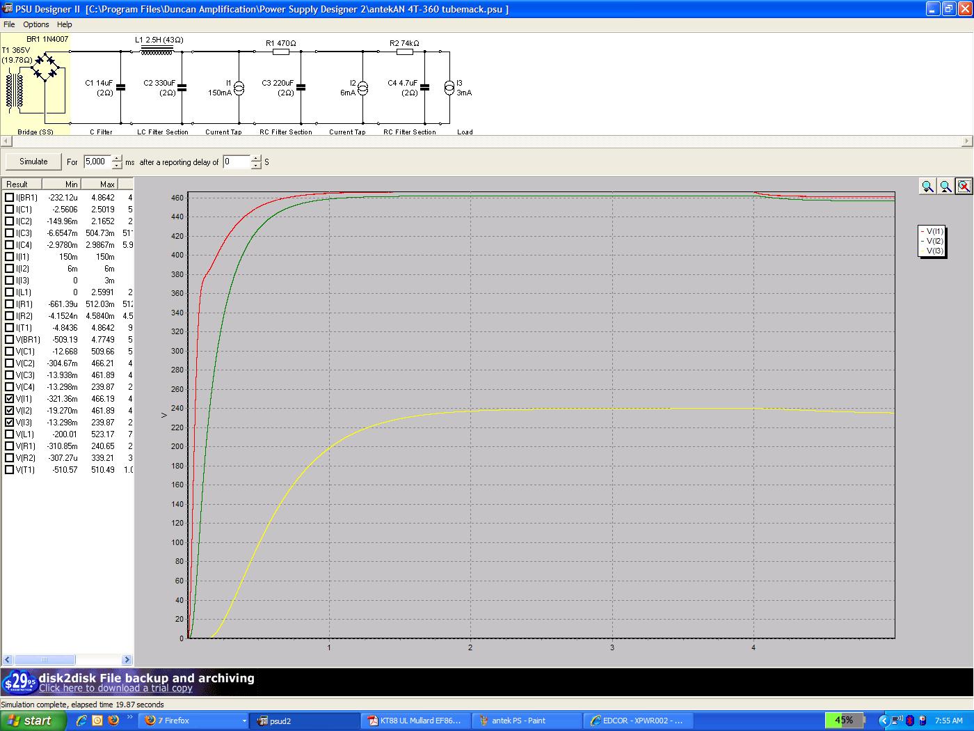

Antek 2T-350 based power supply
Well, I've been modeling the antek 2T-350 based power supply and I cannot get a B+ above 445V, even with the lowest R Hammond choke that I can spec (Hammond 193P)
I used the same currents as the existing Edcor based supply: KT88's=150ma, 12AT7=6ma, EF86=3ma
Inputting transformer parameters off of the datasheet gives a source impedance for the transformer of 54.6 ohms, which is limiting the B+.
I used an offload V of 353V, secondary R=72R/2 (parallel connection), primary V=120V, primary R=4.3R/2 (parallel connection), which yields a 54.6R transformer impedance.
Any ideas?
EDIT: I just modeled the Antek AN-4T360 and it would meet the requirements no problem. ripple V=150mv.

Taj: One other thing.....it looks like R1 in the existing supply needs to be 470R instead of 220R. (the R between the 465V and 460V taps) to get the 5V drop.

BW,
Would you kindly retry the 2T350 sim with the 350 V. windings paralleled and a "6.3" V. boost. Regulation effects will increase the effect of the boost winding, hence the quotation marks.
Given its 400 VA rating, the 4T360 could power a stereoblock. Hmmm, a 3 chassis setup employing the 4T360 is a possibility. Each of the 360 V. windings would be bridge rectified to energize a power amp chassis.

Eli: can you provide some detail on the 6.3V boost?
I think he just means to connect one 6.3v winding in series with the paralleled 350v windings for a total of 356.3 (boosted) volts.

That's correct. However, the boost will be more than 6.3 V. Those filament windings are rated for Amperes. The B+ rail draw is a few tenths of an A. Regulation effects will raise the boost, perhaps over 7 V. Use 357 V. in the sim. BTW, another consideration is that modern line voltage is usually 120 V. or slightly higher. AnTek's data sheet assumes 115 V. on the primary side. Yes, it's nickels and dimes, but they add up to enough (IMO).

The off load voltage data from Antek is 353V@120V. That's what I used as the transformer input parameters for PSUD, so I'm assuming that the line voltage nickels dimes are already collected. Using 353V+7V=360V gets the B+ to 456V, about 10V shy of the target.
Does series connecting the 6.3 winding reduce the secondary winding composite R? That would probably put this over the top if it reduced it a bit.
The latest sim is using a big-honkin' Hammond 193 enclosed series 5H/26R choke for minimal drop across the choke, so that will burn up additional $$ savings when comparing it to the Edcor/Hammond 159T solution. Of course this solution has twice the henries.

Boywonder, I have a XPWR033 which is an EDCOR 760VCT @200mA. The winding DCR to CT is 40.3Ohm. I can't see what value you are using in your sim maye that will help.

Thanks! I'm using 31R for the Edcor sim (best guess). I'll adjust the sim for 40R. Do you happen to know the offload secondary voltage and the primary R? This would help dial-in the Edcor based supply a little better.
Ok Primary winding is 1.2R. I will wire it in once the table is clear and get the no load voltage.

Eli: How do we boost the primary V? Not quite getting it....
The electric company is boosting the primary input (on your behalf) to 120v rather than 115v, so output (with the series winding) is about 370v before rectification, and 481 after.
