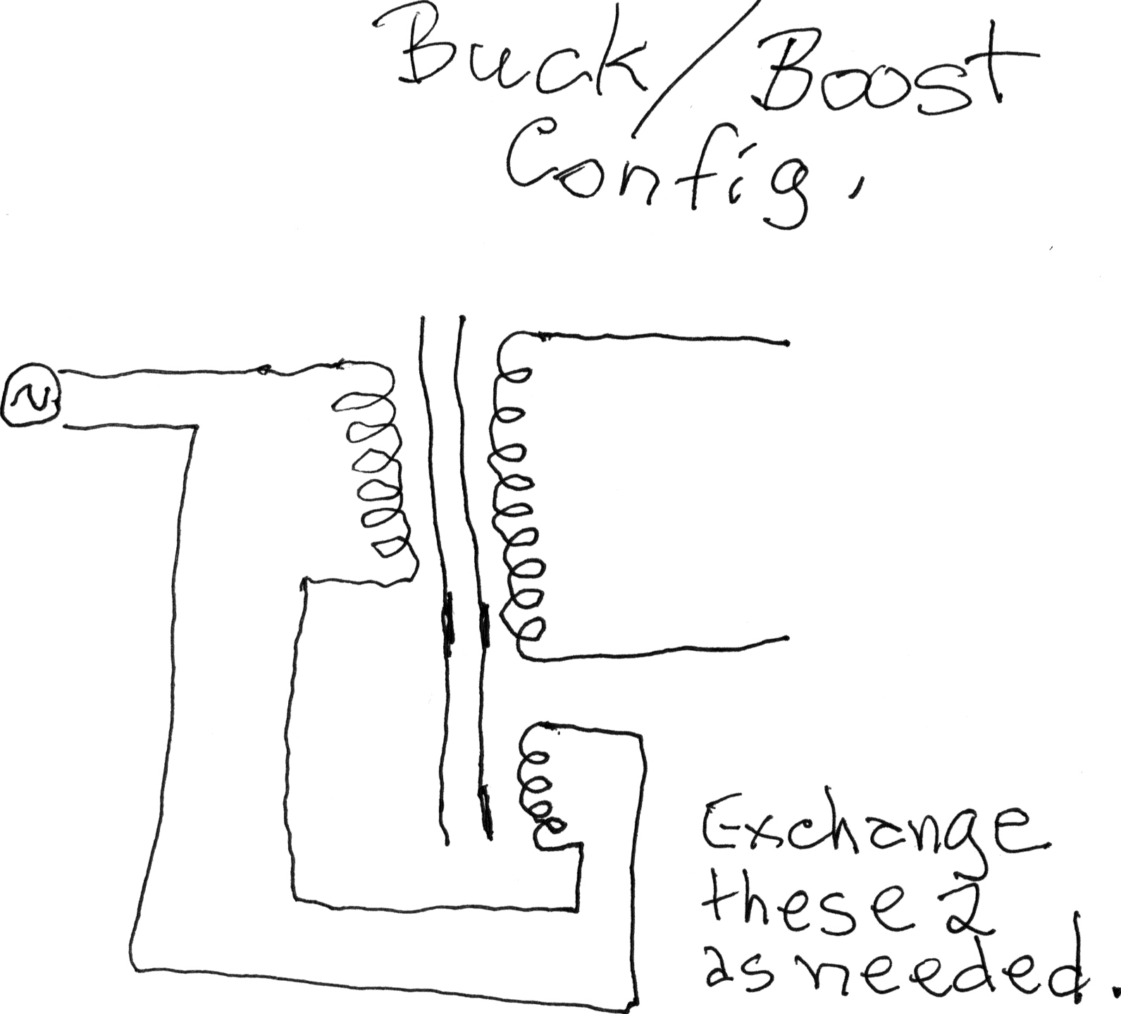

Eli: How do we boost the primary V? Not quite getting it....
Wire a "6.3" V. winding in series with the paralleled primaries. Of the 2 possible arrangements, 1 will increase the rectifier windings' O/P and the 2nd will reduce the O/P. These are known, respectively, as the boost and buck configurations. Obviously, we're interested in the boost configuration. Simple measurements, with a multimeter, will let you know when things are in order.
The line voltage doesn't change, but the effective turns ratio does.
boost and buck

Please refer to the crude graphic I've uploaded. There are 2 possible arrangements for connecting the low voltage winding. One increases the voltage observed at the rectifier winding, while the 2nd decreases it. Use a meter to obtain the desired boost configuration.
fun with windings
Got it Eli, thanks. Now we need someone to buy one of these, connect it up and get the offload V and primary and secondary R's for the model. If the other 6V tap is to be used for bias voltage multiplication, then a separate filament transformer will be req'd.
Or, alternatively, use the other filament winding for the heaters, and get a separate bias transformer like an Amveco 70035 or 62035, etc.
Mixing primary and secondary winding on a power transformer connected to the mains...
I think it's best Bud step in and advice you guys, I would not do that from a safety measure point of view.
No go! Like the rectifier winding, the remaining filament winding will be boosted. Voltage multiply that voltage, whatever it turns out to be, to obtain all negative rails needed. A separate filament trafo is a must, but SGregory wants to go that route, no matter what. I suspect he is planning some sort of power on sequencing.
sir, your winding is boosted...
Got it Eli......still absorbing. That appears to be the downside of boosting the primary, all secondaries are affected.
