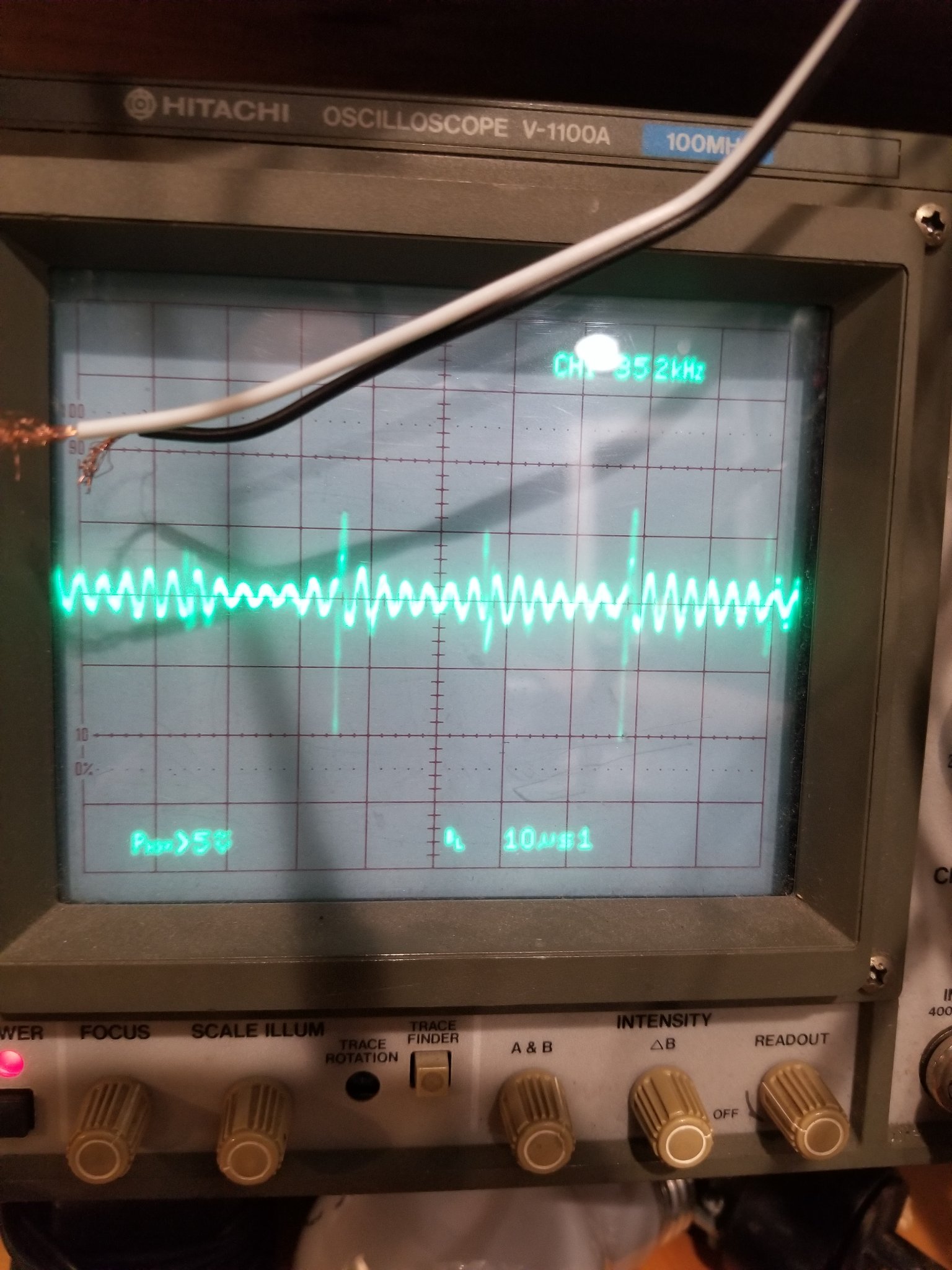

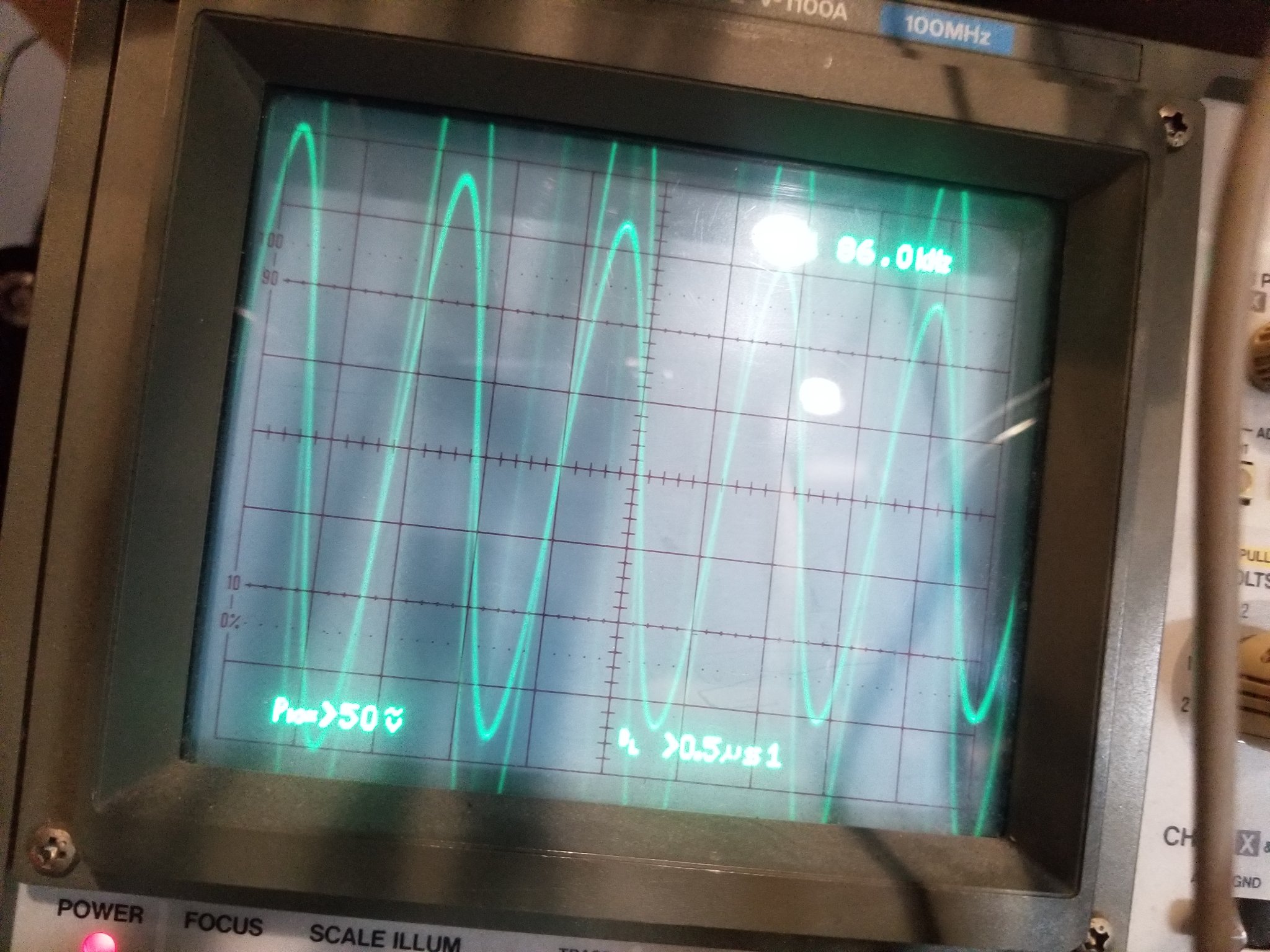

I am not really sure. With the setting you wanted me to measure it at it is very difficult to get a usable signal. The triggered light on my scope is randomly turning on and off while trying to take that measurement. I'm holding the probe on the shunt resistor and trying to get a better picture all while the power supply is screaming at me. While making adjustment on my scope I'm definetly seeing things I've never seen in the analog world. The best clear pics I seem to get are adjustments far from your recommendations. The first pic is at the shunt resistors and the second is from the output with a load.

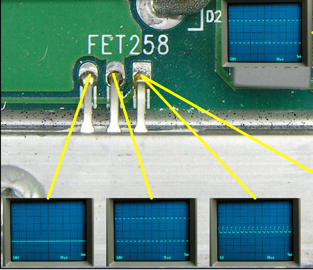

The attached file shows what I'd expect to see. The drain of the FET258 is directly connected to the shunt resistor.

Regardless of what I do I cant get it to produce that square type wave that your expecting to see. I think whatever is wrong with it is why it wont.

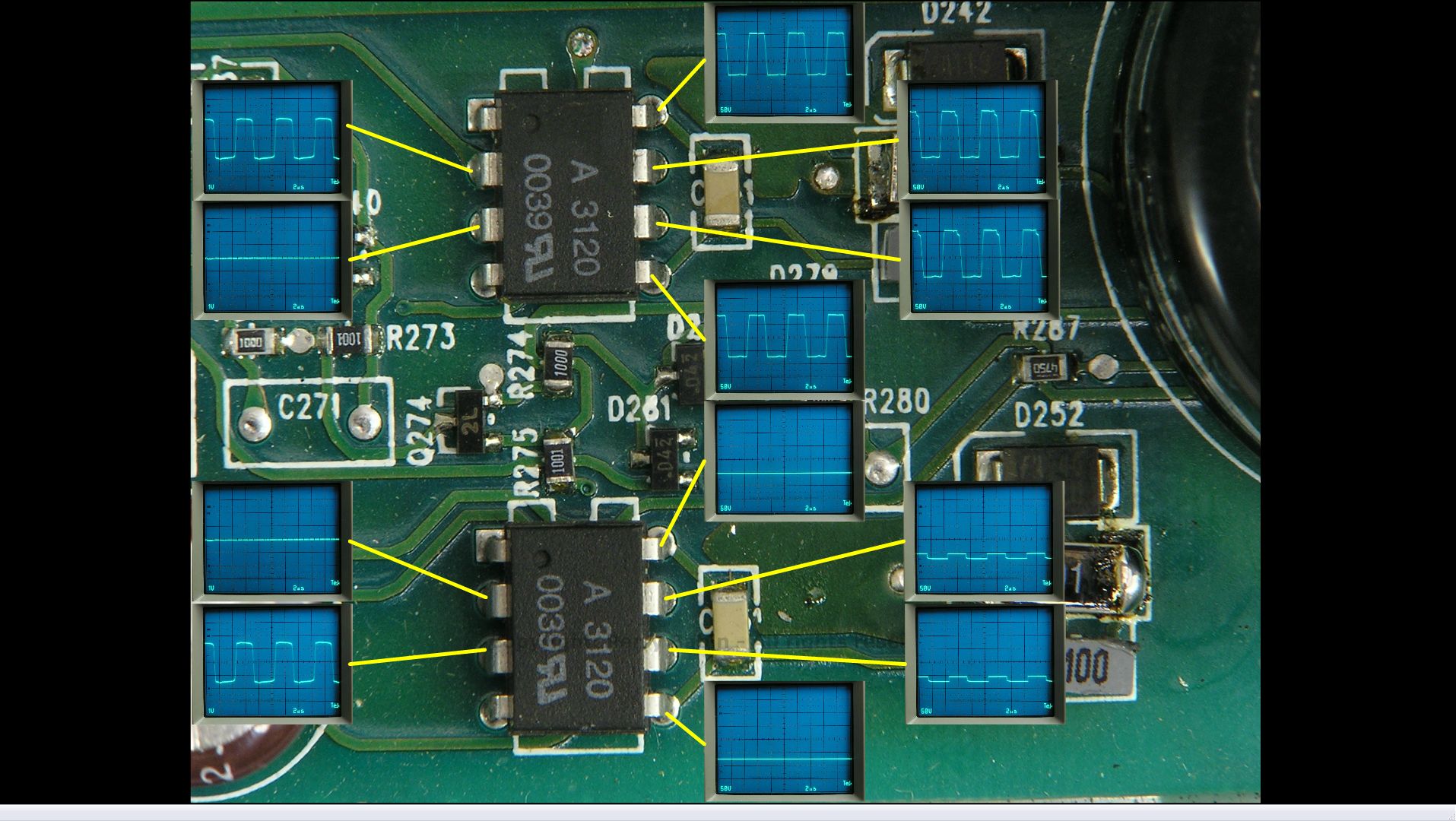

Setting the scope to 1v/div, look at both inputs of the two optocouplers. Do you see a clean ground (0v) on one input and a waveform of approximately ±1.2v on the other inputs (see attached)?

So I have my square wave on 5 6 7 8 of the one octocoupler and obviously on pin 2 as that's where I'm feeding it into. Pin 5 6 7 and 8 of the other one it is really tough too see if I do. There seams to pe a ton of noise on my bench prolly due to the power supply and amp powered up. Before feeding the wave into c230 I probed for that -1 volt on pin 4 and 8 of the one octocoupler and it is not there. Some of these I touch with my scope probe and the display on my scope disappears. Even zooming out it's not there. I am super confused as to why that is happening. To me it just looks like there is way to much noise on the bench to really get accurate measurements. I have my signal generator output turned all the way down as I'm betting it should be a very small signal. I'm starting to think this amp is not a good introduction to class d as a project ahhah. Or my scope is just too old. Idk but I've seen some very strange things on this scope the last couple days that I've never seen on any scope in the past. Maybe my scope is just not accurate at small voltages but I'd be hard pressed to believe that.
Now if I probe around again, nothing has changed. I dont have my square wave on pin 5,6,7,8. It's a messy 400khz wave that is present with my sg on or off.
Are you driving the input of the two optocouplers to get the ±1.2 (or a bit more) drive on both optocouplers like you see on the image?
