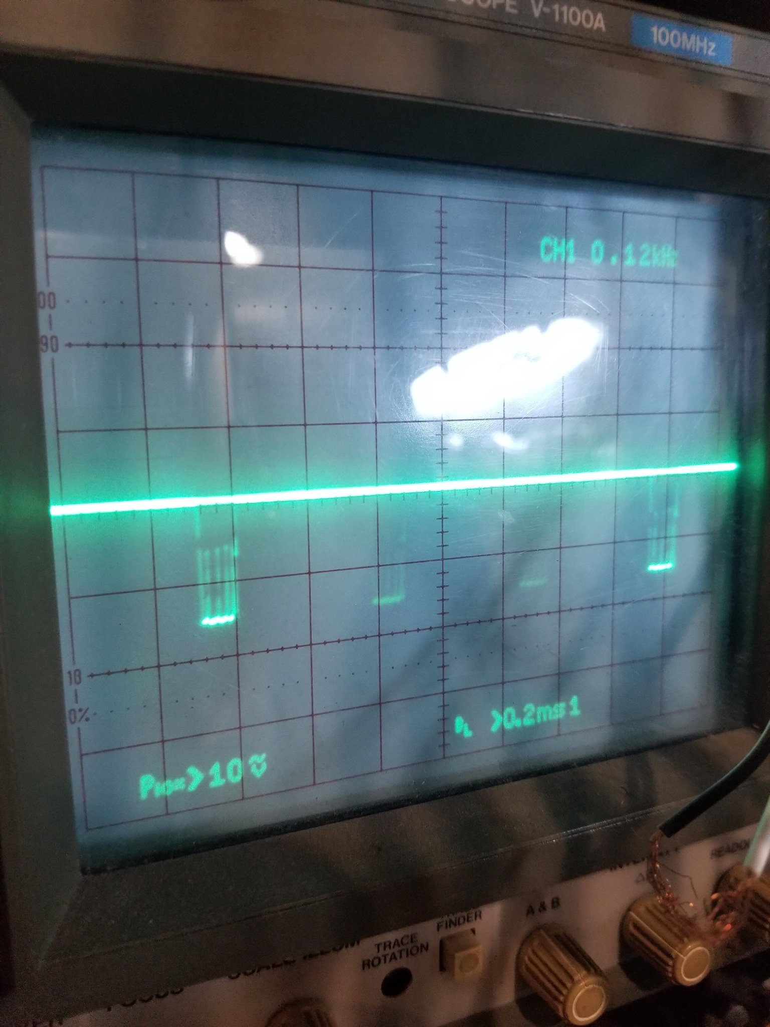

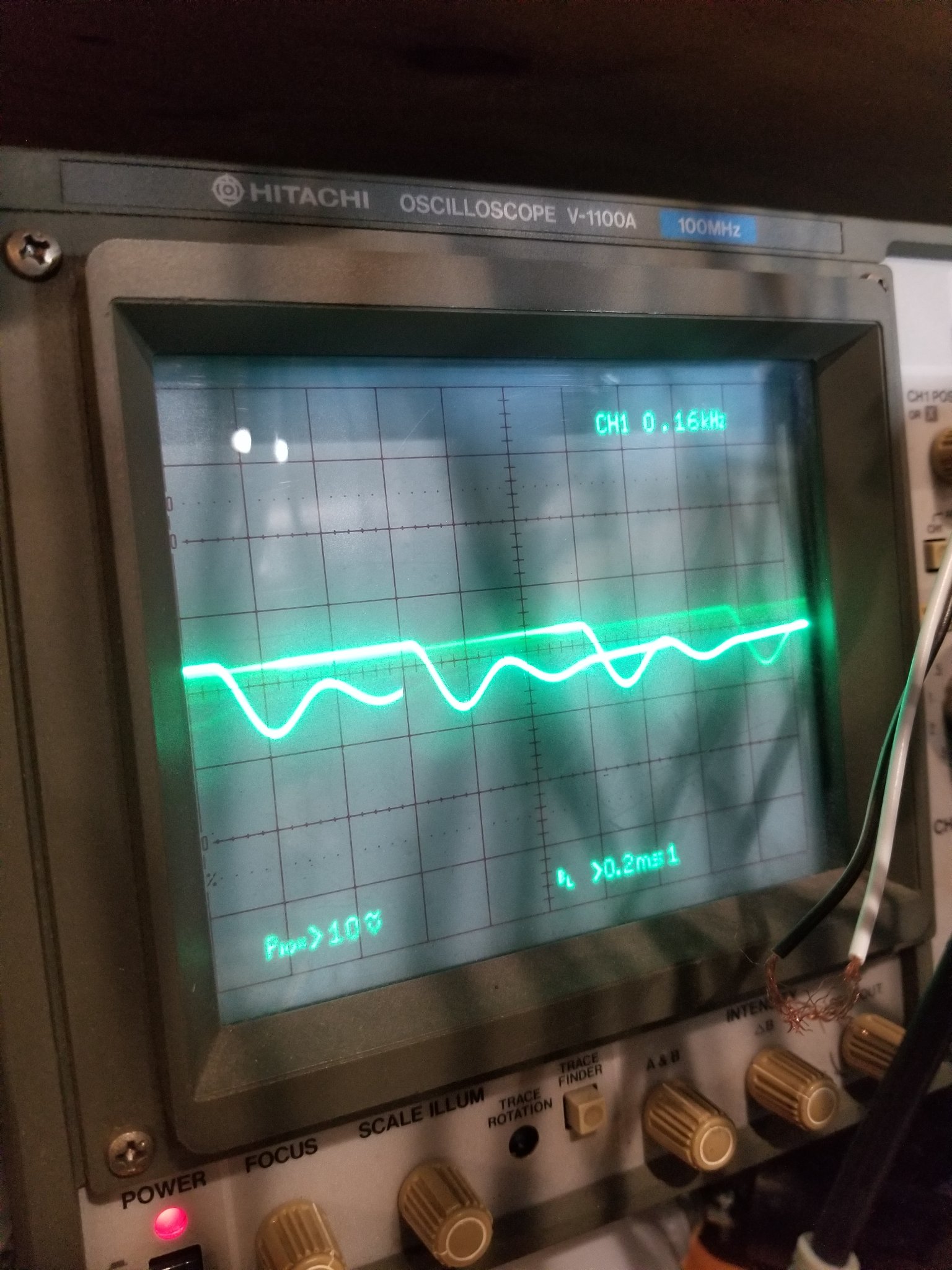

Ok so I wired the scope ground and probe right to the speakers output. I set my signal gen to 100hz and input it through both rcas. This is what is coming out. This is with bulbs removes from circuit and all four rectifiers installed.
If the signals on pins 5 and 6 weren't close to being identical, I would have expected pin 7 to have a much greater signal level. You wouldn't happen to have a 5532 or any similar op-amp on hand, would you?
You said you didn't work with ICs much. Do you need suggestions replacing (regarding removing) this one?
