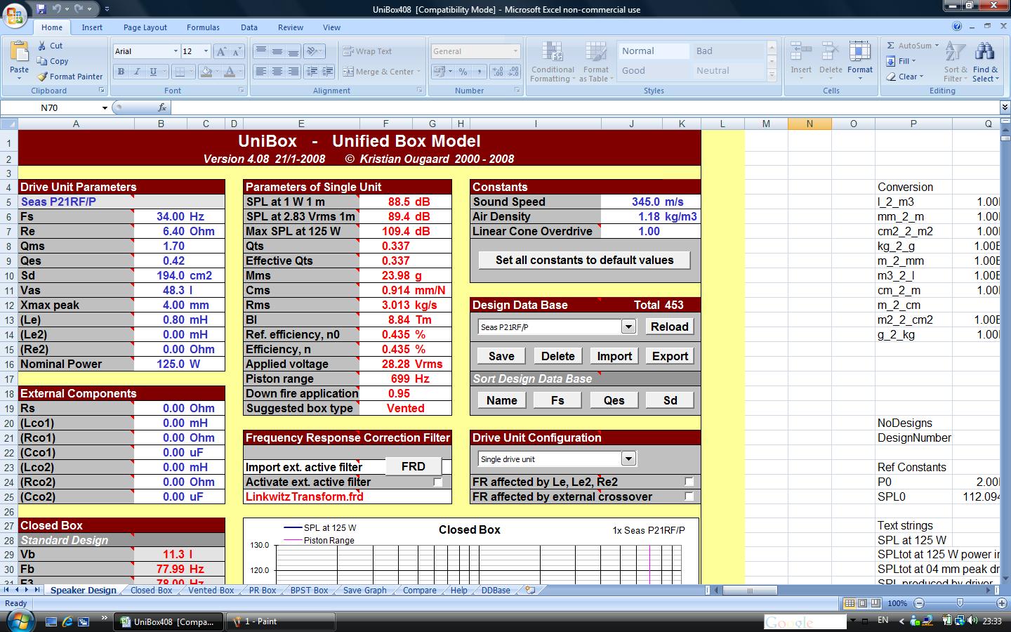

3) Model the enclosure and driver with what you actually built, incl length corrections to vents ie slots using bottom surface. (DL the excel spreadsheet 'Unibox' if you have MS office.

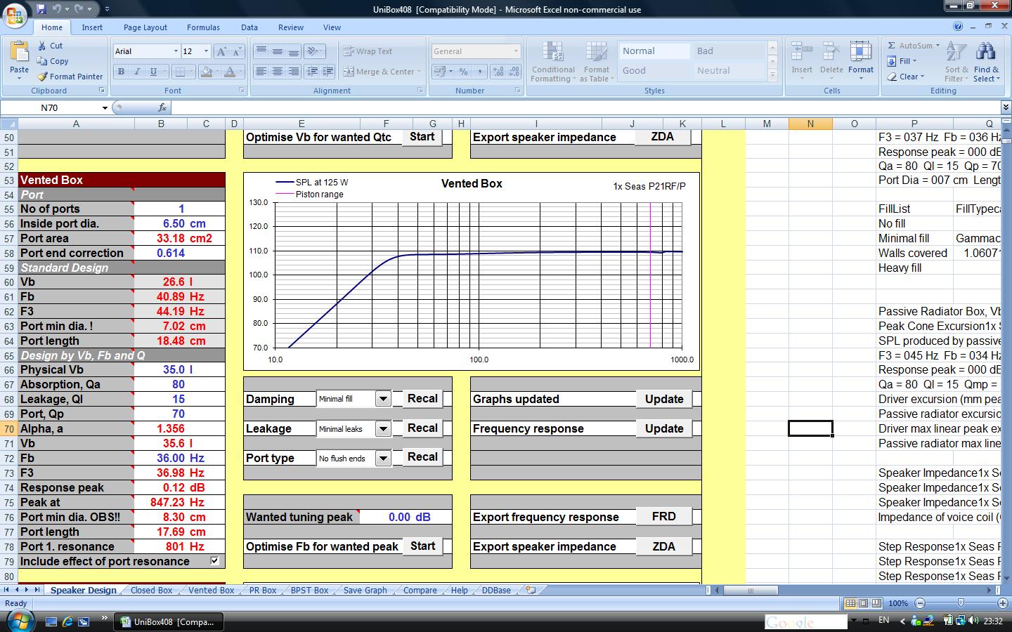

Also attached is the box simulation using the actual dimensions.
As you can see, I didn't use any external components (I ignored the bsc).
Moreover the target port freq seems to be 36Hz (I tried different values until got the port length i.e. 7inch).
The frequency plot looks ok.
Is perhaps 36Hz too low, making the bass too boomy?

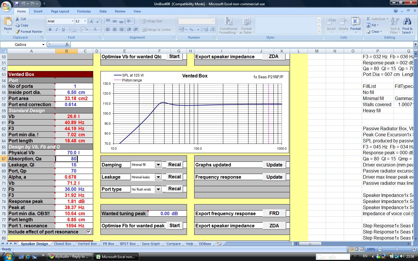

Finally I tried doubling the enclosure volume from 35lt to 70lt. I am not sure what the plots are telling me.
Yea I guess that's the process since not knowing the tuning targets,
I have converted the slot to tubular dimensions with corrections ie Vent diameter 4.7cm and Lv of 20.6 cm from earlier in this thread. you got something else? keep playing with this program (It's a learning curve)
Note > see vented tab at bottom for more charts! 🙂

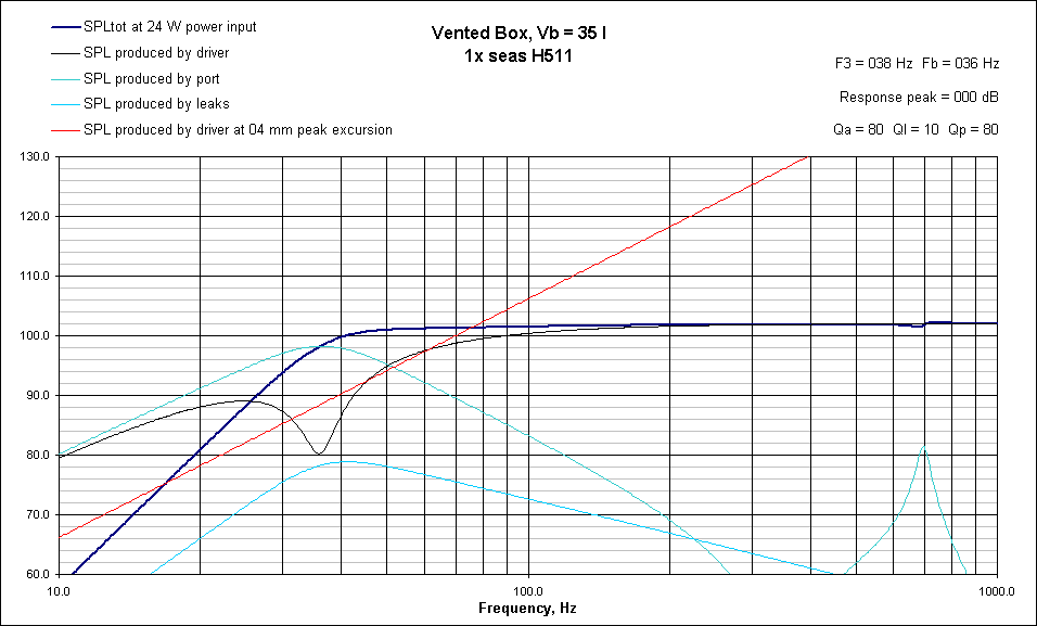

OK this is what I found
This is not a ported design. It's more of a leaky box to tame any LF impedance peaks,,, so response is close to a closed box F-3dB ~ 70-75 Hz. Explains things here, unless I screwed up on port area calc/conv.
My recommendation is to convert to a ported design. Vbox=35l Fb=36Hz
Keep length of vent of 7" and open up the front area to be equal to a 7cm diameter. (10.5"x1 1/8" )Should have lots more bass and not booming type as some ported designs. You may loose some SPLs tho> max power for low distortion at rated Xmax is around 25Watts, so use power amp of 50-60 Watts for 3dB overhead.

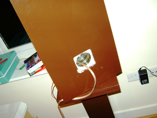

3) I put polarity back to original and did my final test. Removed some stuffing material from the speaker and I filled the rect. vent with stuffing and blocked the slot with a piece of wood. I used the input cap opening at the back as my new vent. Okay here comes the embarrassing bit.
I used a big nescafe box as my new vent! oh yeah! It's about 4,5" deep and has a dia of 3,5". I removed the bottom with a can opener... This gives a tunining freq of about 53Hz in unibox. There is a bit of a step as the input cap is a bit smaller but never mind. I secured it with some gopher tape trying to close any gaps and run the input cables through the "vent", hooked it up and prepared for an audition.
Not bad at all! The low freq have even more body now. That is very strange as i was expecting less bass. As for the paper colouration, it's improved. I wouldn't say it's completely gone but it's less notable now. The speaker has a different character now it sounds more airy- less harsh. Not bad at all for a nescafe box, eh.
