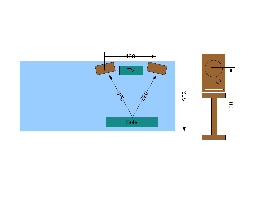

This is my listening arrangement.
Possible known problems:
- Speaker stand too tall
- Distance between speakers and my ear is only 220cm
- The port has not been flared and the corners have not been chamfered / rounded
As an amplifier I use either a Sympatico or a UcD400. To be honest I can't hear substantial difference between the 2 when playing at the same volume levels. This leads me to believe that either I am deaf or the speakers limit my system.

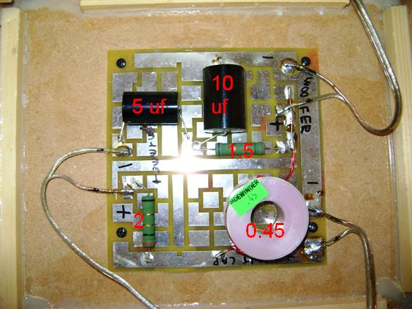

Hi the crossover is a series type with 1st order. Just as I suspected the madisound design doesn't have too much Baffle Step Correction. But your listening placement is with the boxes next to the wall and mostly near-field so it s/b OK. The only thing I can think of...off the cuff... of is a room mode is giving a null point at a key bass point. I could give you a new crossover to try... mostly a parallel type, 2nd order with lots more BSC (bass).It could be modified to your box and the tweeter level would have to adjusted to taste and your ear/room furnishings. But then it m/be too much bass for your placement and music?
Your comment of paper sound s/b investigated further with more stuffing first directly behind the woofer and away from the bottom vent. You can experiment yourself with variations of box stuffing and room placement before you decide.

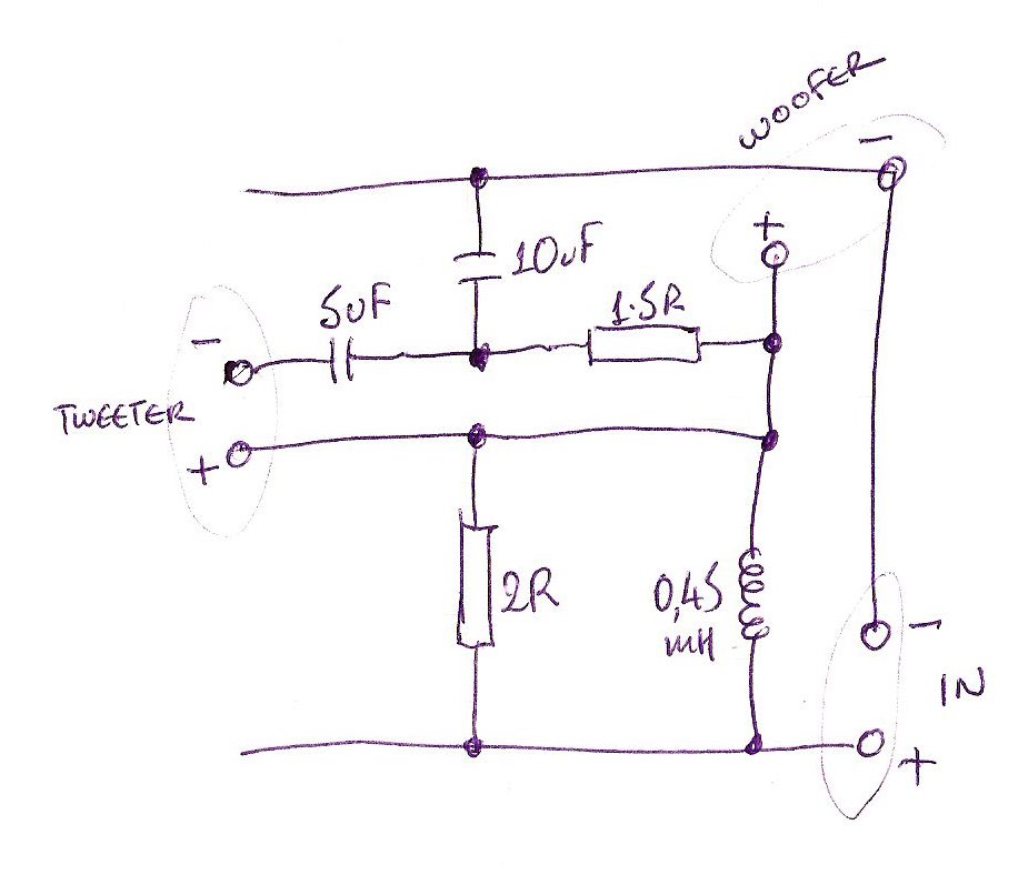

That doesn't look like a very likely schematic.
You would have to take a pic of the back of the board also to see if there are any connections.
My suggestion, if the bass is the only issue, get a sub.
Yea it looks weird at first (series type). The only thing wrong is maybe the value 1R5 might be 15R. Chatziva can you verify that?
I was wondering if it might be series. I blew it up and the board isn't thru hole so there shouldn't be any jumpers on the back. Madisound is not known for putting much baffle step into their designs and they can sound a bit lean. If there is any damping within 4-6" of woofer, remove it and see if it gets better.

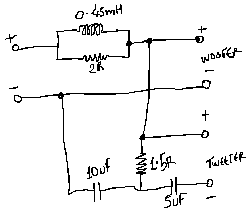

I can't figure out how this bloody crossover works.
By looking at the positive rail, the only that's between the input + and woofer + is the 2R resistor and the 0.45mh inductor in parallel. If I am correct this forms a highpass filter.... why on earth there's a highpass filter behind the woofer??!?!?

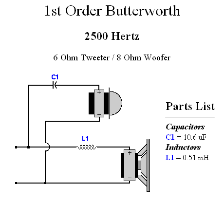

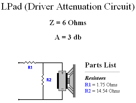

another thing that I did was to calculate a simple 1st order crossover with and L-pad and 2500Hz crossover point. See pics attached. This gives a crossover with part values that are remarkably close to the standard crossover (except that 14.54R resistor...could this 1.5R resistor be wrong????)

....... (except that 14.54R resistor...could this 1.5R resistor be wrong????)
Hi
That what I thought...it seems awfully low... infact giving the woofer a semi 2nd order cross.

Yea this is an unusual crossover
