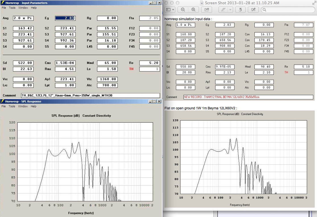

Hi, I've taken the models you provided and adjusted them for xmax cone displacement in the passband:
MTH30, B&C 12CL76, 6mm xmax, $162, 7 lb driver
15" Dayton HO (ported, 2.5 ft3, 39.5hz tune), 12mm xmax, $172, 24 lb driver
As you can see, the xmax limited output potential is quite comparable. Yes, I understand that the dayton is seeing over the rated RMS power in this scenario, but that doesn't matter unless you want to play test tones at xmax. The ported dayton extends to a bit below 40hz, a solid 15 hz lower than the MTH30, while having a much more pleasant response curve.
Sure, there are more capable drivers that could be used in the MTH30 to increase output, but there are also plenty of 20+ mm xmax 15's around for more money. And there's no way to get the mth30 to do anything below 50hz.

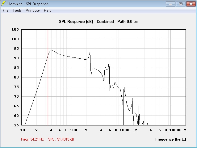

I've also attached a sim of the HO 15" at the actual 35hz tuning that mine ended up at, which extends to about a 34hz f3, while losing less than 1db sensitivity vs. the original model.
If only it were so simple 🙂
Vented alignments and THs behaving very differently when the volume is turned up. Vented alignments tend to suffer from compression at higher volumes (the output from the vent is non-linear unless the vent is very large, and at higher volume levels the output from the vent is less than you'd expect it to be). Furthermore, you're running the vented alignment at a higher power level, which means that you're going to have more power compression due to voice coil heating as well.
In the case of the TH, the whole box is just one big massive vent, so vent non-linearity is much less of an issue. Secondly, you're running it at a lower power level than the vented alignment to get the same output, so power compression is less of an issue. And finally with most THs, the driver is mounted magnet out, resulting in the magnet sitting in an area of maximum velocity (at or near the mouth), so it's going to get a bit more cooling than a driver in a vented alignment, where the magnet is basically sitting in the box, uncooled by any air flow.
The end result of this is that, even if the predicted output levels at Xmax between the two alignments may be similar, the predicted peak output of the TH is likely going to be a lot closer to reality than the predicted peak output of the vented alignment, and by several dBs too.

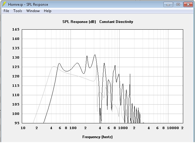

Furthermore, I just happened to come across this design for a 21" ported PA sub that remains somewhat portable. This another good example of a properly designed bass-reflex box.
Data-Bass
This custom bass reflex system was designed around the B&C SW152 driver to be used in a portable PA style system designed for sound reinforcement where abnormally low bass extension was required. Typical pro bass bins roll off below 40Hz or even 50 or 60hz in some cases. The extension is sacrificed for efficiency and output. This system was designed with an eye towards useable 25Hz extension, high output, the largest vent that could realistically be used to avoid compression and noise and still remain portable. The target tuning was 28Hz, but the proximity of the vent opening to the back wall of the cabinet lowered the effective tuning to about 25Hz instead. Still the cab exhibited very good efficiency over its effective range and exhibited powerful overall performance. Useful output to 20Hz was realized coupled with large amounts of headroom above 30Hz and very low distortion levels.
The response has a roughly 3db peak at the vent tuning at 25hz but this is flattened out with the addition of a 25Hz high pass filter. At high output levels vent compression also reduces this peak, despite using a 10" diameter pipe wih a 1" round over on both ends. A 25hz steep high pass filter was engaged to prevent excessive cone excursion below the tuning and also flattens out the peak at tuning.
The maximum long term and short term output both are very high at 25hz and above. There is even a large amount of output at 20hz still which is below tune substantially. There was a slight tapping or over excursion sound that developed near 30-35hz at the loudest levels. There was some grill buzz evident but no noticeable vent noise at the highest output levels achieved. The compression performance for this system is also quite good even at the highest power levels used. Notable vent compression is in evidence though, plus this is an area of high power and low excursion for the driver so it is usually a double whammy for reflex systems. The distortion performance is also very good up until the final nominally 127db output sweep where the driver seemed to hit over excursion briefly near 32hz. Even at the 125db nominal sweep level the THD was below 10% everywhere above 18Hz! The THD skyrockets below the tuning which is typical of resonant systems.
