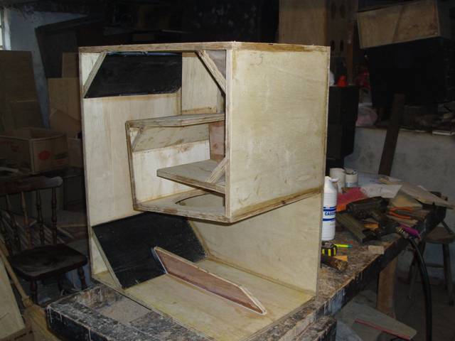

If you look through the link threads, you will see the only pictures I currently have of the Welter Systems Lab 2x12".Like I say, I dislike paying twice a lot more than I dislike paying for the right thing.

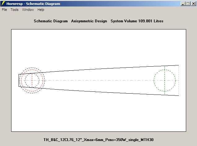

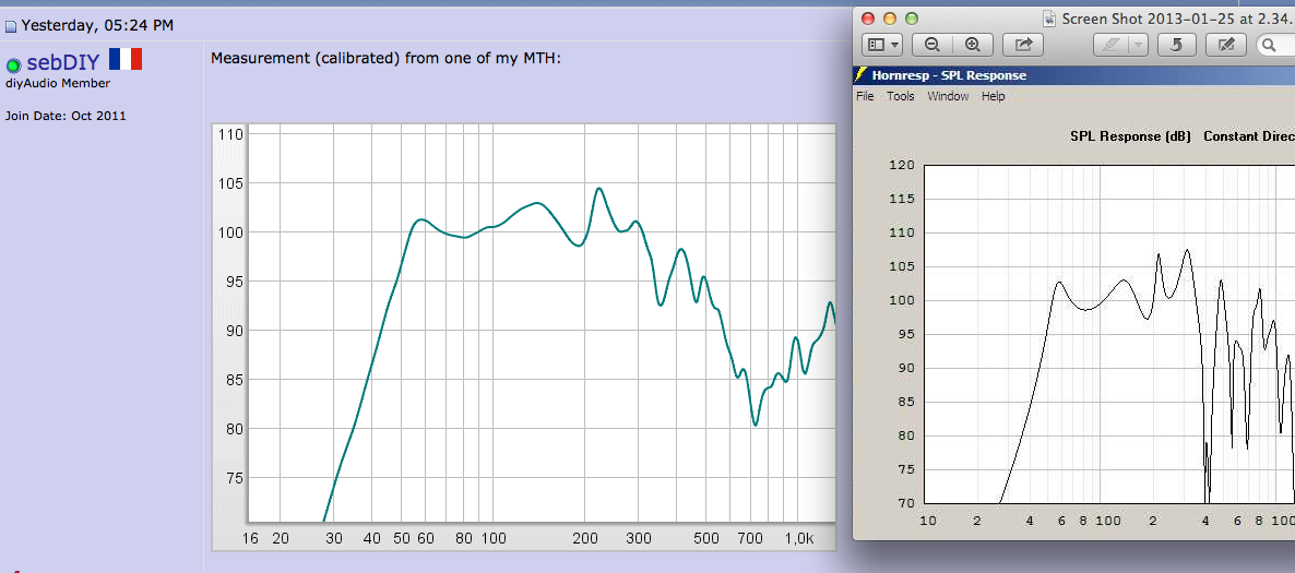

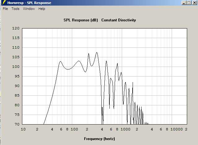

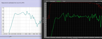

Measurement (calibrated) from one of my MTH:
Hi sebDIY,
Thanks for that. It basically confirms the Hornresp simulation (real life smaller peaks, etc.). How high up do you use it?
Thanks for posting the chart, what were the measurement conditions?Measurement (calibrated) from one of my MTH:
What drivers did you use in your cabinets?

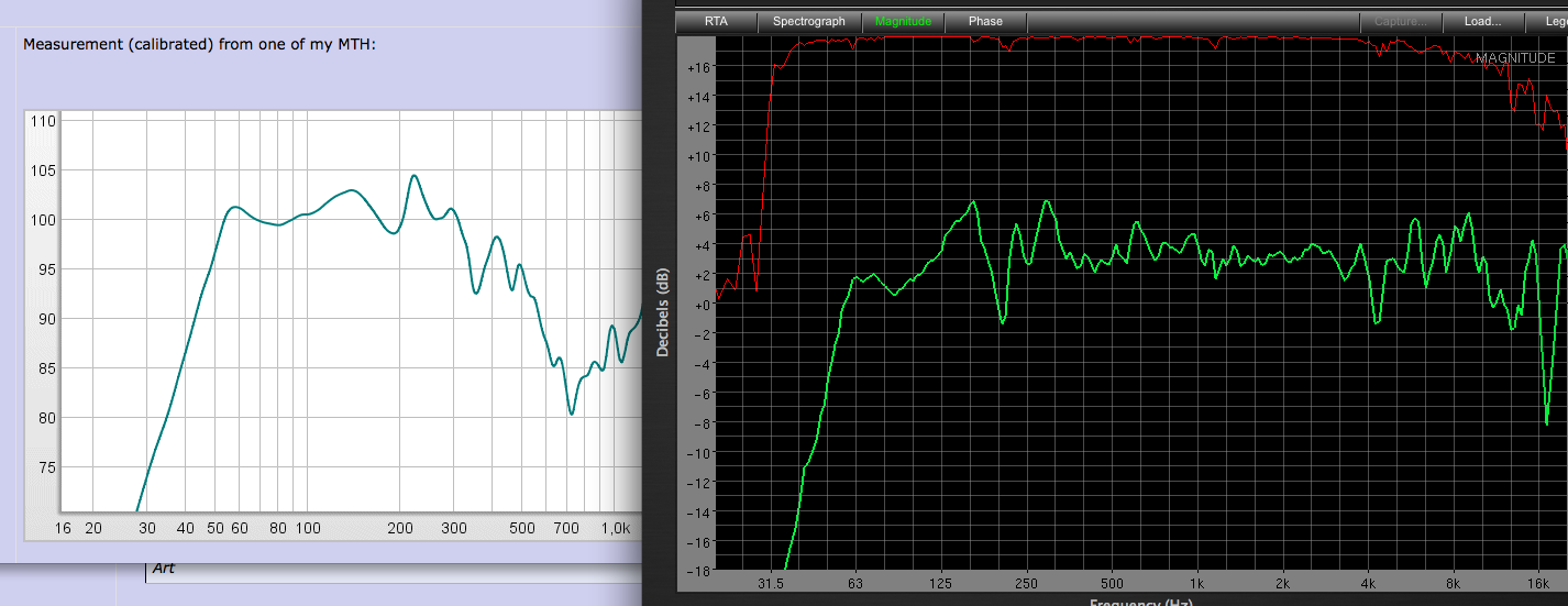

Looks like a classic example of Hoffmann's iron law, low, loud, small, pick two🙁.
In your example of the MTH, the lower octave of typical pop musical bass is sacrificed for small and loud, response is 25 dB down around the low B (31.5 Hz) on a bass guitar.
As usual, smoother than Hornresp would predict.
I want to see the impedance response curve. That will show how close the sim matches the actual design.
For my use it's perfect. I was searching a light cabinet (mine is 23Kg with ferrite driver, this is the lightest of all cabinets I've tried), searching also clean sound, and it is, with ability to make strongest level in this size. I have compared with some 18" bass reflex. The 18 BR goes lower, but MTH-30 makes more level and is more dynamic, also lighter and smaller.Looks like a classic example of Hoffmann's iron law, low, loud, small, pick two.![]()
The loudspeaker is LF12G301 RCF, measurement groundplane 2 meters without any wall into18 meters perimeter
Without any any eq, you can cross at 110/120hz without hearing any ugly resonance, but I think it is usable above 120Hz with Eq cutting peaks. I know some people cross it 150Hz. I use most of the time for wedding: 2 MTH-30 and 2 ZX1 EV. I have made 200 people without any problem in this configuration and I think it can do even more.
Oliver's (TB46)Hornresp FR peak and dip locations matching senDIY's measured peak and dip locations indicate the sim matches the design very closely.I want to see the impedance response curve. That will show how close the sim matches the actual design.
I find it interesting that most in the DJ and PA business are perfectly willing to trade LF extension for SPL.

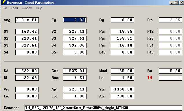

Given the simulation results and measurements here, I'm not seeing a lot of difference between the low frequency extension of the MTH30 and the THAM12, which is a bit smaller. I also notice that hornresp really considers only the dimensions of the horn and the properties of the driver, and how the horn is folded, holding all else constant, doesn't come into play in the sim. I have no sense of how the quality of the horn fold impacts real results, but, given what I've read elsewhere on this forum, performance is relatively insensitive to small deviations holding all else constant.
Consequently, it appears that I can trade off some SPL for LF extension in the THAM12 by just making the cabinet about 3 to 4 inches taller. After that, it appears to be diminishing returns for additional length. I simed this using the 12PS100. Looking at the design, it seems that I could scale the height in the build plans fairly easily without dramatically affecting the taper of the horn or any other critical dimensions. Anything that I'm overlooking here?
Finally, I haven't sim-ed it yet, but, I'm leaning towards the B&C 12NDL76 for weight reasons. Any thoughts on this, are there any other good choices of driver in the 10 pound range that I should consider? In particular, is there anything less expensive that would work almost as well?
