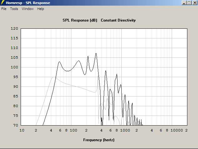

Attached is a SPL comparison between a Dayton RSS390HO-4 in a bass reflex enclosure (V_net=2.5ft^3) 1W/4Ohm, and a B&C 12PS100 in the MTH30 @ 1W/6Ohm.
I would go with the MTH30 between those two. The MTH30 should be good to at least 160Hz.

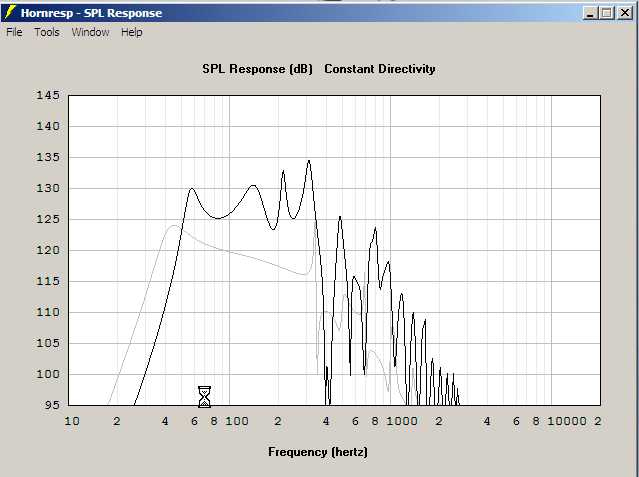

That is a very peaky response on the mth30, if it had a flat response it might be around 100 db in 2pi.
Also, i said output not sensitivity, the 15" dayton has over 50% more cone area and twice the xmax. I would like to see a comparison with the drivers at xmax, please.
Btw, when simming for the actual 35hz tune of my built subs, it sims to 94db with a f3 of 35hz. Figure 34-100 hz 92 db/w/m/pi +/-2db. I get actual strong in room response at 30hz.
Hi turbodawg,
Post #52: "... my built subs, it sims to 94db with a f3 of 35hz..."
I just went by your previous volume and SPL remarks, it doesn't matter much one way or the other, the big difference is in the enclosure technologies. Anyway, I'll attach another 'quick and dirty' SPL comparison, and the Hornresp export files if you want to do any more work with this. As you will see, it is not even easy to say "at Xmax" or "at rated Pmax(?)".
  • MTH30_X.txt
    MTH30_X.txt
  • 390HO_X.txt
    390HO_X.txt
