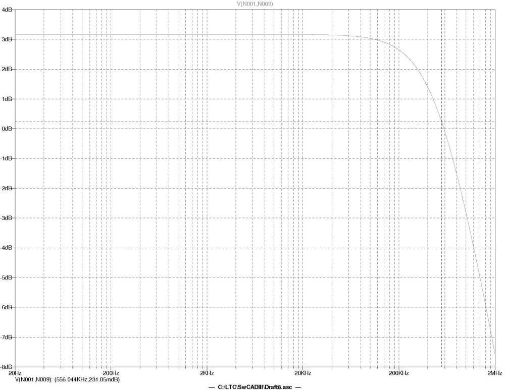

Btw, what exactly does the filter in the Ballsie do? I've been trying to access the wolfson datasheet to find out, but for some reason can't connect to their site right now.
The datasheet doesn't explain the circuit at all, nor does it provide much information on the internal lowpass.neb001 said:
Same here, I'm curious to hear how the Ballsie compares vs the Zapfilter. With my limited understanding, it seems the two are basically doing the same thing.
Without analyzing the circuit in question, I would guess that it's a lowpass tuned to a lower frequency than the ultra conservative (to keep responses flat) builtin analogue lowpass filter. This would serve to filter out additional digital noise and improve SNR and THD+N. How much, I'm not sure. I'd guess a few dB SNR at least.
My own question: how does using the builtin filter scaling affect sound quality? Are these digital filters going to lose bits when attenuating the signal, or are they past the stage where that matters (I'm really not totally clear on delta sigma operation...but is this filtering process not what converts the 24bit input to 6bits for the DAC itself anyway)? If so, with the impressive specs, I may add a passthrough input to my preamp project and seamlessly control the DAC IC instead of the PGA2310...

1) The main design goal for ballsie was to provide balanced and SE outputs at the same level from the DAC, and to allow for filtering all while presenting identical load to both parallel DAC outputs when used in dual differential mode.... phew... 🙂 One other design goal was to be able to drive SE and BAL simultaneously from just one DAC while still providing optimal loading to the DAC and not compromising either signal. If you drive a Balanced amp from an Opus and tap one of the outputs(say out+ from each side) for something like a subwoofer amp, then you are loading the outputs of that channel differently. This sorta defeats the purpose of a balanced output. 🙂
2) Ballsie is not exactly the same filter as either of the filters (there are two) found in the datasheet (but very close). It is actually a hybrid of the two. I will graph the response and post in a bit.
3) I do not find the ballsie filter necessary at all, but some may like it better, so I chose to include it. In fact the DAC sound great just directly coupled to an amp using the DAC's internal volume control. I look forward to some long tests with both the filtered and unfiltered ballsie though. 🙂
4) The digital volume control works extremely well and does not appear, at least to me, to have any serious drawbacks. In fact I would say I am finding the presentation possibly a bit more dynamic then it was going through an attenuator. Now that said, you should know this... ANY analog device has a certain degree of noise present on the output. A DAC is no exception. One benefit of using an attenuator and/or preamp is that the output from the DAC is always full scale. So the audio signal is present at a much larger level than the natural device noise. To comfortably listen to the DAC you have to attenuate the signal, this attenuates both the noise and the audio signal and since the noise is already tiny and it will get even smaller you get lower noise floor with an attenuator than without. When you use the digital volume control you loose this "noise attenuation", the signal is attenuated, but not the noise. Now, this is not actually very worrisome as my testing so far proves that the noise output of the DAC even direct couple to an AMP is very very low. I can't hear it. These facts are also true of other analog devices (say a phono stage). What it means to you, potentially, is if you goal is the absolute lowest possible noise floor at very low listening level you will likely want an external attenuator like the Joshua Tree. Wow thats a long paragraph.
5) I spent yesterday doing some A/B tests with both the slow filter roll-off and the normal roll-off. So far I can't say I like one more than the other, but I am going to leave it in slow roll-off mode for a week or two, then switch back to normal and see if I detect a difference then.
