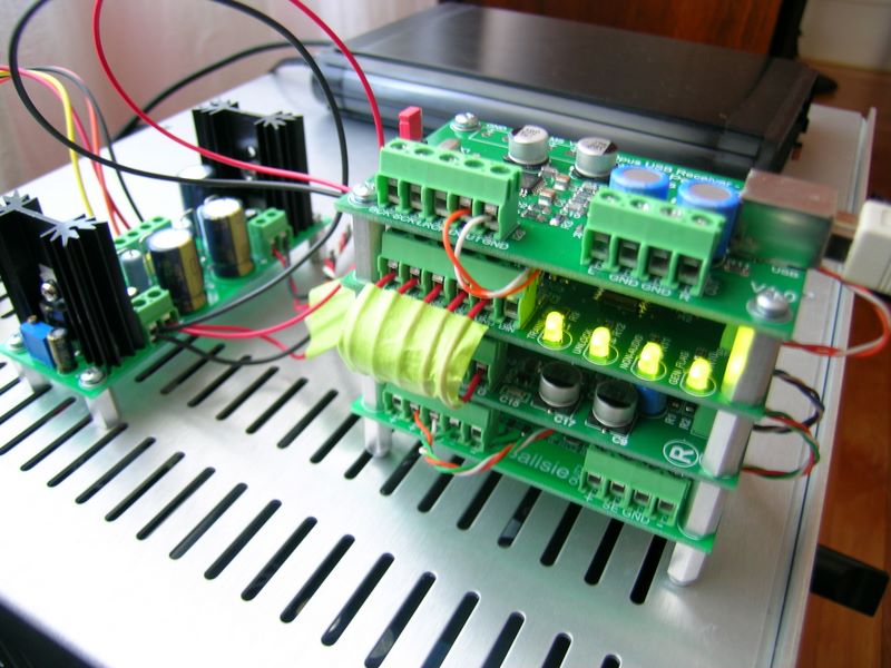

BrianDonegan said:Dac/USB/Ballsie stack, along with LCPS and new Dual supply for Ballsie.
That looks far to tempting to ignore.

esting USB (S/PDIF Out) -> WM8804 Receiver -> DAC -> Ballsie (not connected)...
This setup was really just to test the USB S/PDIF out mode. If used in this config, I would use the USB I2S out => Receiver I2S In (dejitter) => DAC (I2S)
[EDIT] Actually, not sure if it's possible to do this (I2S in and out at the same time). Will test it tonight.
