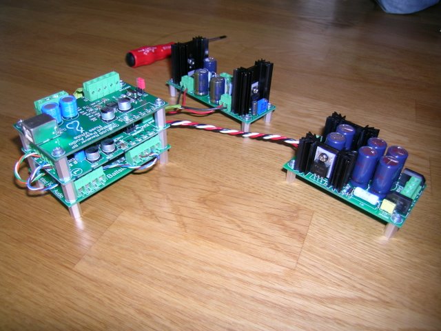

USB Module, DAC, Ballsie stack with supplies, getting ready to test the Ballsie out. Tested configs will be:
Balanced out, no filter (balanced output buffer)
SE out, no filter (Bal-SE converter/buffer)
Balanced out with Filter (filter/buffer)
SE out with filter (convert/filter/buffer)

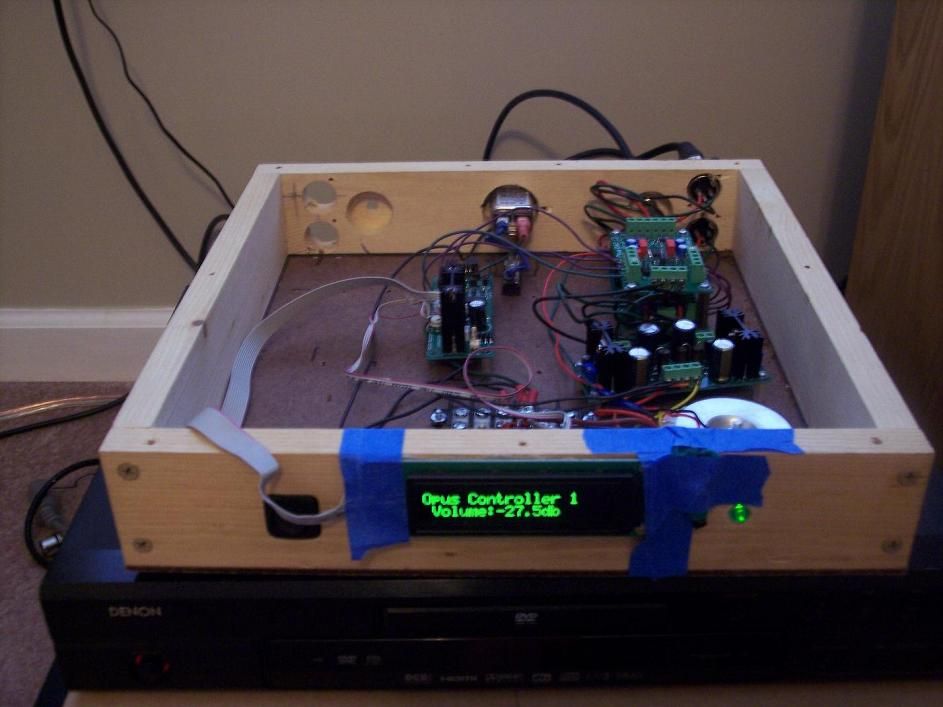

Just wanted to show my test rig using a uC to control the Opus. Basically it just initializes it and sets the volume via IR (phillips RC5). I also coded a mute function. It will also have rotary encoder(gray code) input as well.
This was just for kicks. Later I will interface the Opus with uber controller. 🙂
I have the DAC directly DC coupled to a TXO-2. This sounds freakin incredible. :yes:
Cheers!
Russ

Dougie085 said:
Any idea when that LCD controller kit is going to be ready? I'm very interested in that thing 😀
Well what you see there is really a hacked up Joshua Tree Controller. 🙂
Controlling the DAc is actually wicked easy if you can program a PIC. There are just 5 registers, and they are actually pretty intuitive.
I can send the code to anyone who is interested. It not yet perfected, for instance I have not used the interrupt pin effectively yet. But it is certainly serviceable and will get you going in the right direction.
Cheers!
Russ

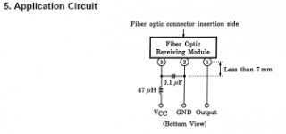

Has anyone been able to get optical in functioning? I looked at the data sheets for my torx receiver and the cs8416 reference board to figure out how to hook it up. I've got the output of the torx going through a .1 or .01 uF x7r cap (forget which) and connected to the receiver side of C4 (easiest spot I could find for input directly to RX0). It doesn't work, so I thought I'd try to get some ideas here (yes, I have a voltage regulator using the proper circuit to power the torx).
