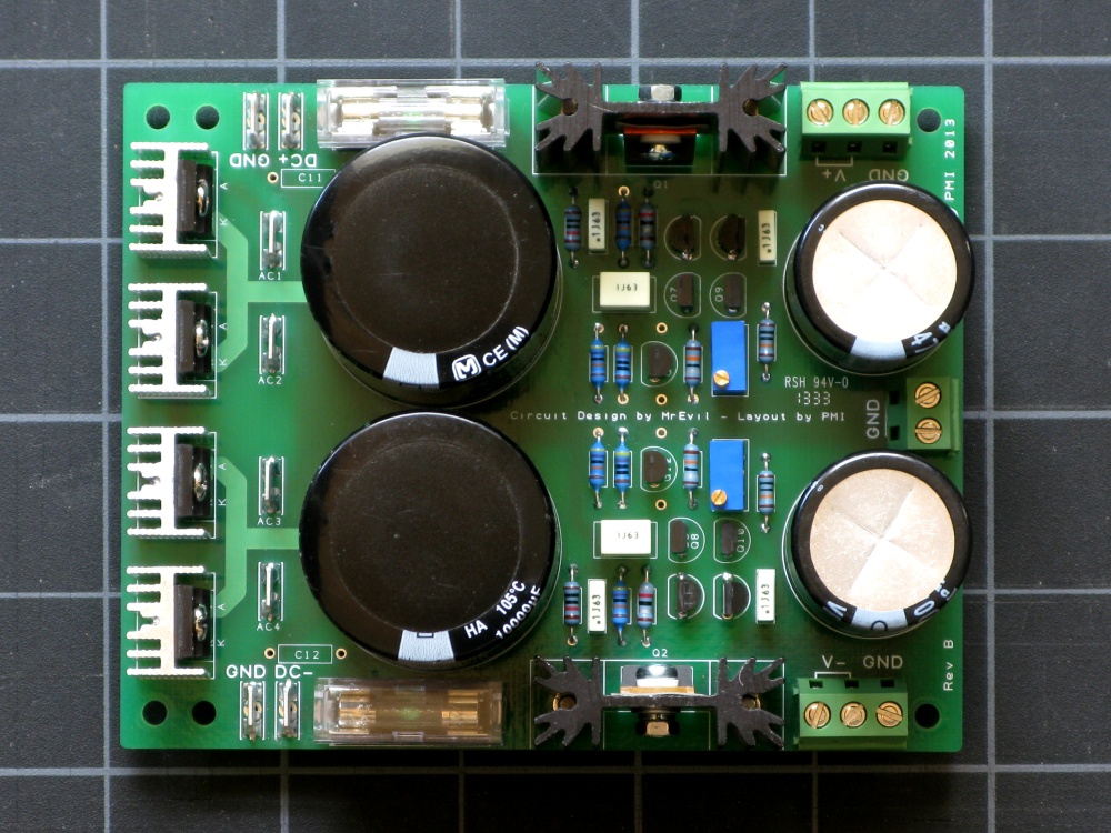

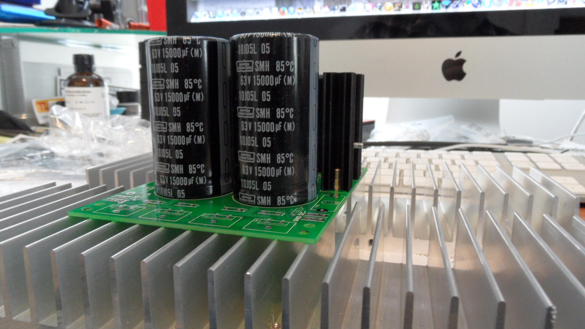

With all the filter caps you have, there does not necessarily have to be a very high Vdrop at the pass transistor.I'm in the middle of fitting larger heatsinks as the increase in voltage across the pass transistor in the CMx made them REALLY hot, and don't want to 'let out the smoke"!

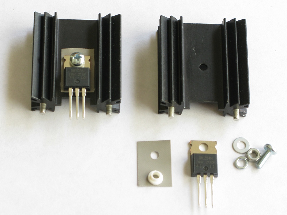

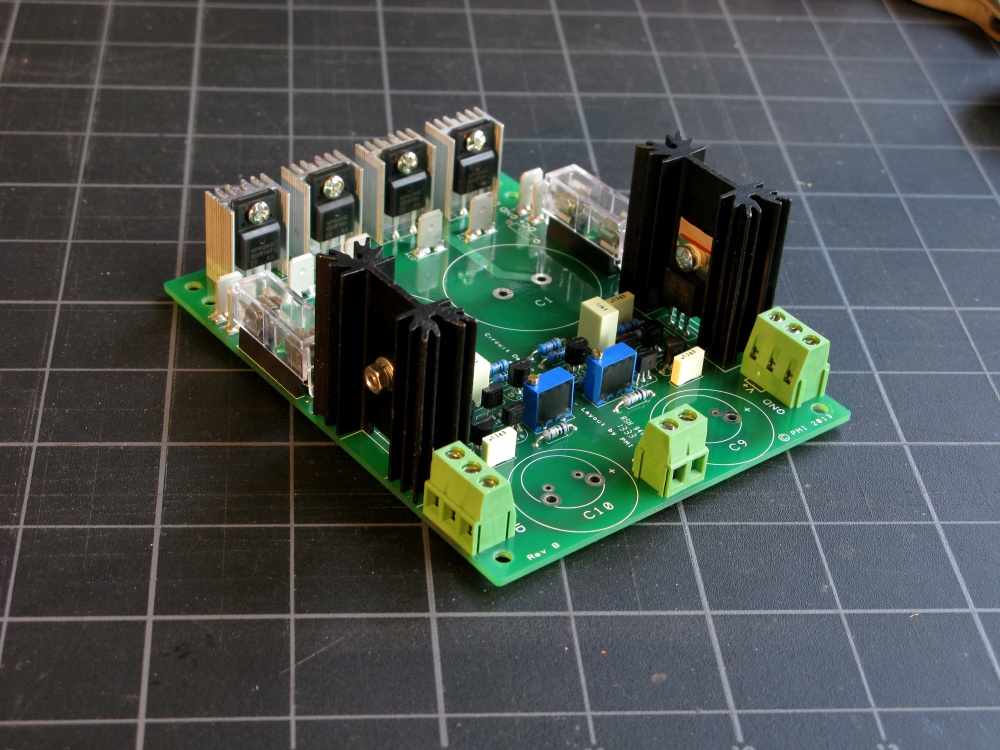

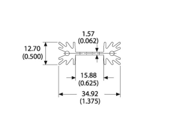

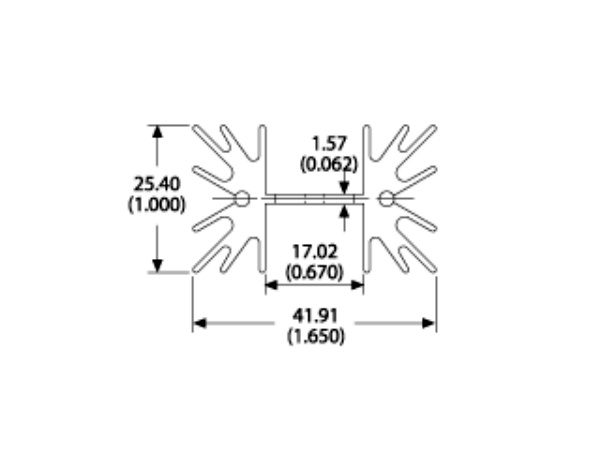

I've had a couple suggestions to make a board with room for a bigger vertical heatsink (larger footprint). Unfortunately, this will make the whole board larger by about 10~12-mm. See pics below for an illustration. Not sure if most people need (or even want) that...
The first and third pic shows the two different heatsink footprints. Both types are available in different heights. The rest are assembly pics with the current heatsink.

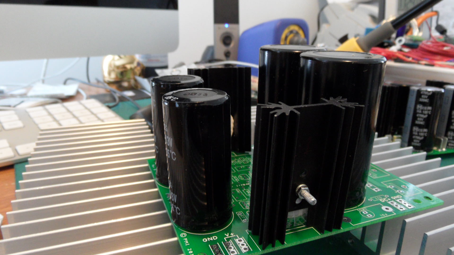

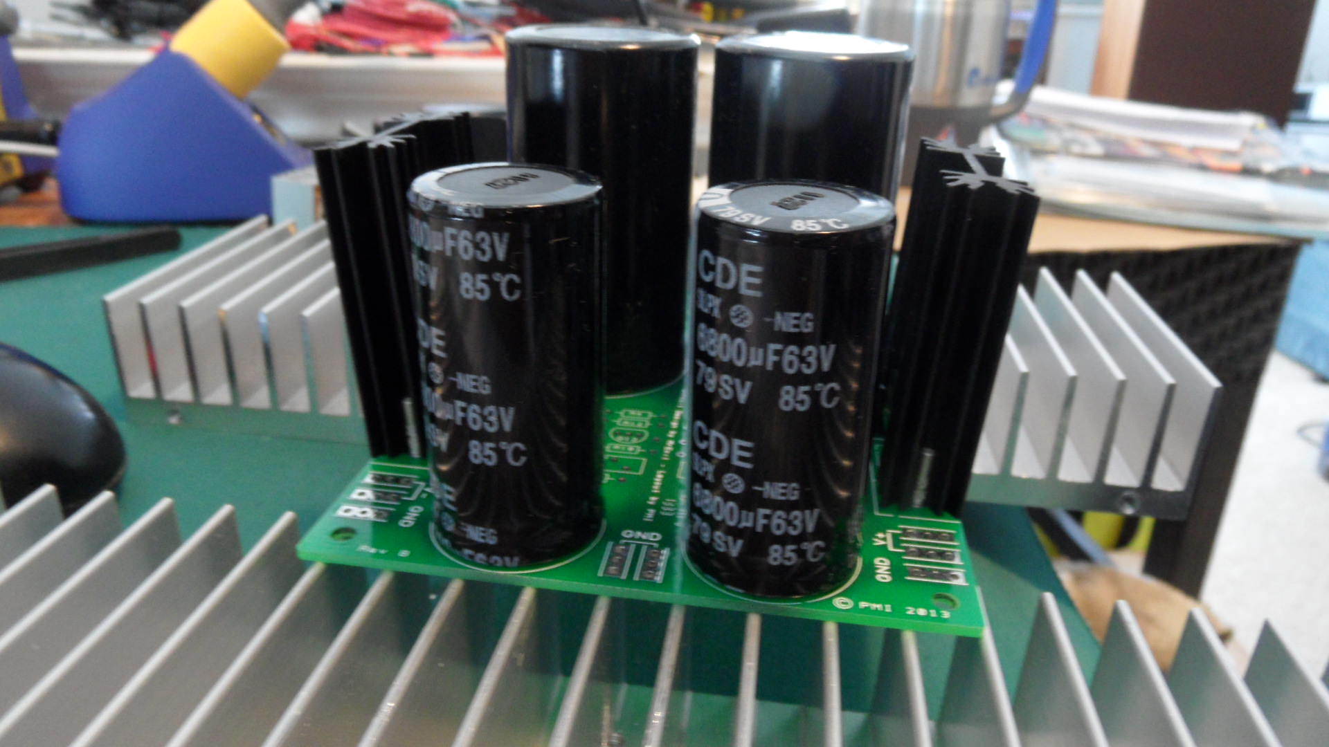

I found a slightly bigger heatsink than the ones in your photo and trimmed off the bottom edges of the fins to clear the resistor leads and fitted a 2 screw terminal block instead of the push on connector for the o/p (will change back later) - no problems, altho a bit more clearance around the 'stand-off' mounting hole would be better in any later pcb alterations but not critical thing
I'm also 'doing a number' on the 1uF film cap in the centre of the board - have some different ones and will probably need to use long leads - we'll see if it makes any difference - at present, used the Wima ones and can drop in the Siemens B32529's filter caps that I use as supply bipass caps in places, and even some SMDs![Trying that lateral thinking practice to stave off Alzheimers!]
It's just me, overdoing things again, just to see if it makes any difference at all with the amp running into class AB occasionally and drawing the extra current (up to 2.5A) and having a listen to different o/p caps and the poly cap bypass on the amp board - having a bit of fun!
As you say, it doesn't make much difference overall, and the effort is probably better spent elsewhere ...

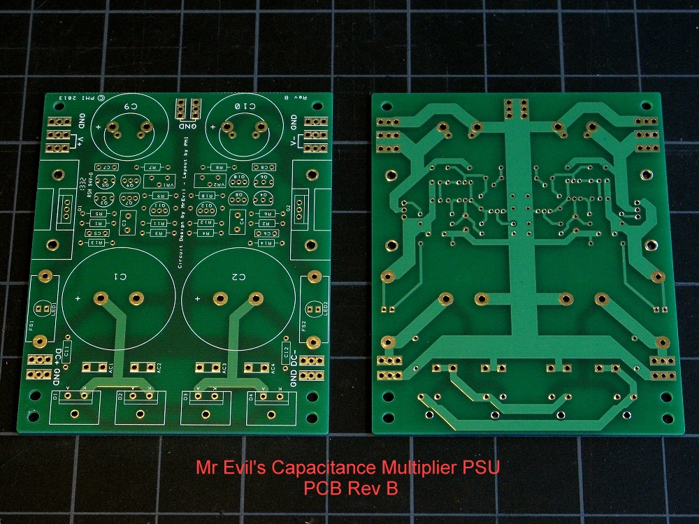

The circuit boards are production quality, double-side, plated holes, solder mask top and bottom, silk screen on top. One pic is posted below, other details are in the first post of this thread.
