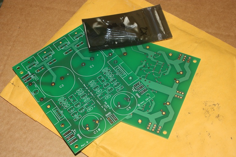

Now has my card arrived, I'm impressed this is the best packed package I have ever received by things I have bought through group buy and from other places.
Thanks PMI!
Thanks PMI!
Thanks for the compliments, and I am happy they have started to arrive, and not just one or two state borders away in the US!

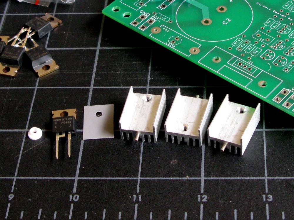

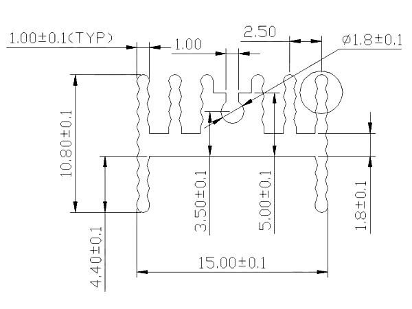

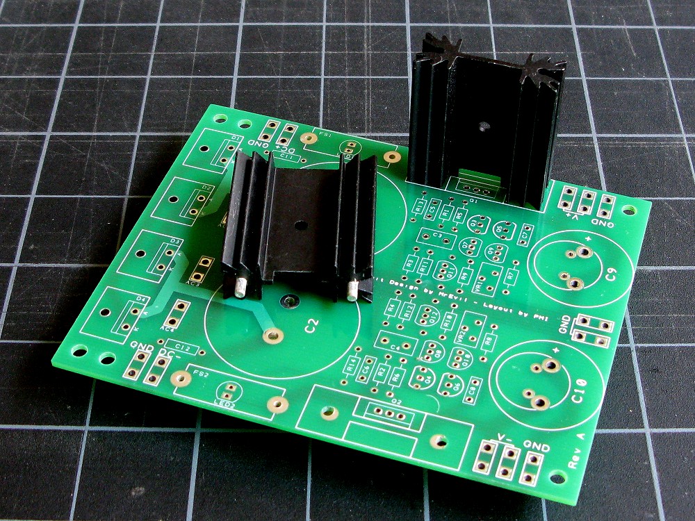

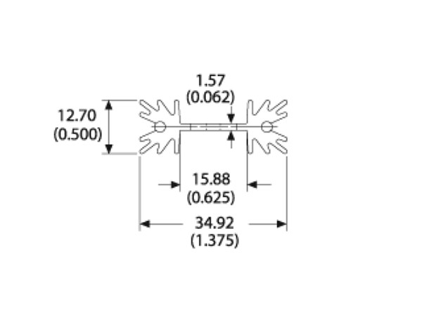

PMI, do you have a part number for the diode heatsinks? The ones in your BOM are different to the ones in your photos.
Heatsinks
The heatsinks in Post 119 came from ebay, from a seller called Goldpart. They are small extrusions, about same size as a small U-shaped channel-type heatsink. I believe they are under $0.50 each /4 pieces with free shipping, and according to my notes I paid $0.35 each, in quantity 20.
I have used three different types in testing, all about the same size and rating, with the rectifier diodes.
I have only used one type (one footprint) with the pass transistors, but there are options for those as well. I believe someone has used heatsinks salvaged from an old TV set.
In most cases, and when low cost Schottky diodes are used, the heatsinks do not have to dissipate much heat.
When using more expensive diodes with names like "Stealth", "Ultra-something", or more conventional soft turnoff diodes, the forward diode voltage drop doubles (or more) and they get hot. Couple this with a high idle current, and they could dissipate more heat than the pass transistors... It's a case where you mileage, or power, may, and definitely will, vary... 😀 )
The BOM was put together so essentially all components can be ordered at the same time from one distributor, for lower shipping cost.PMI, do you have a part number for the diode heatsinks? The ones in your BOM are different to the ones in your photos.
