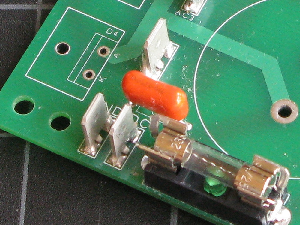

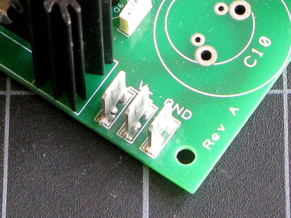

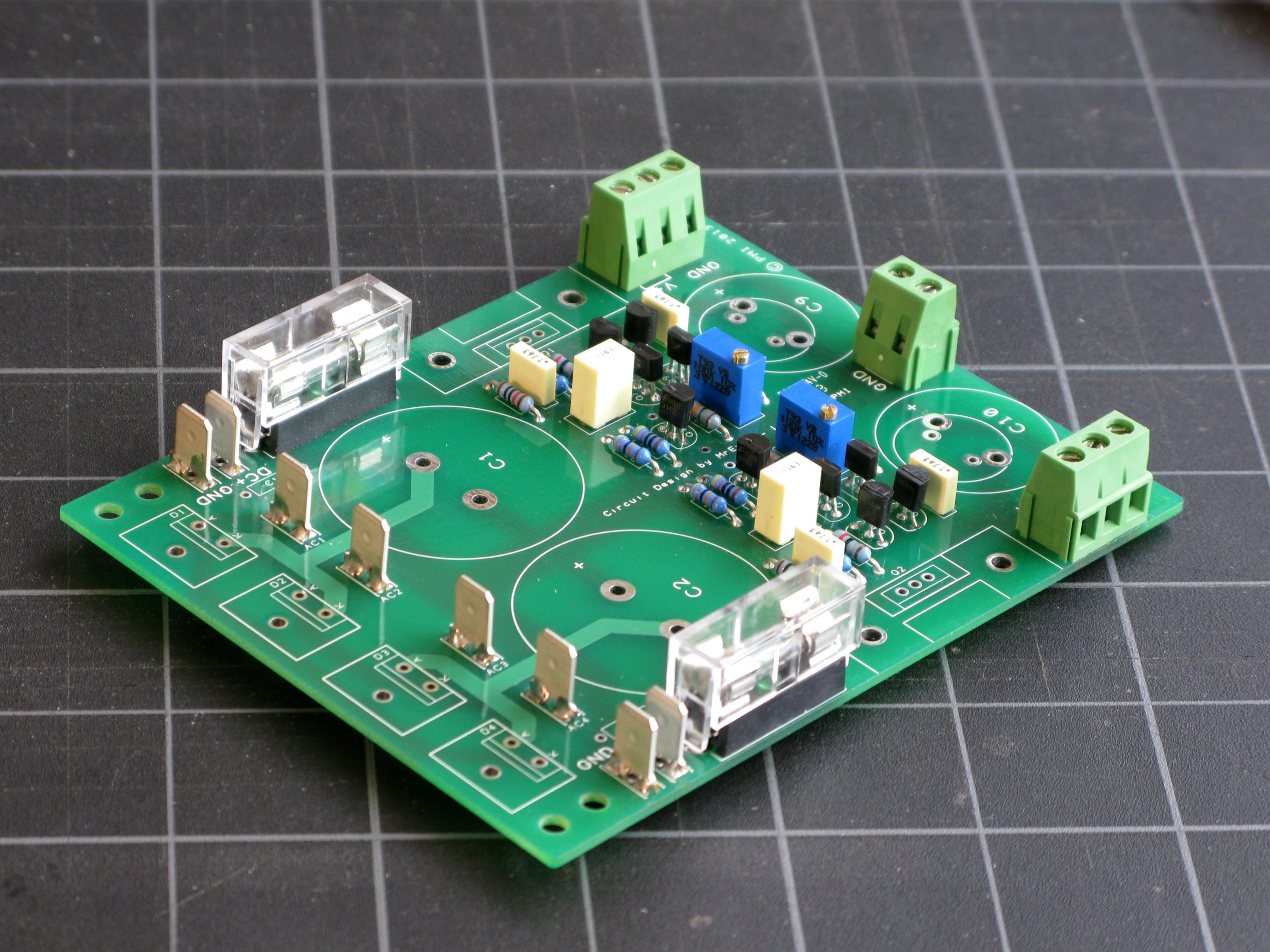

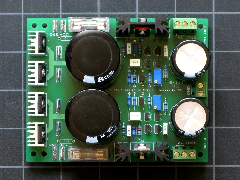

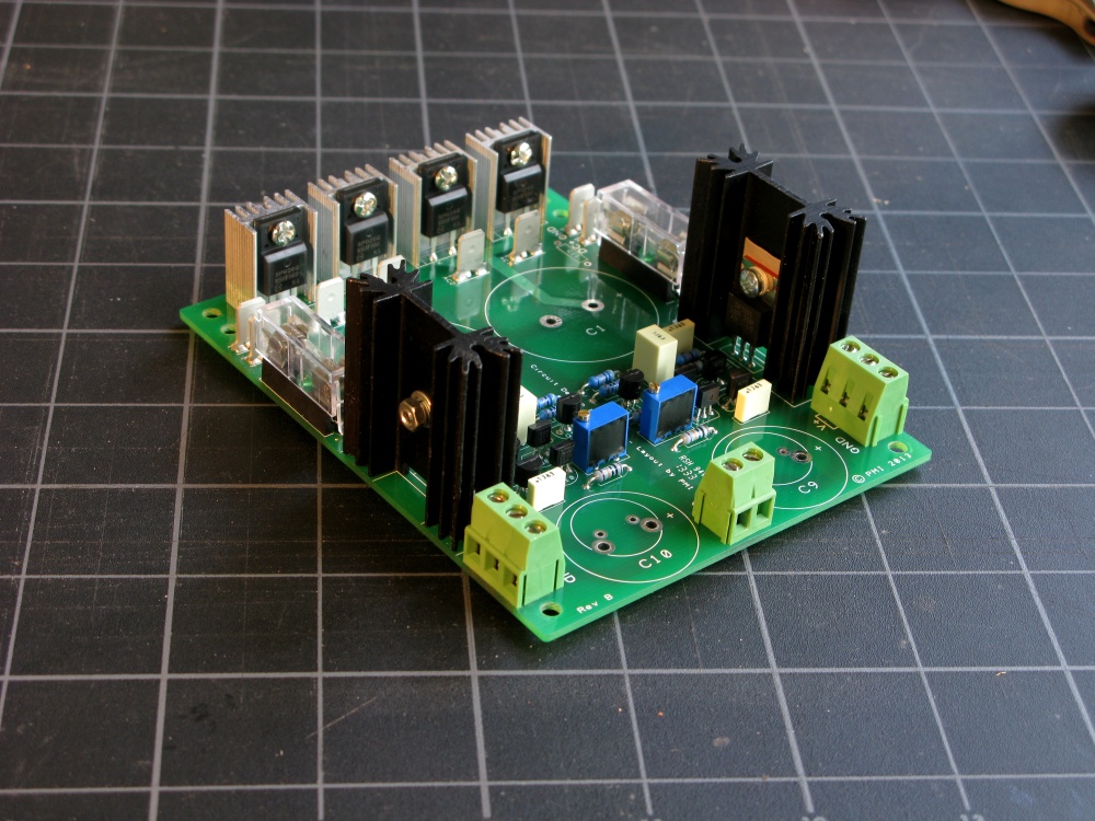

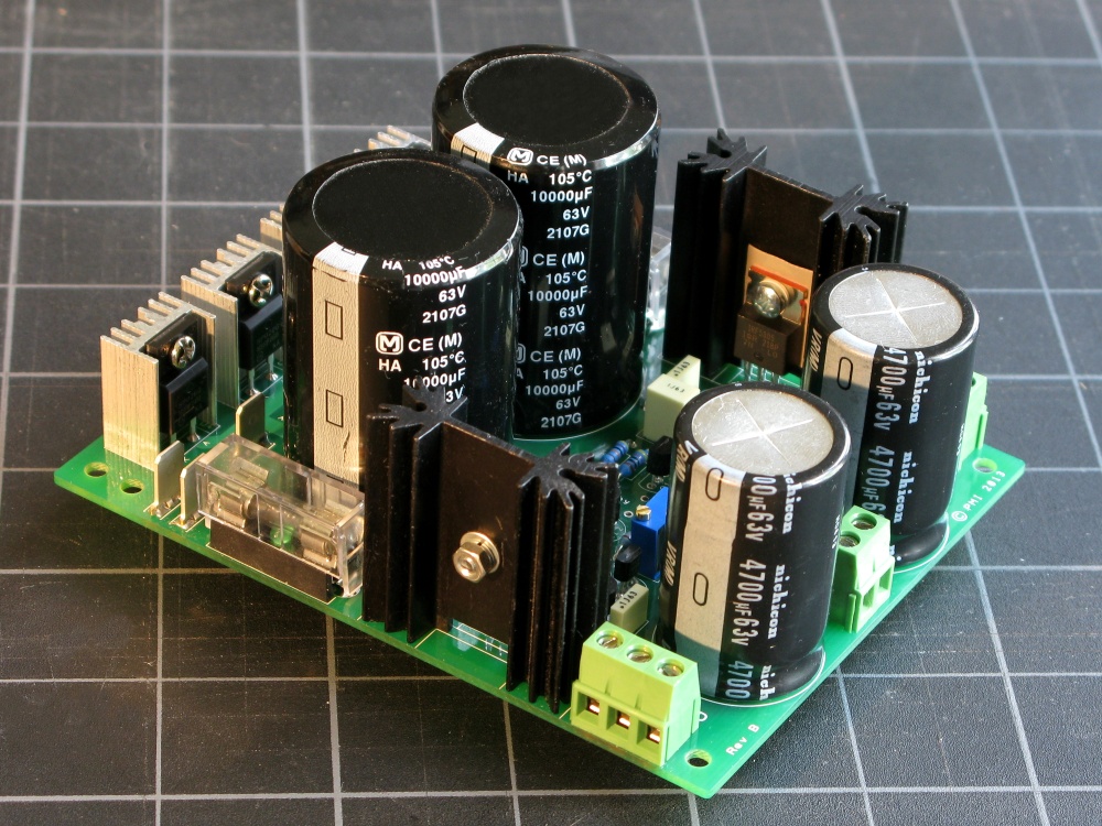

Capacitance Multiplier PCB Pics
There are pics of the prototype in the first post. I am now using that board with the through-hole version of Lazy Cat's VSSA amplifier. There are more details about that in the PeeCeeBee thread. There are also other pictures and some test results in the second one of Mr Evil's threads on the original design.
This is one of my test boards, from the last pcb order. This board has screw connectors installed instead of the Faston-type terminals to make wiring changes a bit more convenient during testing, and it uses the ON-Semi MSRF860 rectifier diodes so I can test at the maximum voltage and heatsink load.

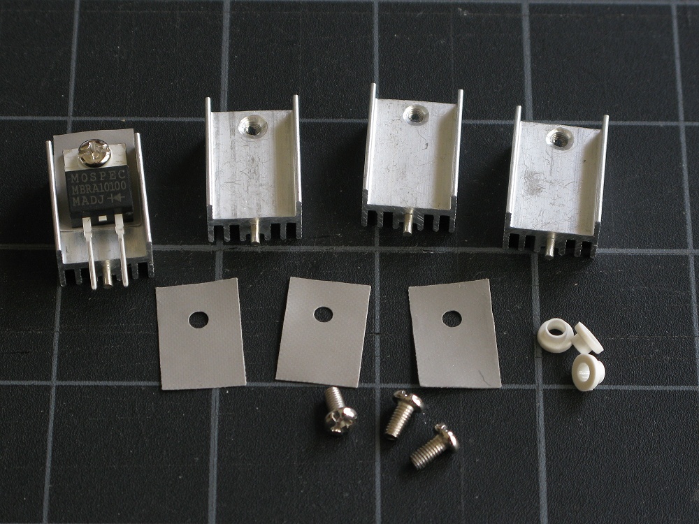

Rectifier Diodes (D1-D4):
The specified diode is MBR10100, 10A 100V max reverse voltage. Schottky diodes have very low forward voltage drops at the typical expected suply currents, but a very small U-shaped heatsink is still required, because Schottky diodes work better when cool-to-warm. (A small piece of aluminum will work just as well).
The 100V reverse voltage rating corresponds to a transformer secondary voltage of about 35V maximum, or about 32~33V rated voltage. Above this limit, a more conventional rectifier diode with higher reverse voltage should be used.

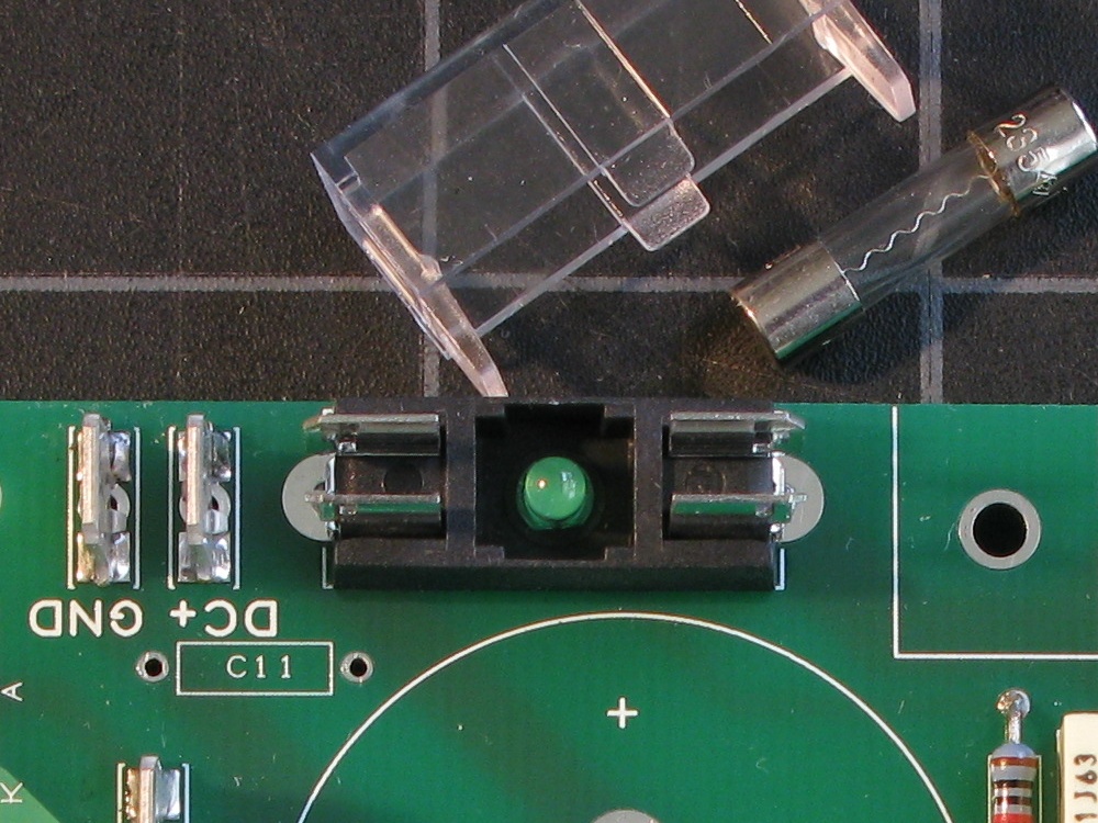

Indicator LEDs (LED1, LED2):
The LED was specified as 3-mm to fit inside the fuse holder, to save space and light up the fuses from below. (It is something I kept from Mr Evil's original design). 5-mm was never intended to fit. 3-mm LEDs are supplied with the boards. The ones shipping now are green with a clear lens, and are the "short-lens" type. However, a standard 3-mm, 20 mA LED of any color will fit.

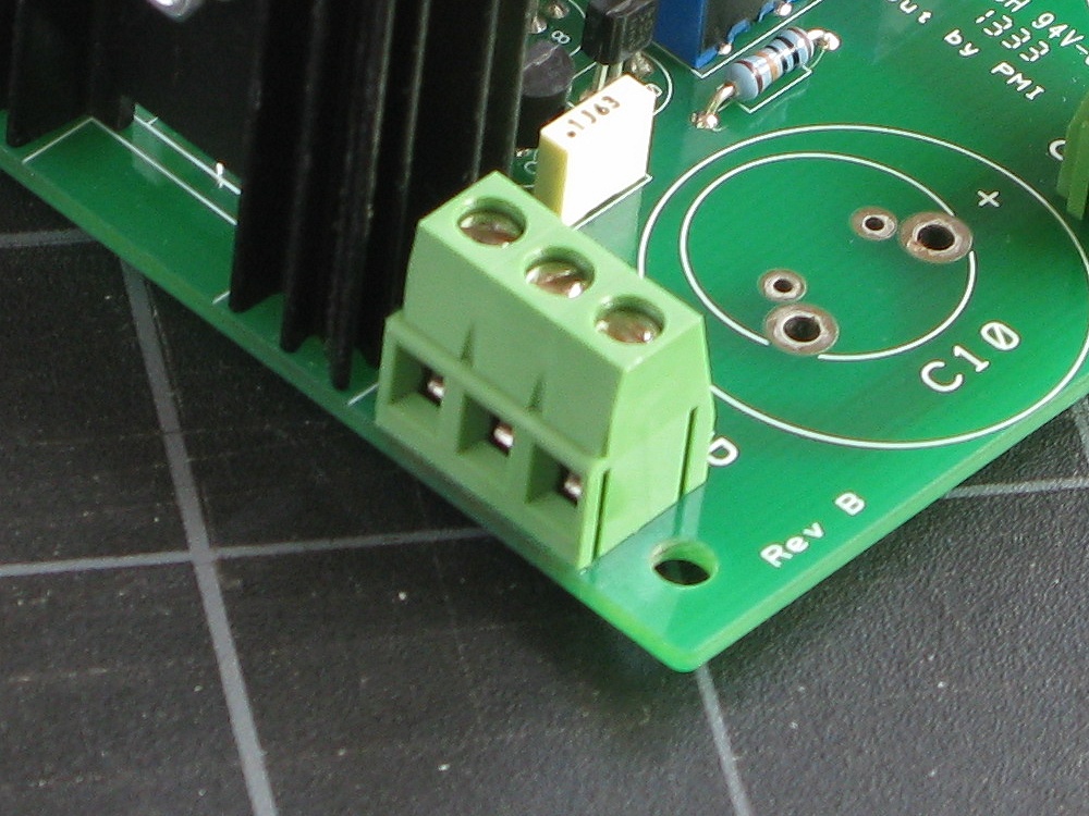

Connectors:
The pcb will accept either Faston-type connectors, or terminal blocks, 2 and 3-position, 5~5.08mm pin spacing. The only connections that require single-point Fastons are AC1-AC4, for leads from the transformer secondary windings.
There is a ground connection for every power input and output. Whether using Fastons or screw terminals, you only need to assemble those you intend to use.
Terminal Block Examples:
Newark: MC24366 and 24367
Mouser: Phoenix p/n 1935161 and 1935174

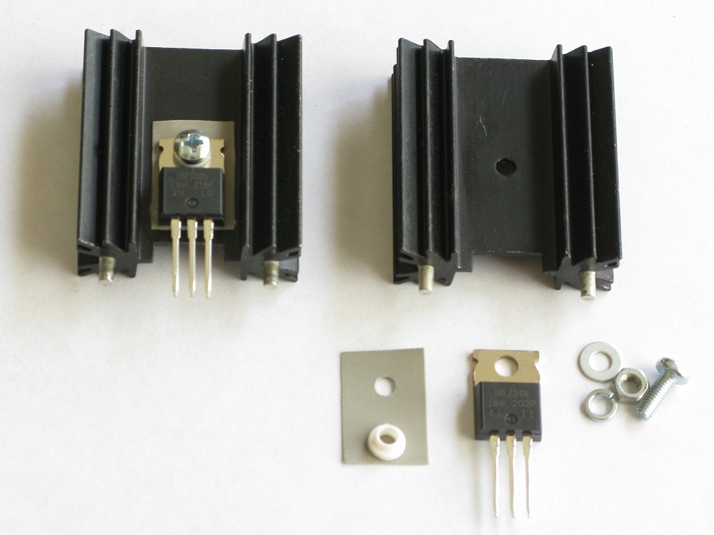

TO-220 Insulators:
Not required, but recommended, because the chance of a short to rectifier diode heatsinks, or to the pass transistor heatsink is a definite possibility when testing the supply or adjusting Vdrop. Any silicone insulator will do, because in most cases there is not a lot of heat dissipated. Mica insulators are only required if high idle currents are expected (for high-bias or Class-A amplifiers).
TO-220 Mounting Kits:
A typical mounting kit consists of a plastic shoulder washer, a 3-mm machine screw, and depending on whether the heatsink hole is threaded or not, a lock washer and 3-mm nut. Screws for tapped heatsinks should be 6-8 mm long, 8-10-mm if a nut is required.

TO-220 Insulators:
