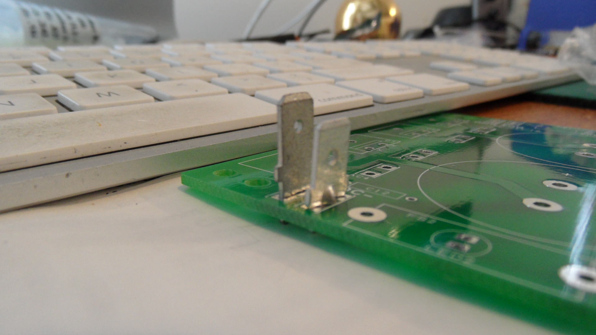

The Faston tab 1217136-1 comes in strip packaging right?it is a bit hard to separate without good sharp edged pliers,so could you change it in the main BOM to bulk packaging parts or loose piece parts?
Moreover,i ordered them from digikey who rolled up the strip very carelessly and i spent a good 45 minutes straightening out the tabs and their pins.most of the pins were a lost cause because they were bent badly.
I have lots of faston 62409-1 tabs,which dont fit(too thick legs).(bulk package)
i find 1217167-1 and 1217421-1 come as loose piece.will try these with the next order

Good point, I will look up those part numbers. You are correct, mine come on a strip, but in the past they have come on a small plastic reel, and in a padded envelope.@PMI,
The Faston tab 1217136-1 comes in strip packaging right?it is a bit hard to separate without good sharp edged pliers,so could you change it in the main BOM to bulk packaging parts or loose piece parts?...
You should be able to grasp them from the end of the strip, using pliers, one at a time, and bend back and forth until they snap off. Making a small score or scratch with any sharp tool helps.
My problem in the past has been retension in the holes while soldering. The pins are often too loose, or too tight, in theory they should be press-fit. Too tight, means hard to insert without a power tool, too loose, and they shift while soldering.

I have found that the Tabs in the VSSA BOM do Fit, Although very tightly. They are most defiantly a Press Fit on your Boards. Mouser P/N 571-725964-2. Also they came as loose pieces.
Sounds like that is a better part than the one I have on the strip then... 🙄PMI,

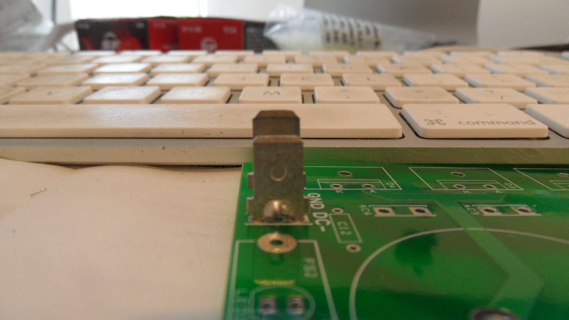

A press-fit on the TH VSSA boards, or on the Cap Multiplier boards? The legs are rectangular and tapered, so in theory at least, as they seat with the curved stops against the board, the edges of the legs should bite in, and the tab should stay in place, and straight, for soldering.
A press fit on the Cap Multi Boards. The VSSA comes with them already installed. Also as i said, they are a Very Tight Fit on the Cap Multi boards & some might not like that. Takes a lot of Finger Force to Fully Seat them.! So Maybe not so good.? Also they are a bit taller than the ones you Specified, by approx. 1/8"
Thanks for the photos Rick G.I have those parts.
I used a nipper/ Flush cutter that is used to trim component leads off to separate the remaining tabs from the strip.Does the job neatly though it sends the pieces flying which is quite dangerous to self and anyone around.does the trick and i guess everyone uses one.
You are Welcome Surajspai. I use the flat side of a pair of pliers to push my tabs fully onto the board, so my fingers will last!
